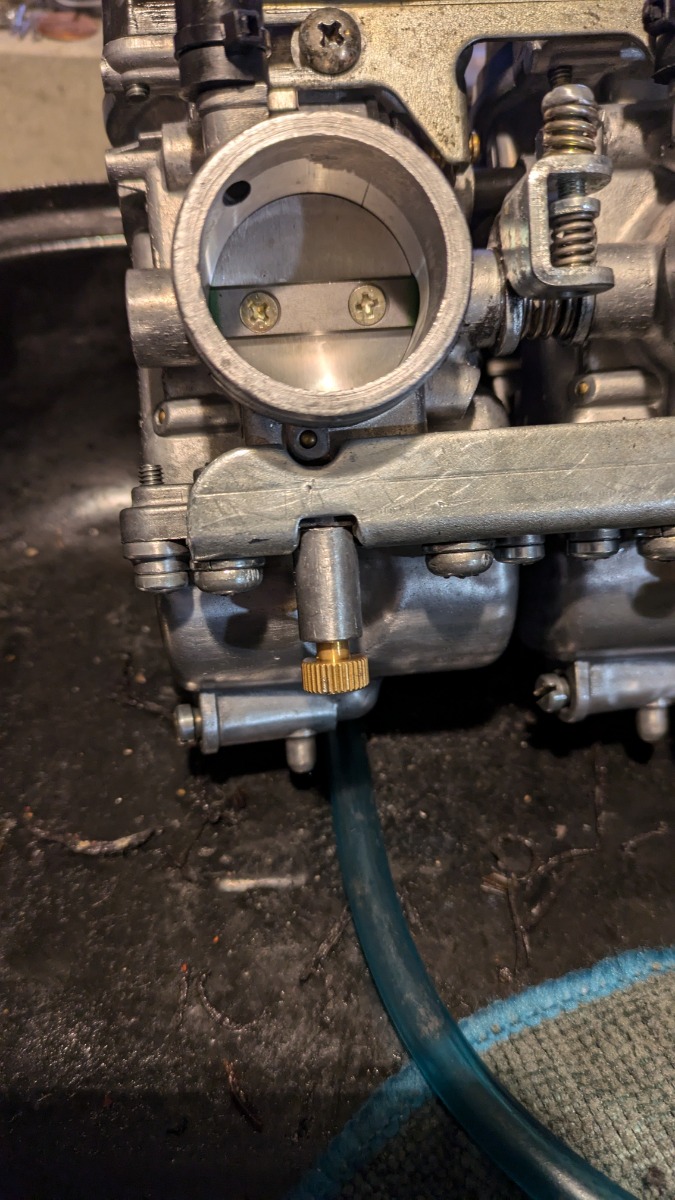

And I am finally back... After a lot of waiting for parts and personal stuff going on, I finally managed last week to put my hands back on the bike. I replaced the chain tensioner (which I found out was broken inside, kinda like I was when I found out....) and the pilot screws with some compatible thumb screws I found on the net. In the end all the issues were caused exactly by a misregulation of the pilot screws..
Basically the Haynes manual states that these should be set to 2,5 turns out max. So I did. And I was wrong. A mechanic I met, who has the same bike, told me to set them to 1 3/4 turns out. Lo and behold, after some sputtering the bike started fine and held the idle speed.
The only issue now is that when blipping the throttle, the RPMs stay high. So another carb cleaning was de (my tenth...) and now I am about to reinstall the carbs on the bike.
Will keep you posted.

Most of the time, a hanging idle is because of a vacuum leak. Most common offender is the rubber carb boots that bolt to the head. Remove them and flex, looking for cracks. Or just replace them, if still available. Rubber parts are short for the world after 40+ years.

A carb sync is nessesary and I know from experience that the carb rubber boots are the source of your trouble. The stock jet setup is also very lean (idle and main jets), so any little air leak can cause probs like yours.
