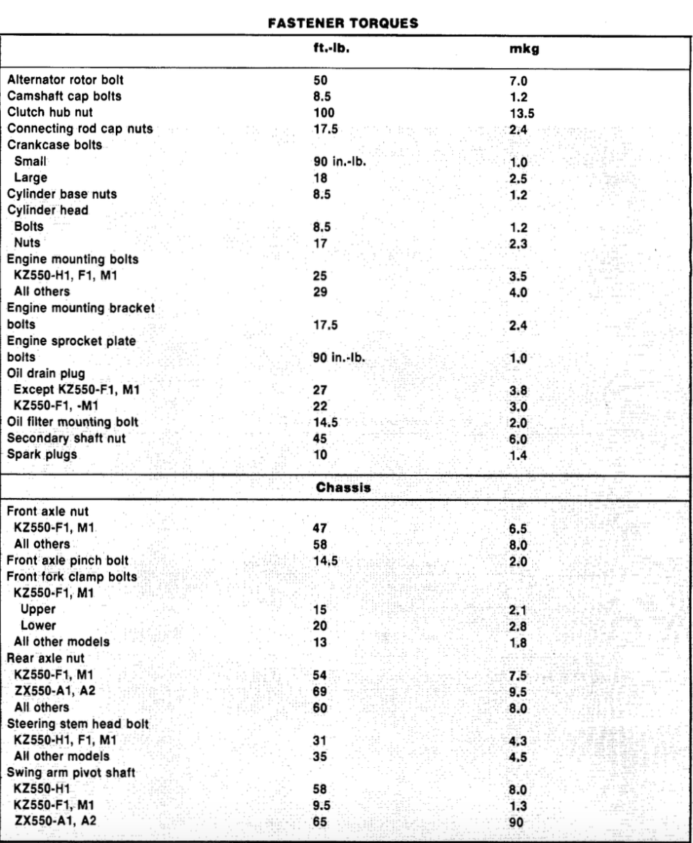

Hello forum. First time poster here. I have an 83’ KZ550 for restoration/ modernization and am currently on reassembly. I have the Clymer manual and on the torque spec page there are 18 different torque values. Seems like a pretty low amount to me, especially for how many one-off bolts/nuts there are. (But maybe that’s just me, this is my first time working on a vehicle after all) Are there any other resources that have more detailed specs for torque settings? Or if anyone can tell me at least the value for part #92015. Thanks.

The attached torque values come from the Kawasaki manual for the KZ500/550 models from 1979 to 1985. I think you are asking about the nut on the front axle. Looks to be two values, but the main one is 58 ft-lb.
