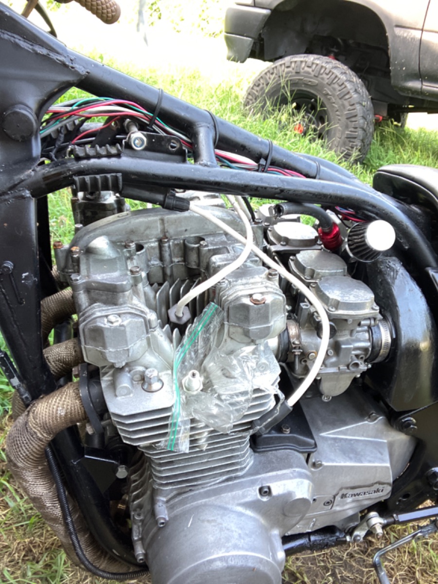

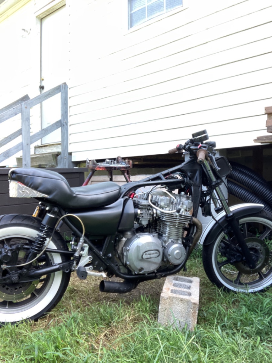

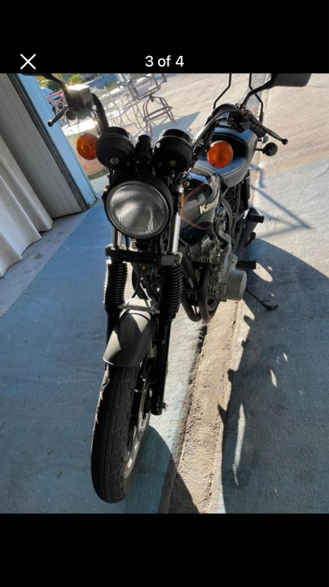

Gentlemen, first post here, this post will be hopefully the beginning to an end for me to get a complete grip of exactly what engine parts I have. Avidly have came to this sight to find some very detailed answers to questions ever since I got my first kaw(440 bobber in 2018) I have since purchased a 1981 kz1000 LTD (title states this) now I know this is the j engine due to the bottom case stamp of KZTOOJ***** but I have accumulated one and a half trannys, a hair line fractured bottom case, a engine collision top end with broke guide and torch'd then bent back in place valve.. holds 120psi 😂. I want to take the Frankenstein old broke sheit and make good sheit (big bore nothing crazy) Now we know I have j bottom case, but my key says GPZ? Is this common? My valve cover has bolts dead center both at front and back, I have no idler pulley, my cam chain I have to count 44pins for timing, is this a standard j engine? And if so what's the difference in mk11? Can a j engine simotaneously be a J and MKII? I know this has been ran into the ground but I have countless hours of read time, I due my due diligence but after 7 years of wrenching I can't find my answer

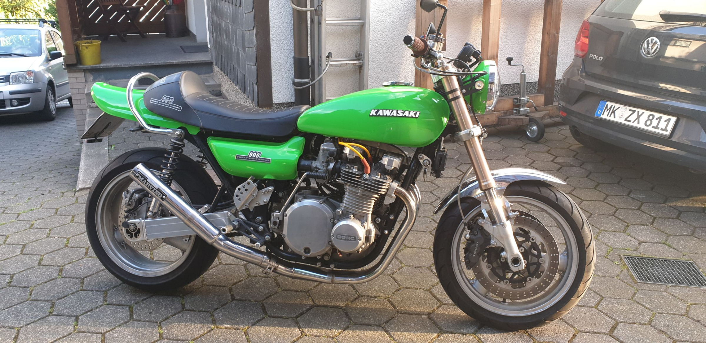

The MKII was a development of the earlier Z/KZ 900 and 1000. All of them use a roller cam chain. The later J series head can be modified to fit the earlier cam chain system, but based on your picture that is not what you have.
The J series engines, used from 1981 to 2005, used a Hy-Vo, or silent, cam chain that is incompatible with the earlier chain and sprocket setup. I am not sure it is even possible to convert an earlier head to use that chain, as I do not think there is a way to install the upper rubbing block.
The bike in your pictures appears to have a J model engine.

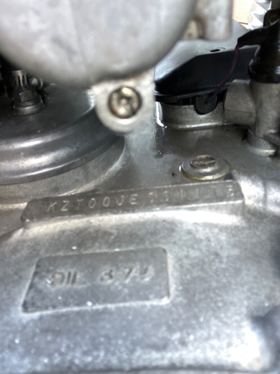

Mmmkay mmmmkay, only one more I hope, do both the gpz1100 and kz1000j have the .998 stamp on jugs..?

12 Aug 2024 10:50998 is the capacity 998cc - the GPZ is either 1086 or 1088 (can't remember)Mmmkay mmmmkay, only one more I hope, do both the gpz1100 and kz1000j have the .998 stamp on jugs..?

12 Aug 2024 11:29No! The 1000 has 998 and the 1100 has 1089.Mmmkay mmmmkay, only one more I hope, do both the gpz1100 and kz1000j have the .998 stamp on jugs..?
Both of which denotes the actual cubic capacity of the stock motors.

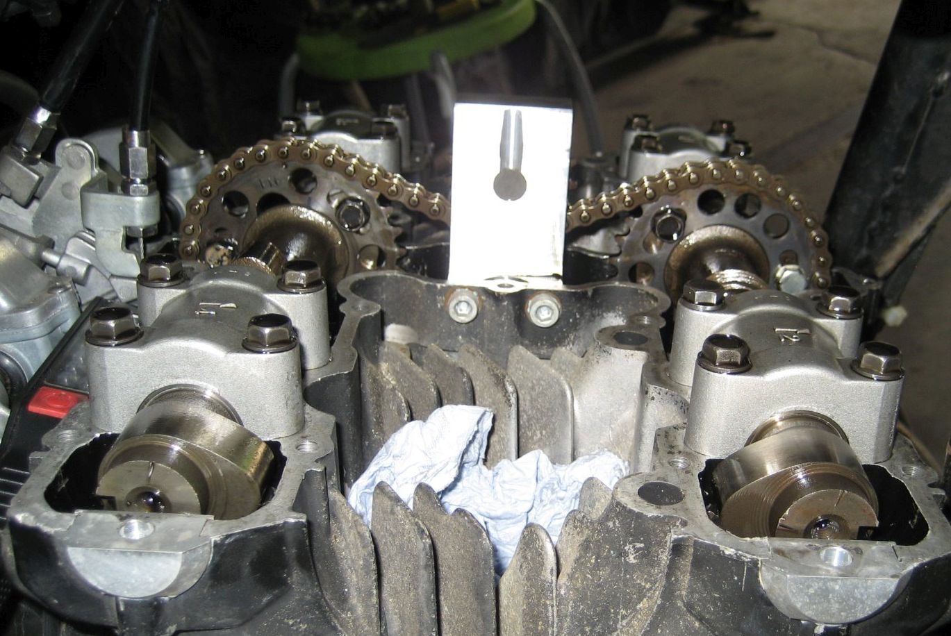

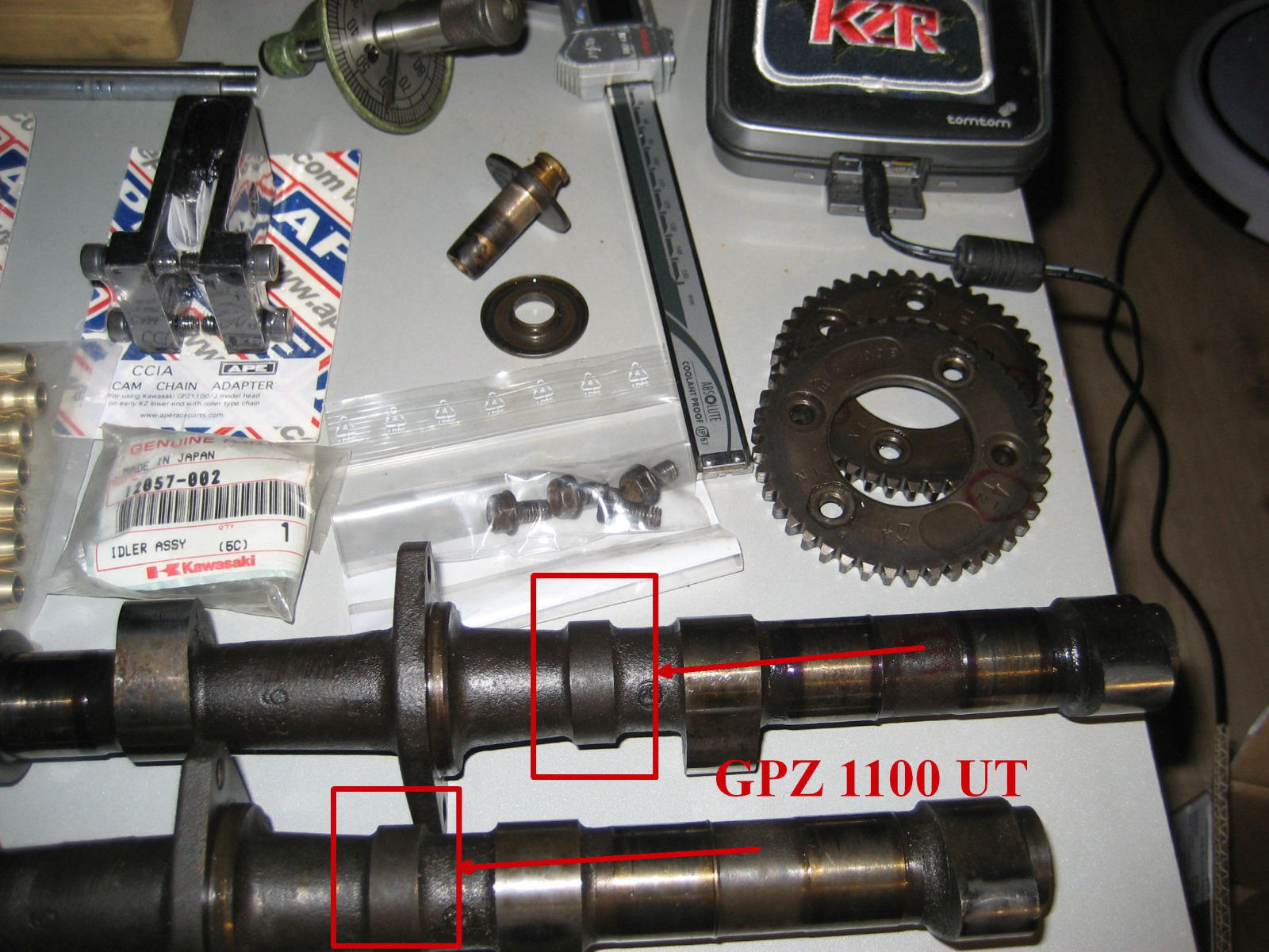

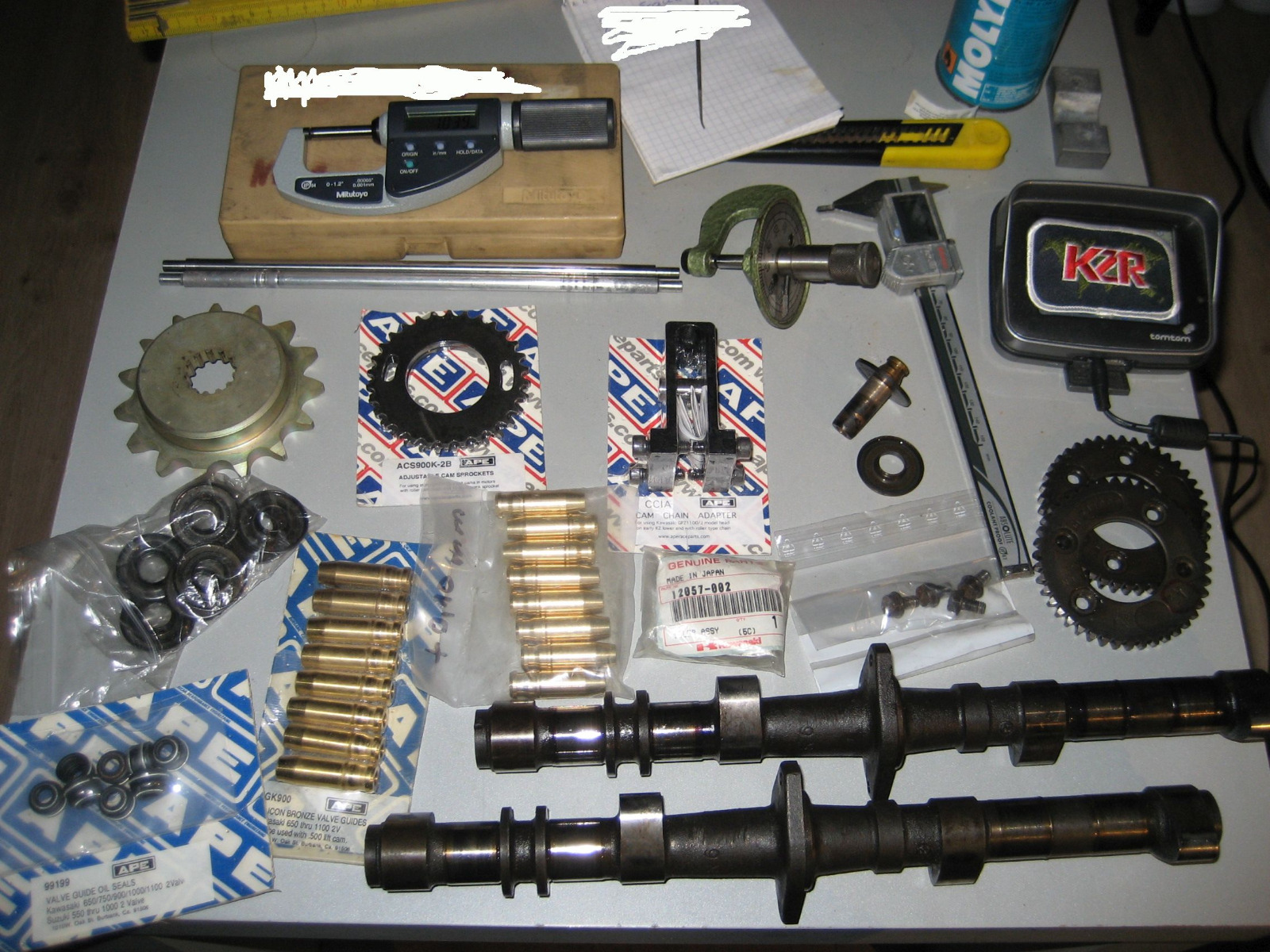

To totally confusing you, my engine is a Z1 low end engine (roller cam chain) and a Z1000J (HYVO cam chain) top end cyl. head.
See the CCIA (cam chain idler adapter) between the IN and EX cam shafts.
This picture shows a GPZ 1100 UT (ZX1100A) cyl. head and cam shaft (HYVO chain) to Z1/KZ1000 roller chain low end conversion kit parts.
