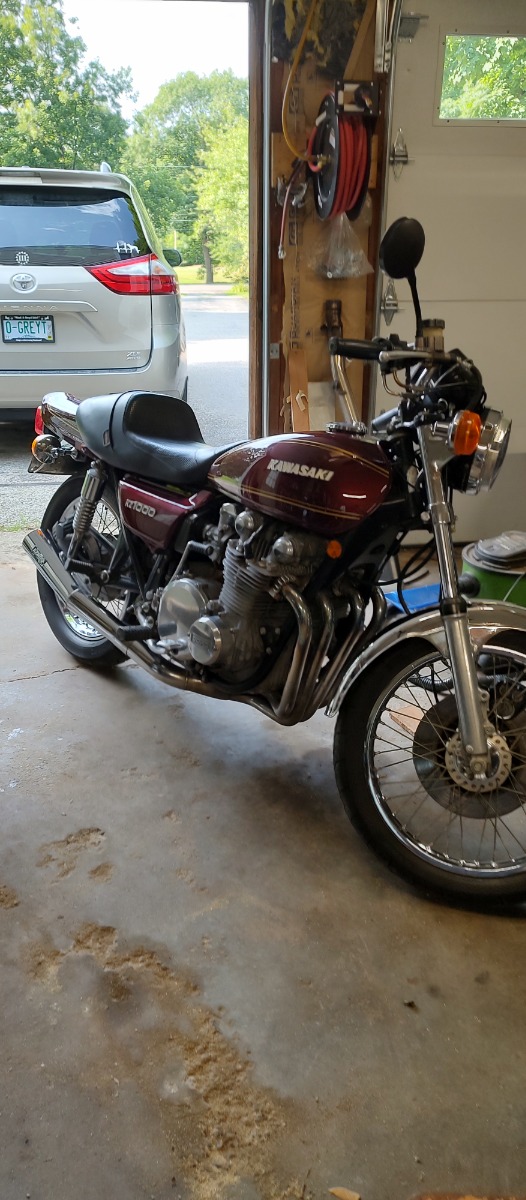

Hi new here recently acquired a 77 kz1000 used to have one in the day. Wondering what wheels would fit,and the difficulty of going to dual disc

Looks like the RH fork leg already has the lugs to bolt on a caliper. That should make it easier...
Wheels are likely available on eBay, or, better, maybe someone here has a set they will sell?
With a dual disc front end, you need a 5/8" bore master cylinder.

You don´t need to search for an other wheel, you already have the right wheel!
Remove the cone shaped chrome cap on the front wheel hub.
There you will find the prepared mounting threads for the second brake disc

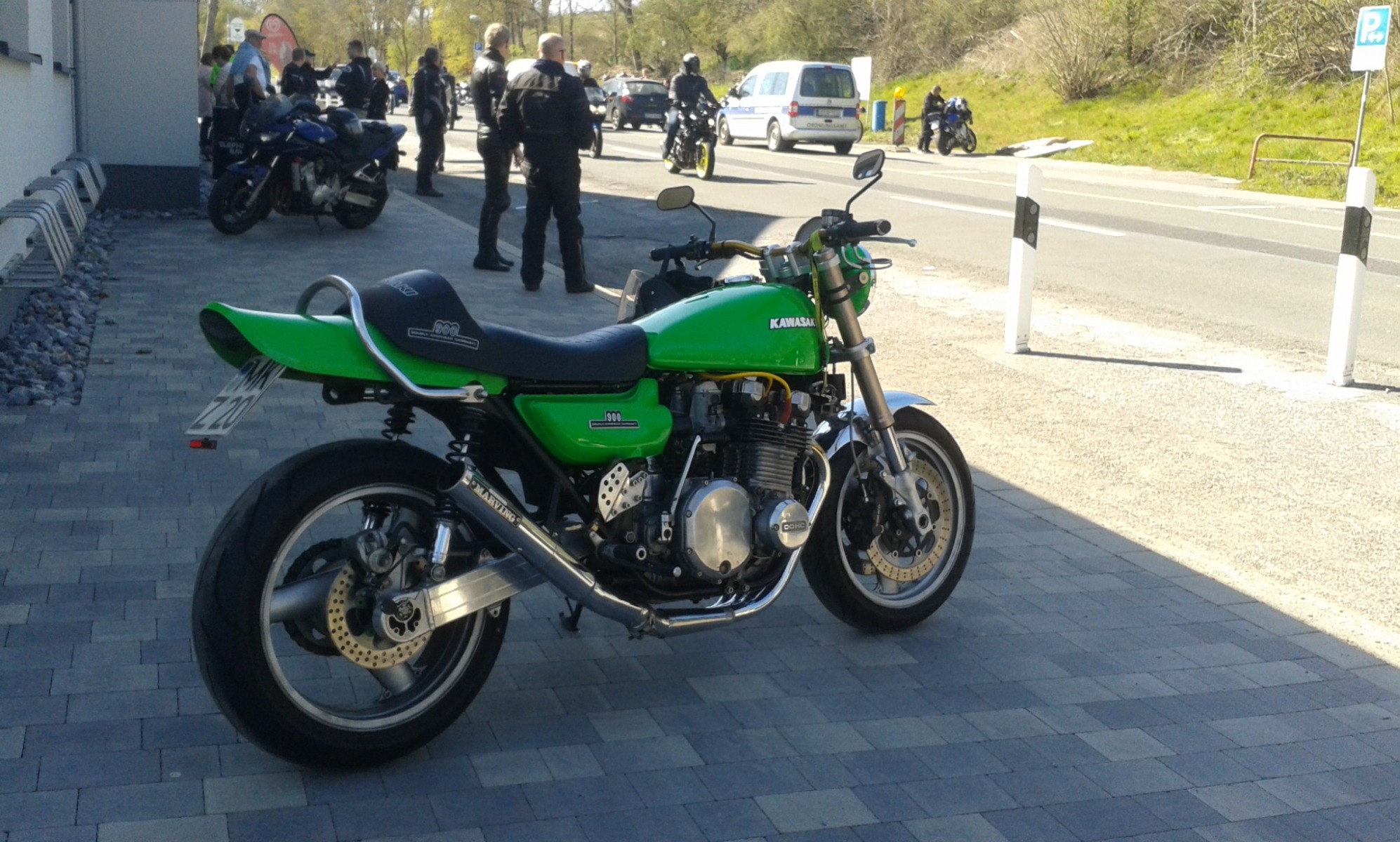

You need a 5/8 MC but yours will do the same job if you bleeded the system correct.
I use my stock Z1B MC with dual 6 piston Tokico caliper with no problems
Early Z1 bikes have six,later Z1A/Z1B/KZ900/1000 have only four break disk mounting threads.
