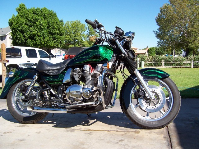

- Posts: 8405
Re: 1993 KZ1000 Police Aftermarket Exhaust
17 Jul 2024 07:03
I don’t think I have ever seen an off the shelf solution. The problem with the KZ1000P (1982-2005) is the floor board mounts. Any header for the KZ900, 1000, 1100 will fit the P bikes, except possibly the V&H and Star sidewinders. You will need a mid pipe that avoids the floor board and does not cause the muffler to interfere with it, either. You will also need to fabricate a muffler mount of some sort.
If the factory header pipes are ok, you can buy some aftermarket mufflers and have them welded on.
- Posts: 8405
17 Jul 2024 07:15

17 Jul 2024 08:01
Thank you Arogone 79 and TexasKZ For your responses and the picture. I ordered the Delkevic system and it just arrived. The guy helping me with my bike is going to try to install it this week, but I’m not feeling super confident. Will circle back in with any results. Fingers crossed.
