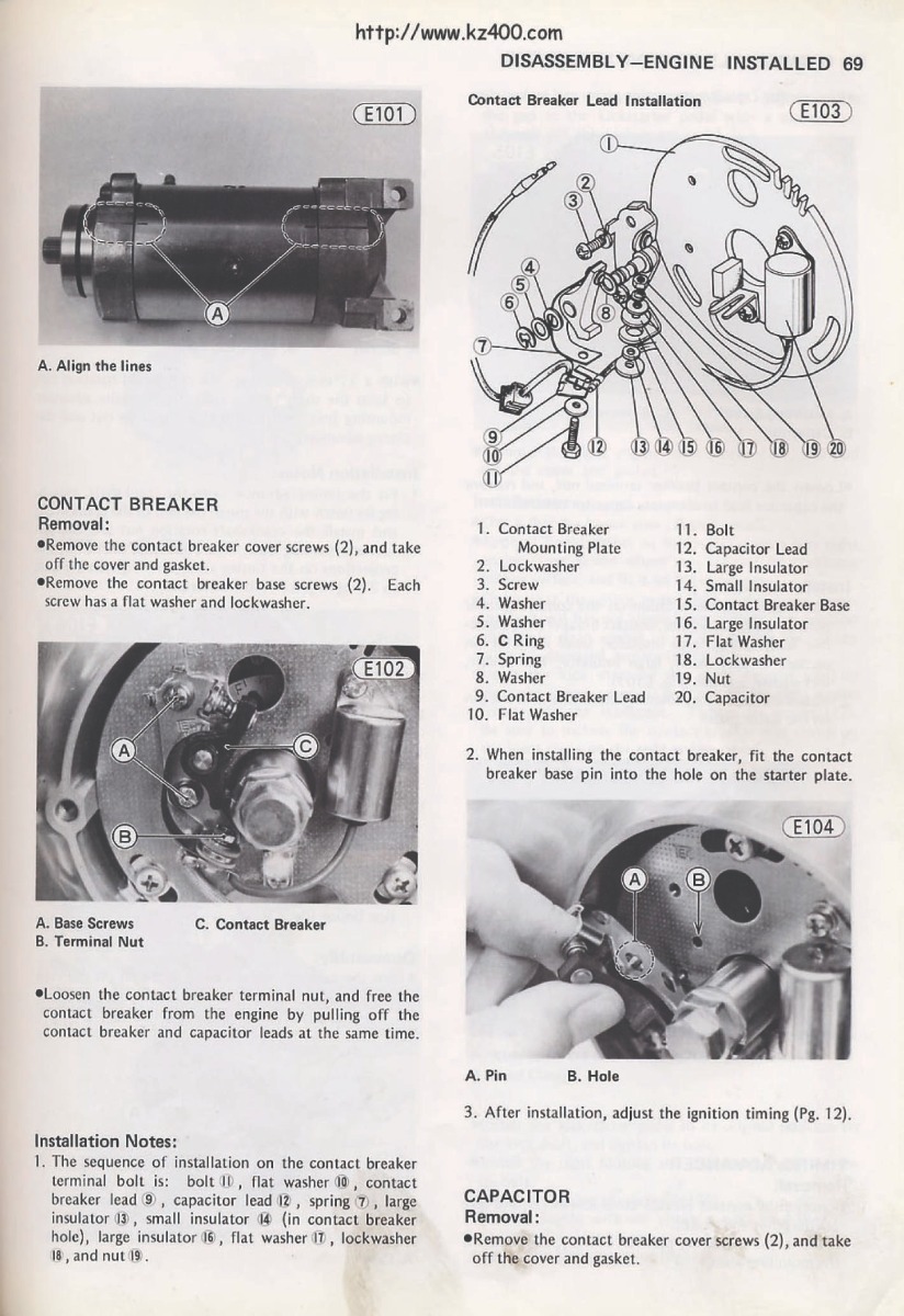

Here is a page from a 78 -81 manual for the kz400 showing points and how to to install the washers and insulators

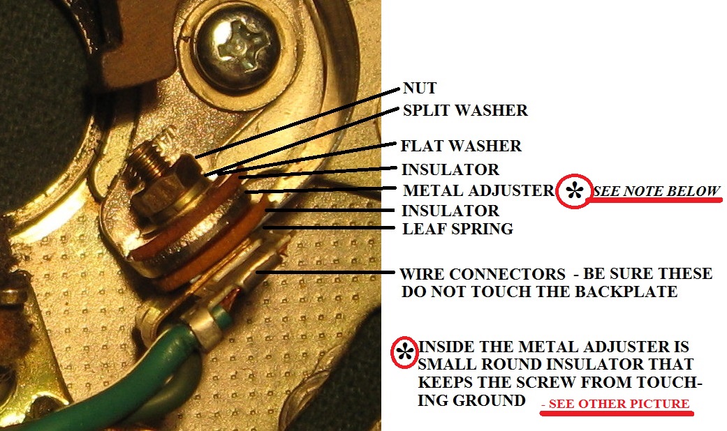

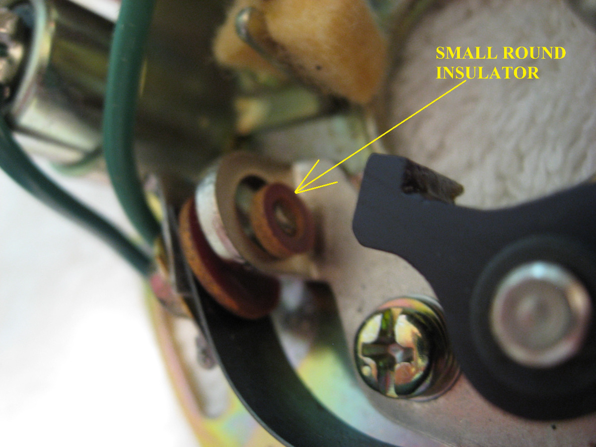

Re: Intermittent spark
24 Jun 2024 15:31
