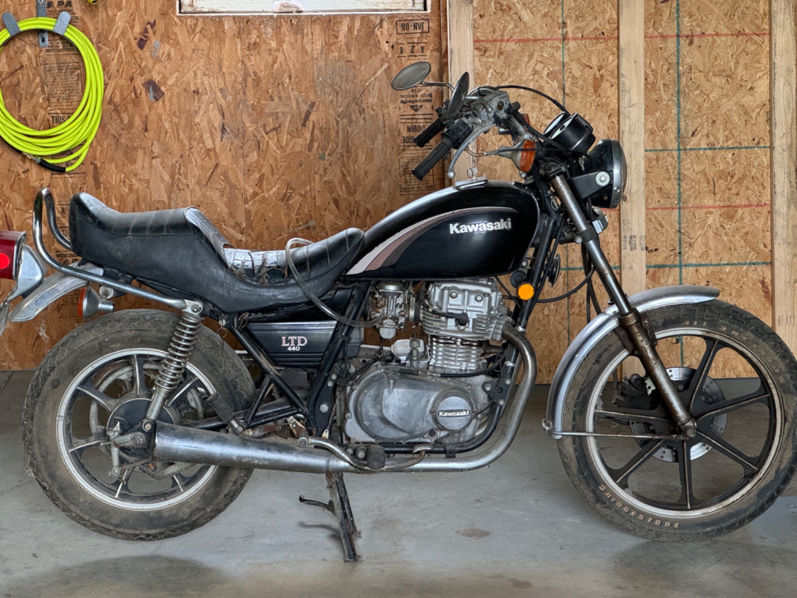

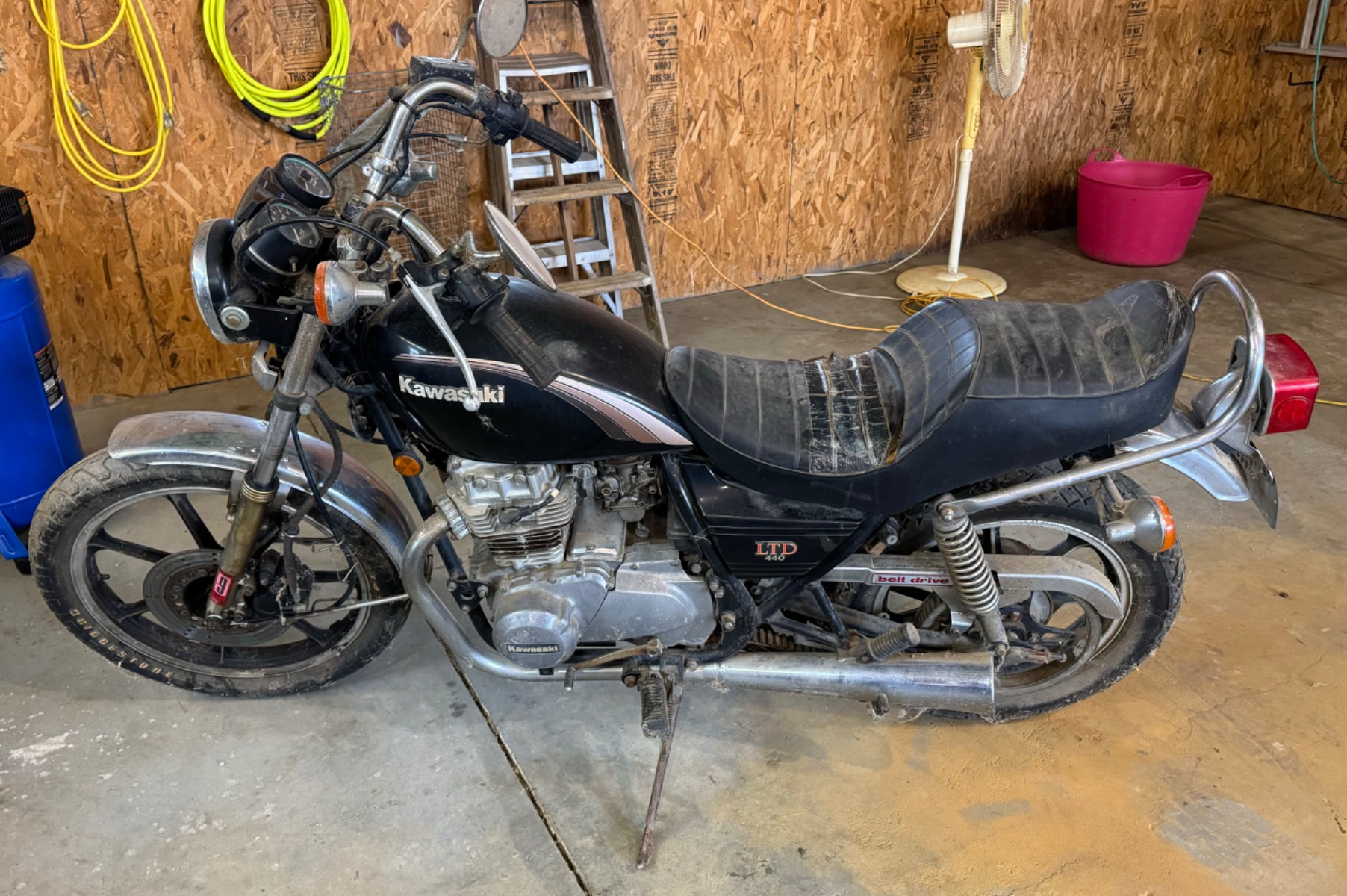

Hi, I’m planning on restoring my late grandfather’s 83 kz440 ltd as my first motorcycle and have found myself reading a lot of this forum while doing research so I figured I’d join. It was last registered in 2009 so it’s been a while since it’s been used on the road, only 8500 miles on it. It’s currently in a different state so I haven’t had much time to work on it and haven’t even tried starting it. Lots of minor things to fix, stuck clutch, bent handle bars, rear left signal is out, and a missing battery. Next time I’m up there I’m going to change the oil and actually try to start it. Planning to keep it pretty much stock with a few exceptions like straighter handle bars instead of the mini apes, probably saddle bags, and maybe LED lights.

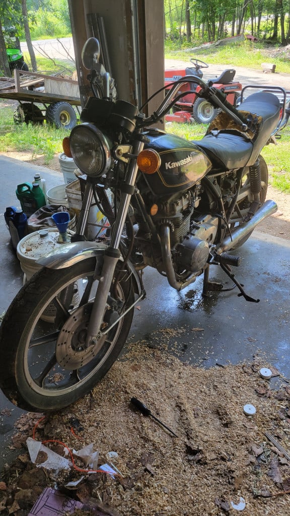

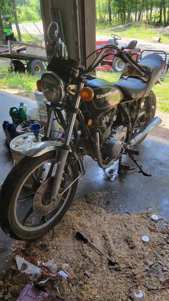

Looks a lot like th1980 I just rescued .... I also replace handle bars .... don't like the high bars, master cylinder took a little tweaking to work on straighter bars.... quality seat cover available on eBay and not expensive... carbs will probably need a cleaning at some point... they come off very easily.... be a good idea to dump and clean tank before you start... like you say oil change is a good idea...
Mine was in pieces when I got ... here is pic shortly after I got it running for the first time

I think I like the hight of the stock bars, I just think the wrist angle would be uncomfortable and since they need to be replaced anyways. I was planning on draining and cleaning the tank, but I am also tempted to just pull of the tank and make a temp tank out of a bottle to get it running and clean the tank at a later date. Stuff like the tank, carbs, and seat might get brought back home to Florida with me to work on instead of just working on the bike when I am up north.
