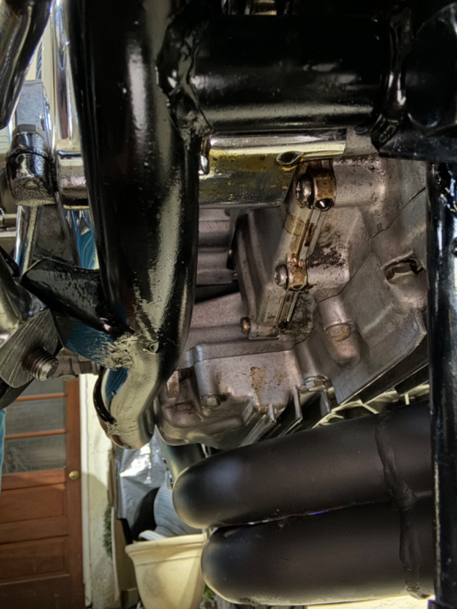

Hi everyone, new kz1000 owner so I’m excited to join the community. I have a small oil leak in front of my center stand that is starting to get annoying and was wondering if anyone could help me identify the issue and let me know how hard it is to fix. Any feedback is greatly appreciated!

I would guess the oil is coming from behind the sprocket . . Take the outer cover off and have a peak

Okay thanks I’ll remember that for next time, I took the cover off and I think you’re right it’s really dirty behind here. Can I just clean the sprocket and inside of the cover with brake clean and relube the chain? Or is there a different way to clean it up

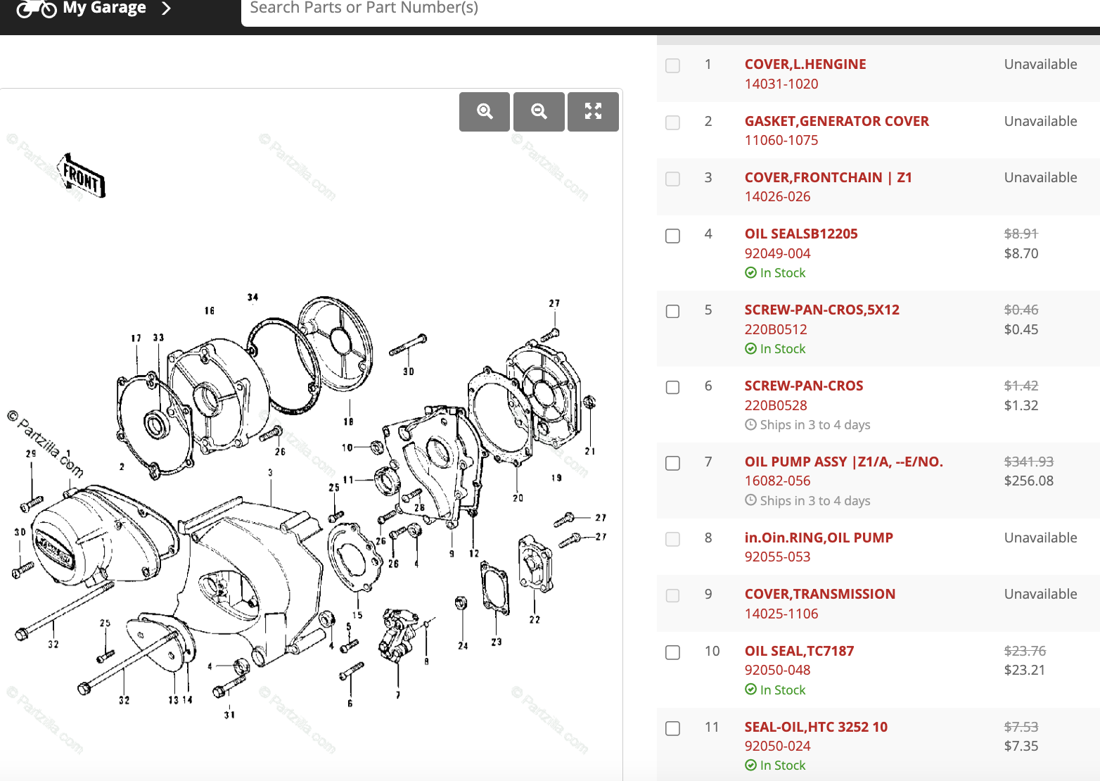

It looks like the drip is coming from higher up. My guess would be one of the seals (not the gasket) in the transmission cover is worn enough to leak a bit. You can see the seals in this screenshot. #4, 10 & 11. Most likely #4.

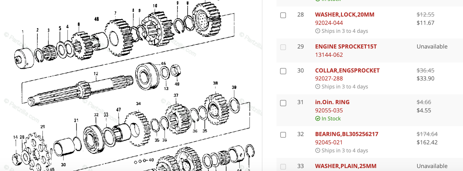

There is also an O ring seal on the out put shaft and it might be the culprit. #31 in the second screen shot.
