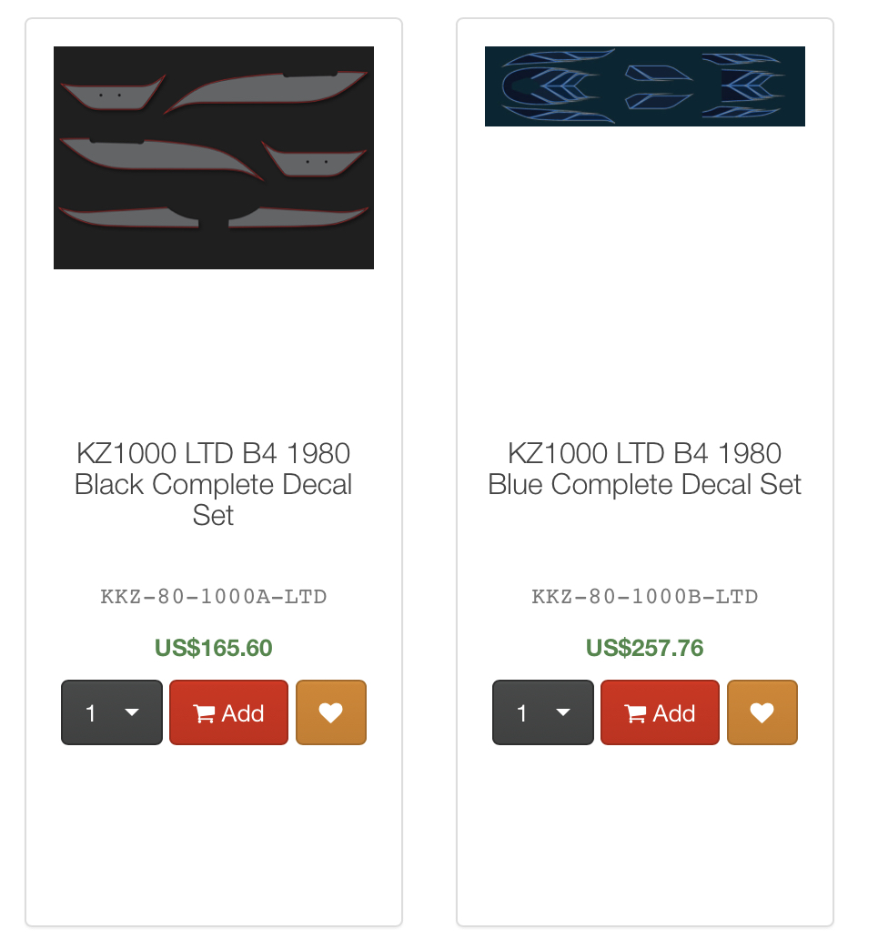

There is no true “decoding” the vin. Unlike an auto code telling you color, engine, type information. The KHI vin basically identifies the bike model and production number.
Kz = model
T = unknown
00 = 1015 CC (1000)
B = LTD, identifying mag wheels, pull back style of handle bars, and stepped seat.
533041 = production number. That production model started with 523544, and ended with last bike being 535555.
So your bike it a 1980 Kz1000 B4 built approximately April/May of 1980. A build date should be on a white sticker on the steering head tube. Like I said I’d guess 4 or 5 of 80 (4 80 or 5 80)
These decal sets will help you Identify what color you bike was either Ebony or Sundance blue.
