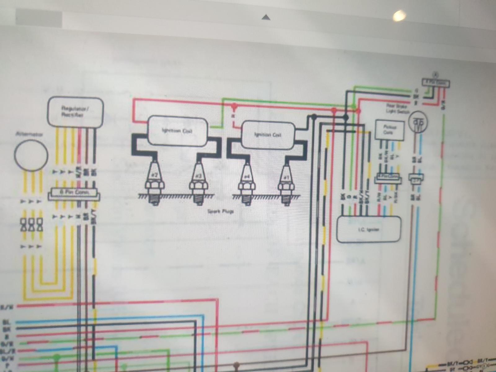

Thanks for the wiring diagram, i fitted the carbs and unhooked the 4 pin connector to the Efi and removed them. I just need to know which wire i need to earth to the frame? Ive attached a pic of the wiring diagram for an 84 model

09 Feb 2024 06:27I think Howards "terminology" is confusing you, from what I can see there is no "wiring" involved. I believe Howard is referring to the mechanical mounting of the igniter to ensure sufficient heat transfer from the igniter into the frame so the unit doesn't overheat.Thanks for the wiring diagram, i fitted the carbs and unhooked the 4 pin connector to the Efi and removed them. I just need to know which wire i need to earth to the frame?

10 Feb 2024 00:32
