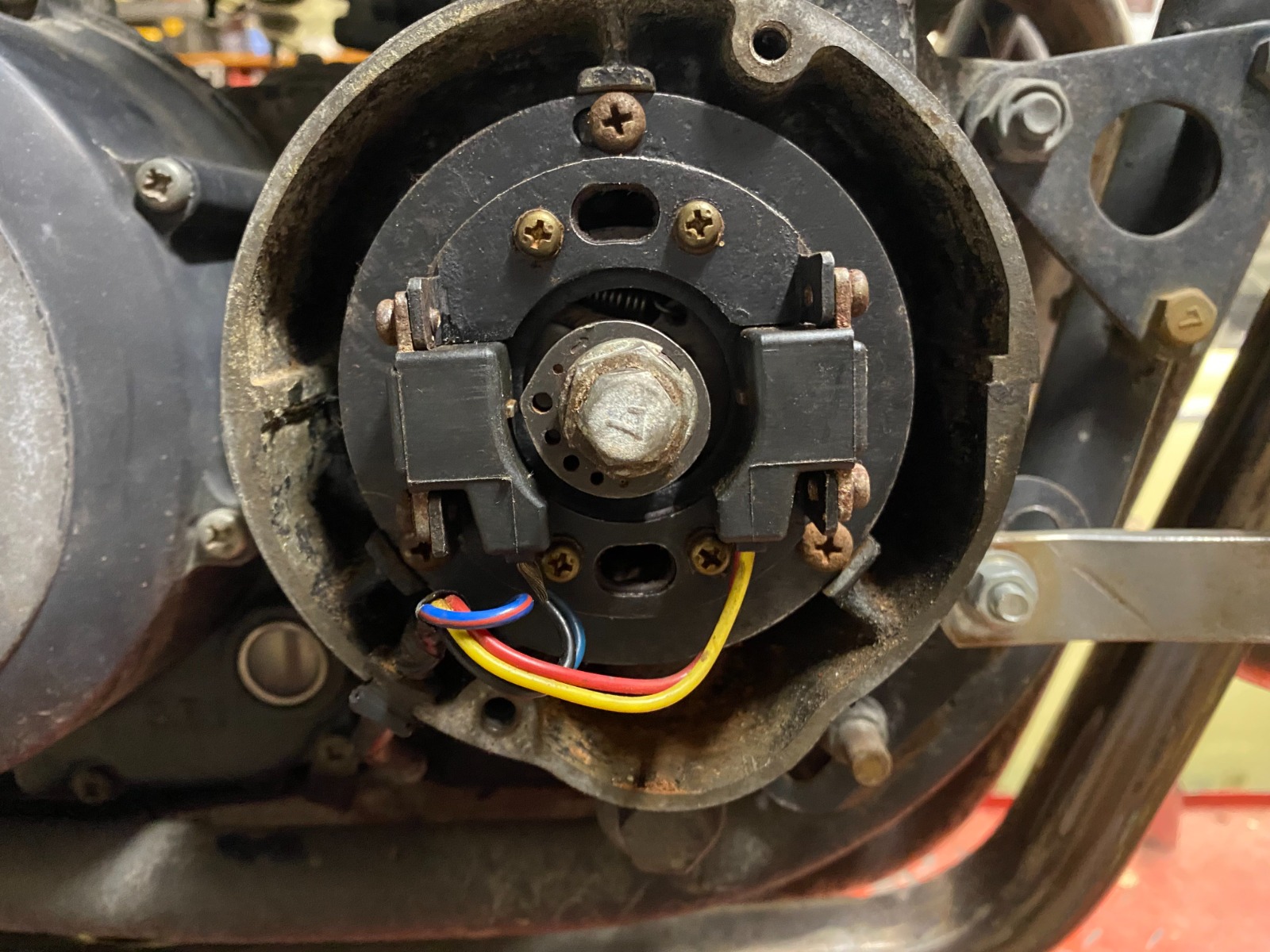

I did pull the advance and pickups apart and clean all of that up and put it back together. The advance was rusted solid (no movement), but I pulled it apart and cleaned and greased it so it snaps back nicely now. Any hooter, wondering if I did put something back together right there. Does anything look amiss below? As I said, the resistance tests pass for the pickups. What is the best way to get if a pickup is making it up to the coil? Wookie mentioned a test light between the two terminals that attach to the coil?

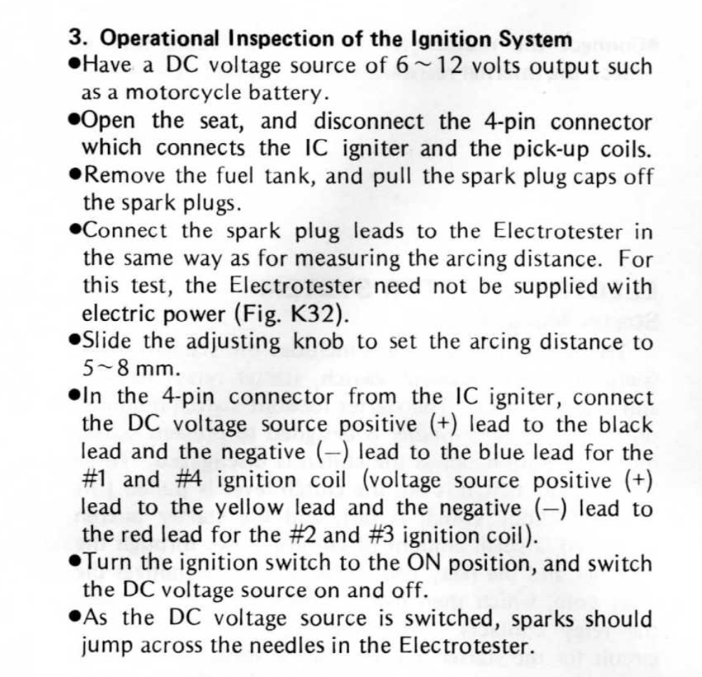

JR, good call on downloading the GPZ750 manual. I found this test procedure and when through it and indeed, I laid eyes on spark on all the plugs. So, this is telling me the issue is with the pickups not sending a signal. I did resistance tests on the pickups and they passed. Is there a way I can force the pickups to fire if I touch a ground wire to the pick up lead should the points fire?

Exposed copper wire conductor here is not good.
I suggest adding epoxy / JB Weld right there to prevent vibration from fatiguing the joint, which is buried inside the plastic...
Mine looked exactly like that... before it failed...
My 2c....
H.
My 2c....
H.
