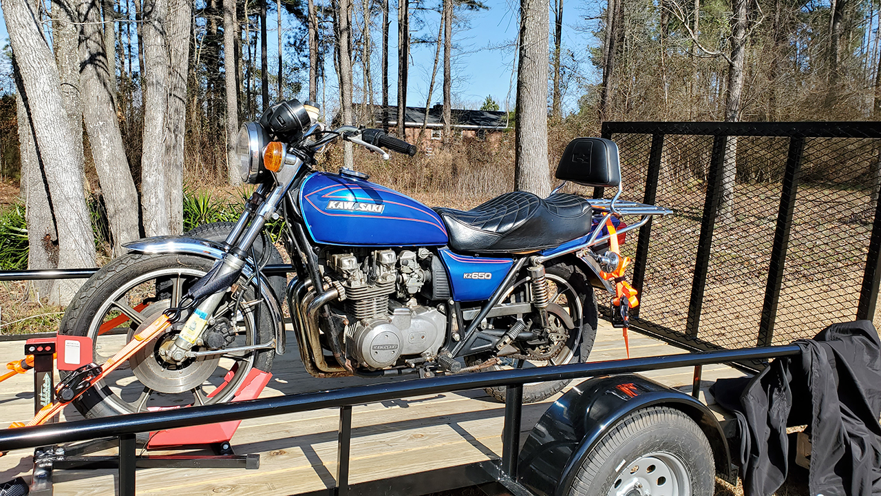

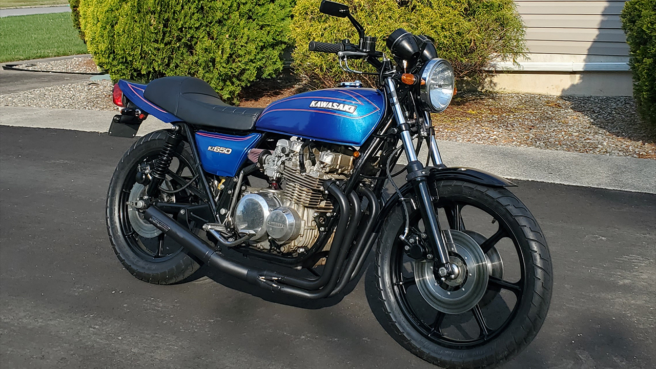

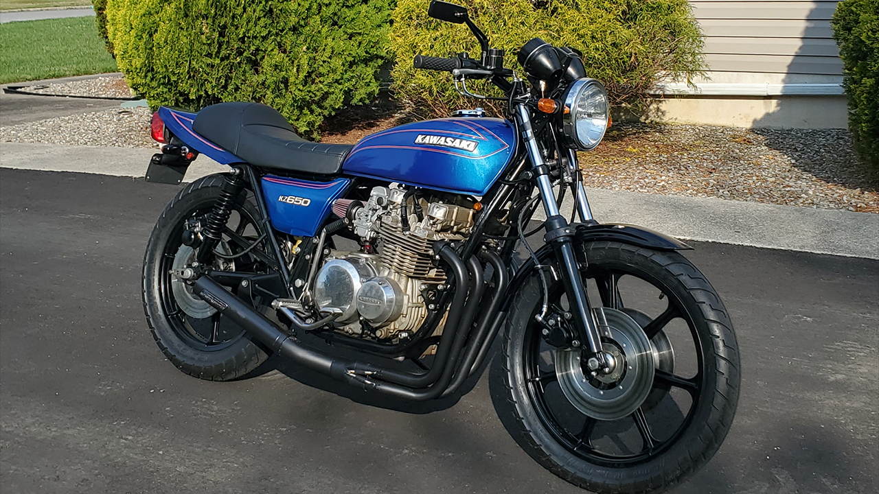

Hey guys, I have been meaning to join KZRIDER for long time, but there is so much good info on here that I kept putting it off because I always found what I needed. I have some things I want to get right on a 77 KZ650C, and one of your members has what I need. I built the KZ back in 2021, buts it been sitting for 2 years. I want to get it back to a daily rider. It does not need much, just a few things to make it right.
Anyway as you can see from the photos, its a before and after project. I know some of the purist are cringing, but the build was all about building the KZ like my brother did in the late 70’s Its kind of period correct with the mods he did back in the day with some modern touches. I call it a resto rider mod. Its not a nut and bolt restoration. I just wanted to make it a daily rider with some old and new parts. I fix and changed everything it needed, and kept everything that was in good working order. It’s a blast to ride and brings back good memories.

NICE BIKE PICTURES

Looking at the pics I can already tell you… POD FILTERS.!

05 Nov 2023 05:48You are correct, the bike runs great... starts easy, idles nice, cruises nice, but between 2500-4500 when you just twist the throttle a bit it has that little flat spot.Looking at the pics I can already tell you… POD FILTERS.!

05 Nov 2023 05:58Air corrector jets will get rid of that flat spot.You are correct, the bike runs great... starts easy, idles nice, cruises nice, but between 2500-4500 when you just twist the throttle a bit it has that little flat spot.Looking at the pics I can already tell you… POD FILTERS.!

No cringe here. The bike looks great!

Very nicely done.
