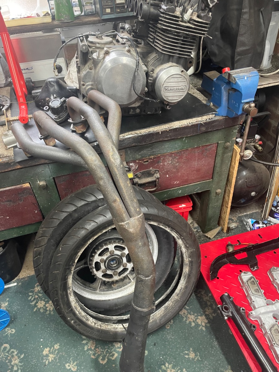

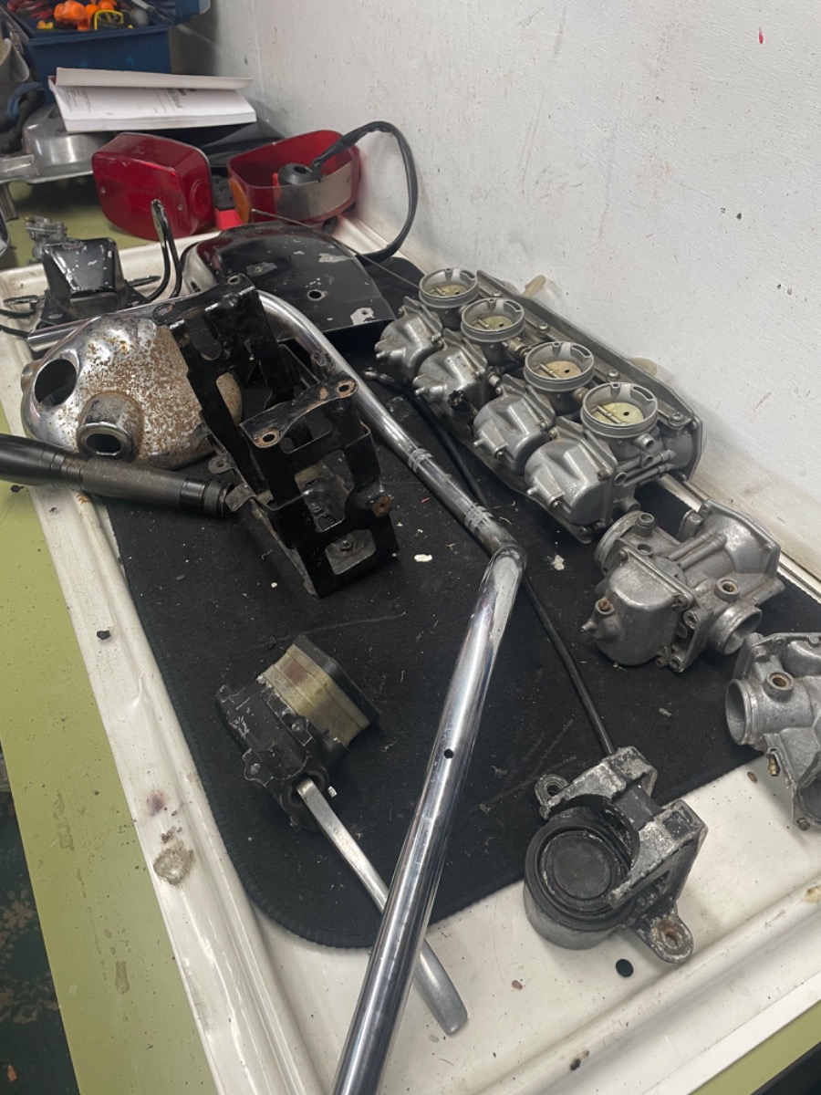

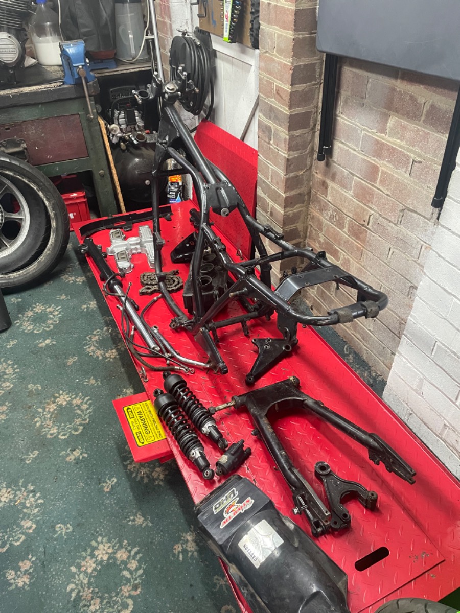

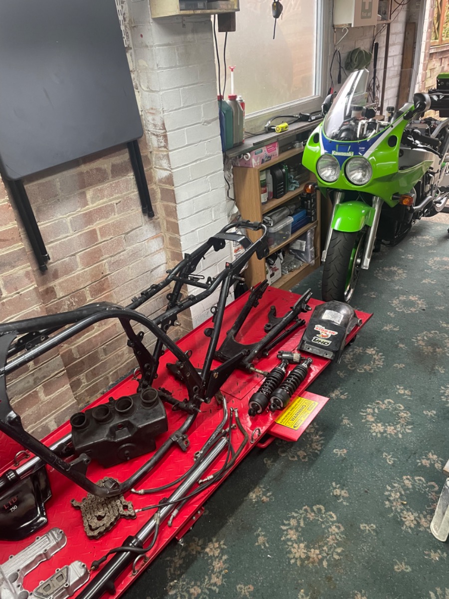

Hi all,
New to the KZ world although I am a fan of Kawasakis, owning a ZZR1400 and a ZXR750H1.
So I have just taken delivery of a huge box of bits which hopefully will assemble in to a KZ750H1 LTD (I think!). Im just trying to identify what I have, the frame number is KZ750H-011999, which Im fairly sure is a KZ750H LTD? Im across in England so I might have some difficulty in obtaining spares. The main wiring loom has basically been cut off, rather than disconnecting the connectors, so I could maybe repair it or preferably find a good one to buy. Are these readily available at all?
I tried to attach photos but either Im too dense to do it or there is something else amiss.

Good to see you recognised that as a H1. Not many would because its got the H2 stickers on the nose cone! Removing those, or fitting a new cone, is the last job on that bikes restoration.
- Oddy
- Posts: 3
Re: New owner of a box of parts!
15 Nov 2022 01:25
Excellent! So mine is a 1980 KZ750H1 LTD. I can now get started ordering some parts. Thanks for that.
