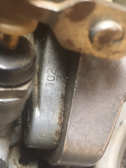

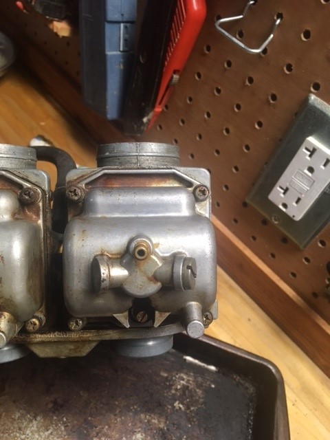

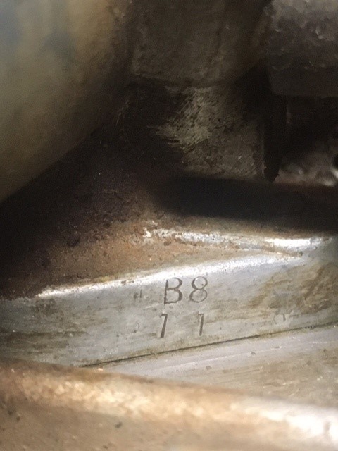

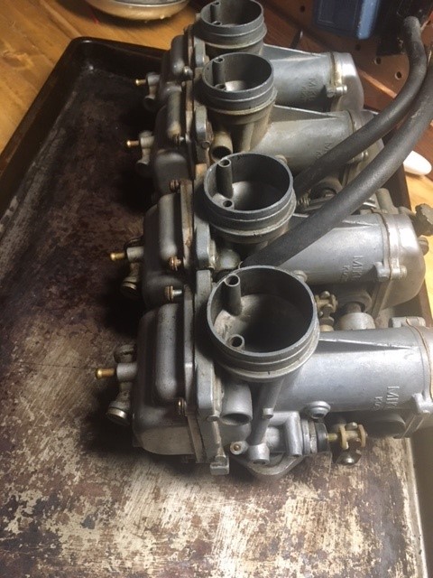

I've got lots of carb questions. I'm guessing its better to post them in the carb forum though. I never use forums or any form of social media stuff so somebody has to let me know etiquette here if I'm doing something wrong. I only have carb pictures, but I can post some of the bike tomorrow.
Nessism - I'll need O-rings and bowl gaskets. That's why I was trying to identify the carb. Are all KZ Mikuni carb gaskets and O rings the same?
GD4now - I think the carb may be from a 77 KZ1000. I have a note that the original owner paid $700 for carbs and Kerker 4-1 exhaust in March of 1980. For that price back then I would have assumed he bought a new carb. He only paid $1300 for the bike new in Jan of 1980. I've attached pictures.

The pic you posted are not vm24ss or vm22ss carbs which were the vm carbs offered stock on the 650s. The pics you posted are either vm26vm or vm28carbs. The smaller carbs (22 or 24) have ribs on the upper part of the carb body. Your cabs have only a pilot screw no air screw and I will guess that they are vm26ss carbs mostly likely off of a kz1000. But do not take my word for it. Once you open them up some of the internals may provide a better idea as to just what they are.I do not currently have the ID you stated 102/3 in any of my data set, but do have 102/1, 102/2, 102/4, 102/5 as being stock on kz1000 different models for the years 1977 -1980..

+1 on the 26mm. My 24s have 3 small horizontal ribs and one more prominent vertical rib (much bigger than the 26s) for the airbox side that are above the bowls on the main body. 26s which have no such ribbing came on some 650s in Canada and abroad so you are off to a good start. They should still slide into the boots okay. 28s were used on I believe the early 900s and then later on the LTDs with pampers.

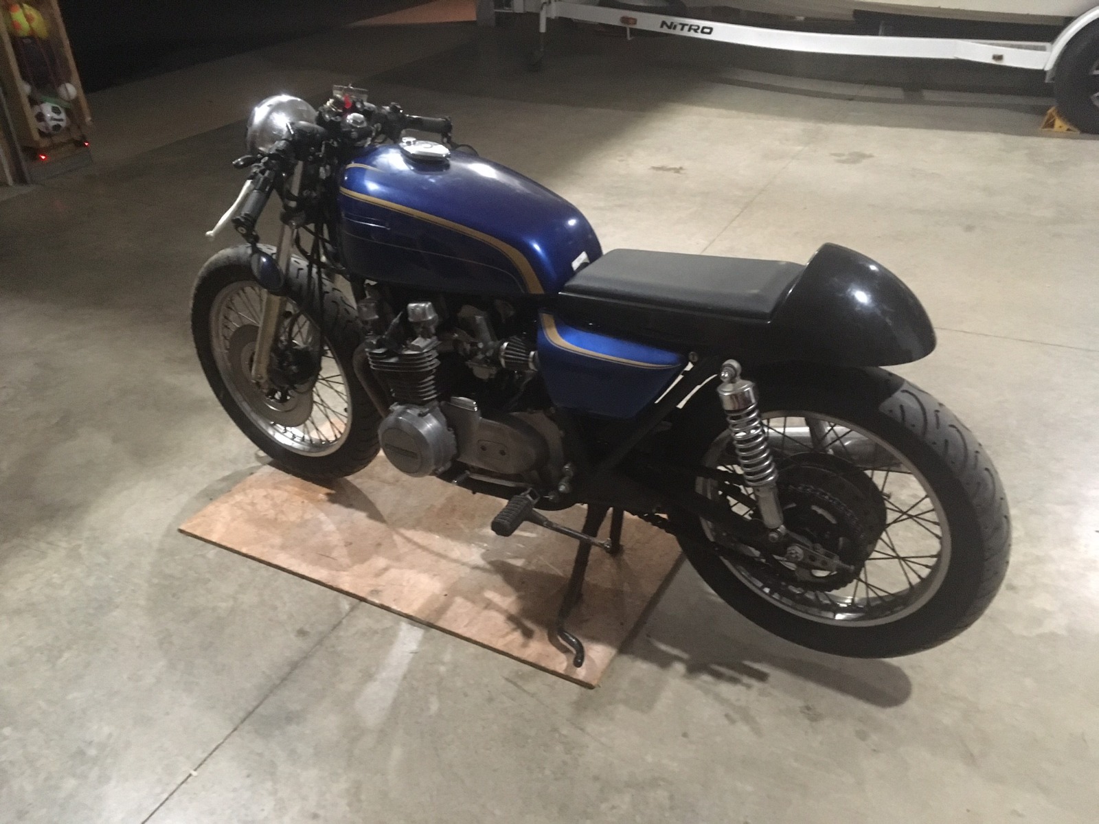

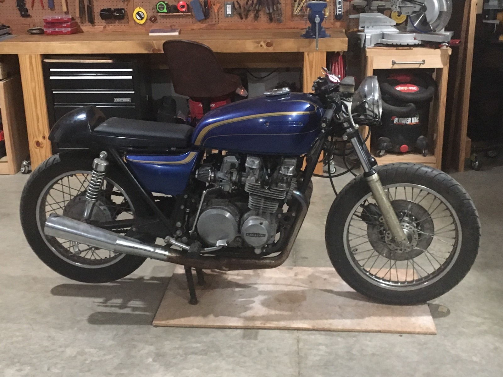

Here is the bike. I did get the carbs back on and started up last night, but I still have a lot of issues to work out.

- rstnick
- Posts: 4691
- Thanks: 577
Re: Returning Member from Kentucky
29 Sep 2022 09:28
Welcome back Kevin.
I wonder if the engine has been bored larger?
Why else would someone put larger carbs on?
And pod filters too.
Hopefully set up right, otherwise She probably doesn't/won't run well.
You did ride before with this set up, so something must be right.
