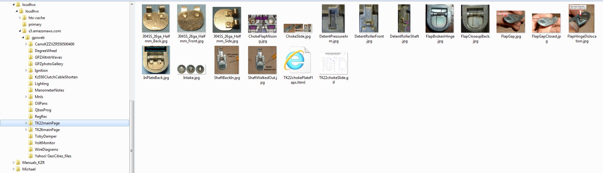

Read this link... s3.amazonaws.com/gpzweb/TK22mainPage/TK2...chokePlateFlaps.html
Oh, and read through that entire website and save as much info as you can. The author is a deceased member of this forum, and it's unknown how much longer that website will still be up.
Take special note about how the cam chain tensioner must be released before installing the valve cover. Tons of great info...

23 Sep 2022 11:32Don´t worry, AFAIK calum and i made a full webside backup. So nothing of loudhvx great knowledge will get lost. My special thanks goes to DOHC for the web side backup tool!Oh, and read through that entire website and save as much info as you can. The author is a deceased member of this forum, and it's unknown how much longer that website will still be up.
