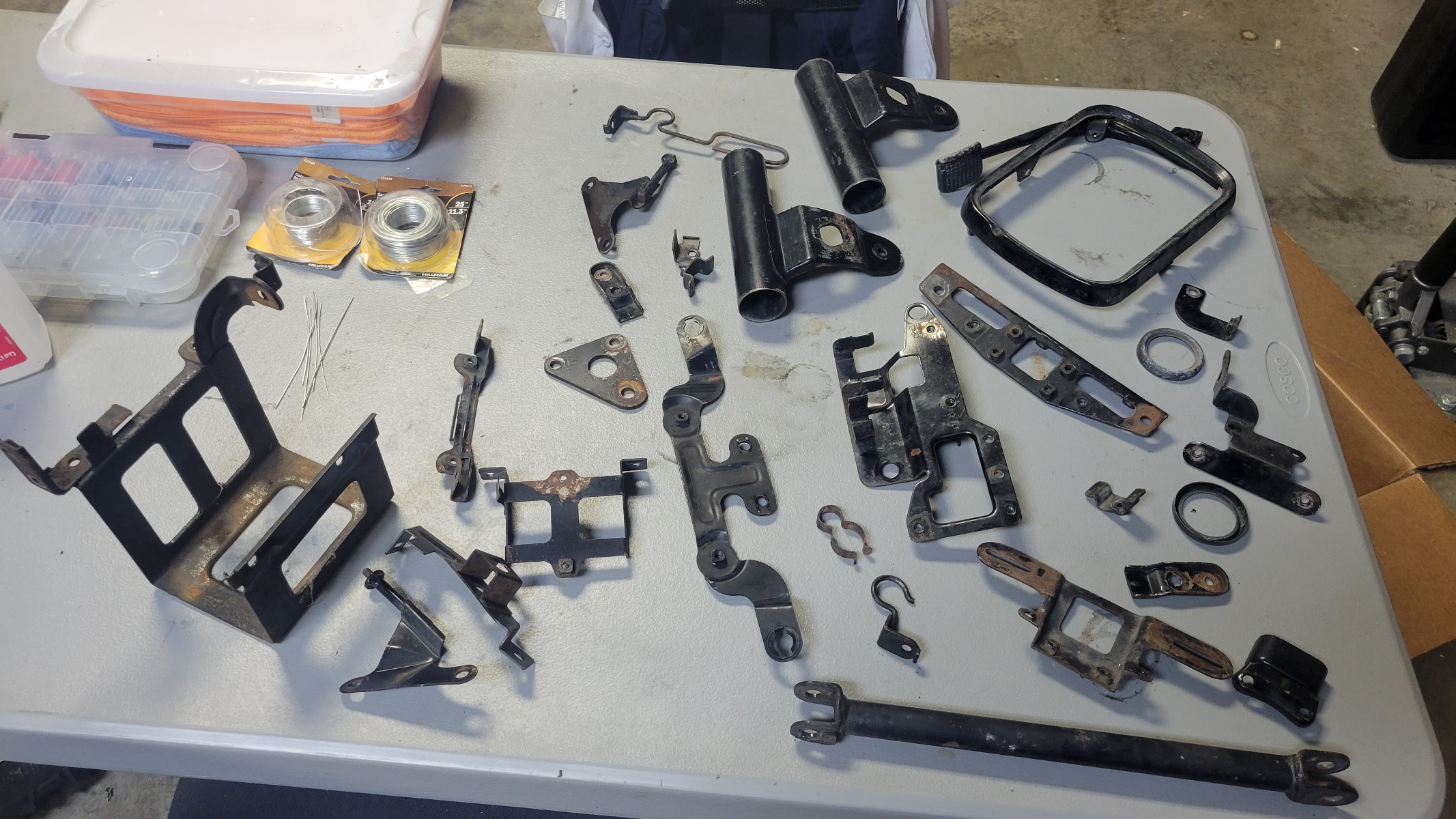

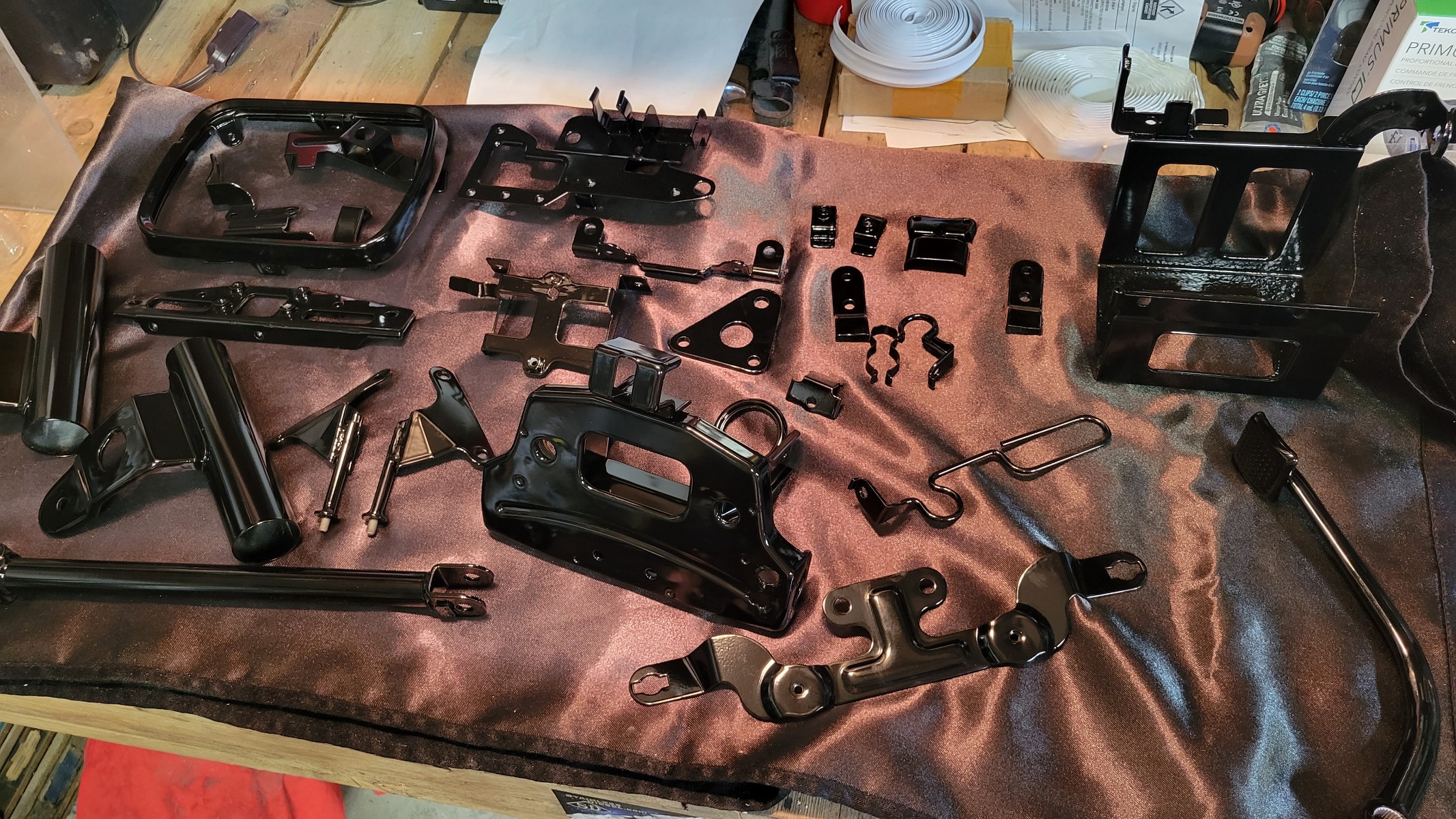

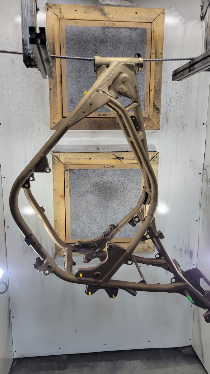

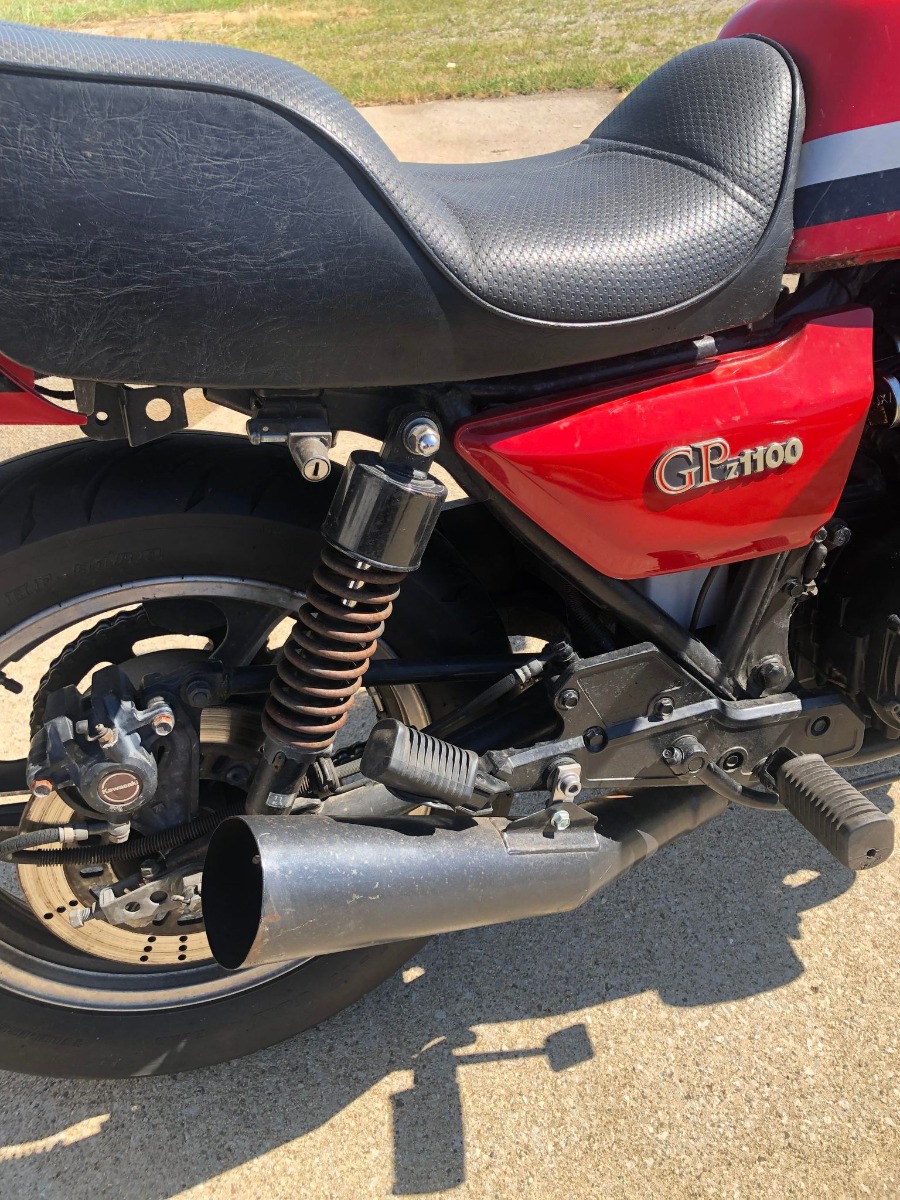

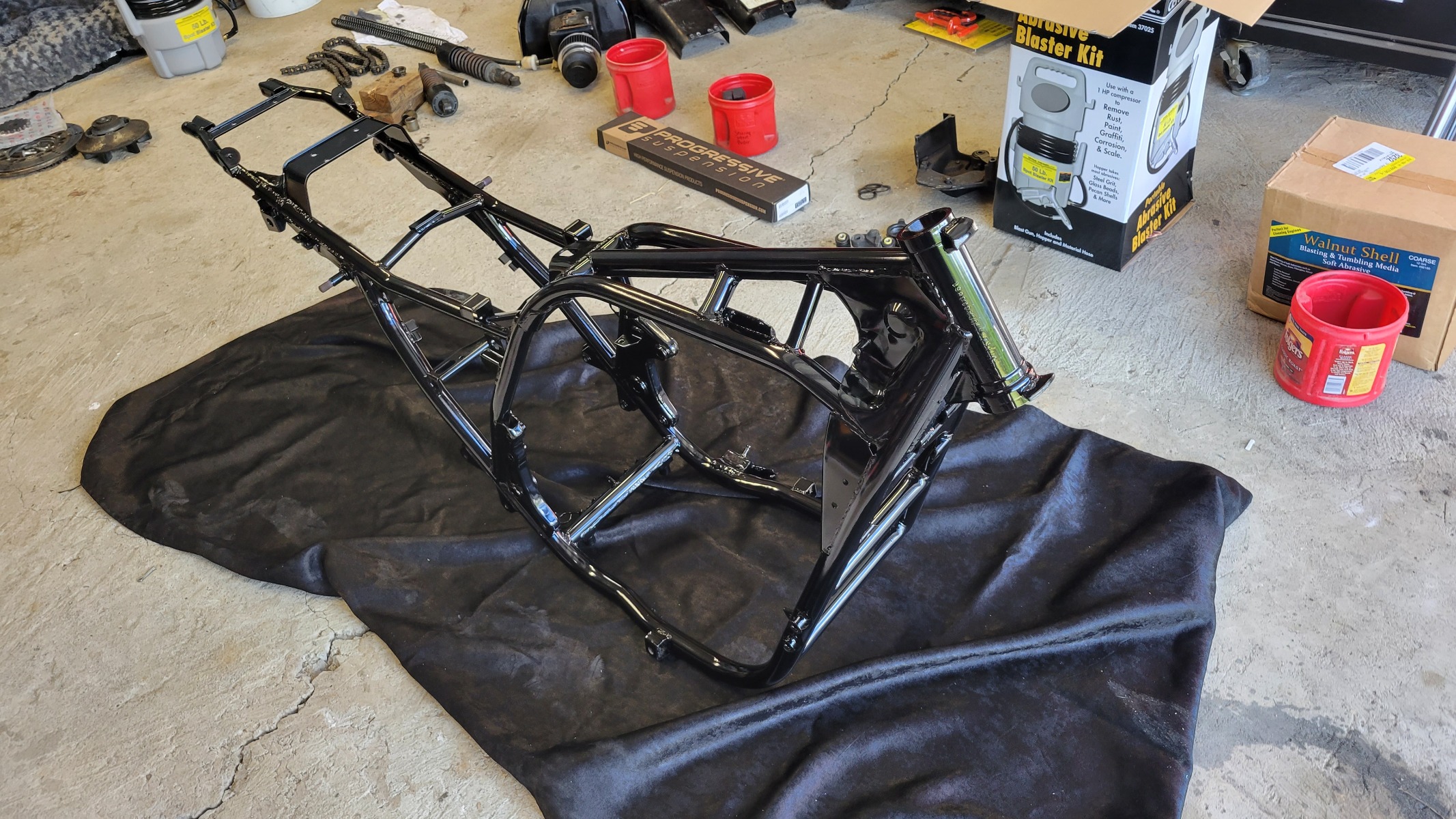

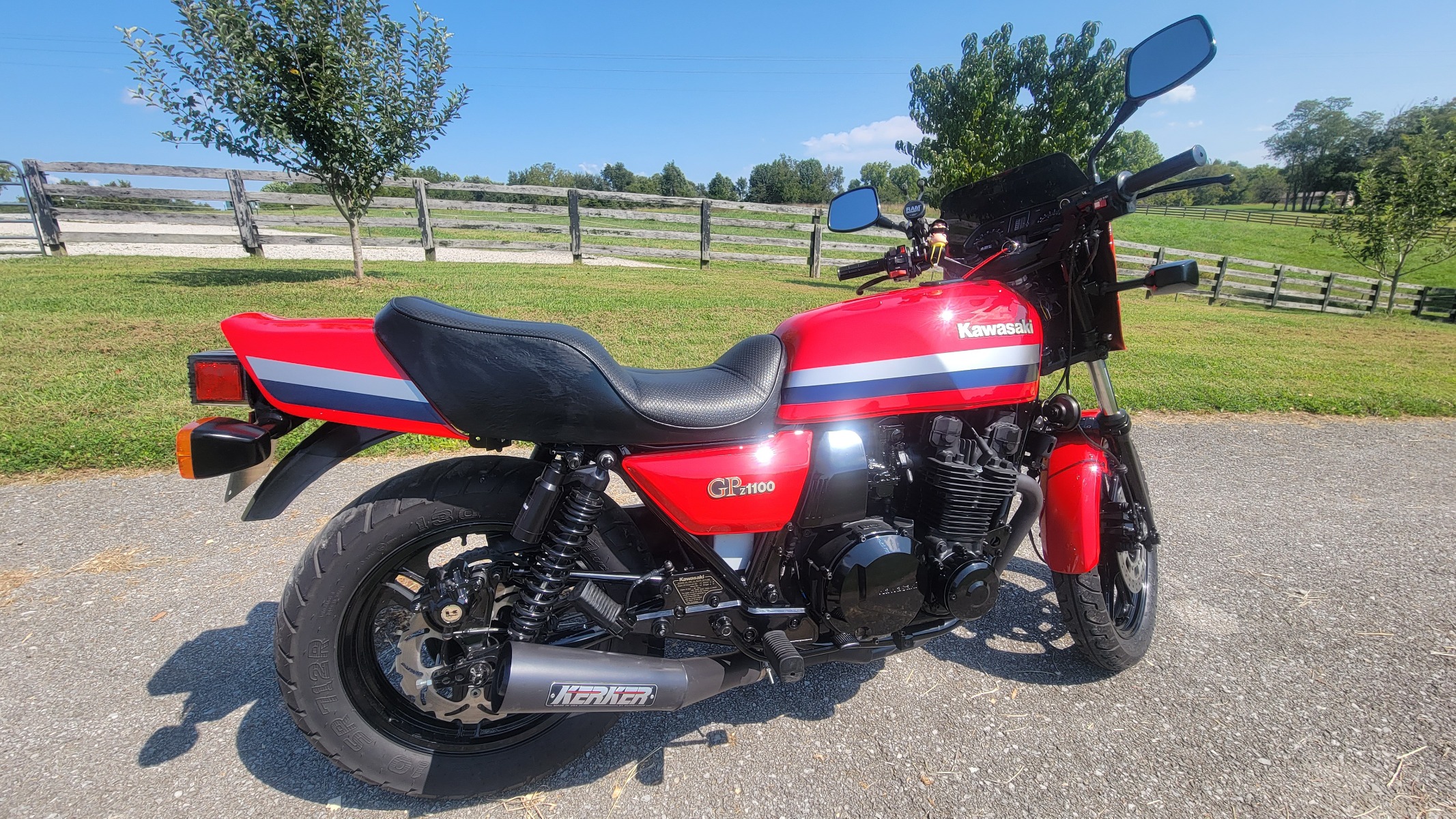

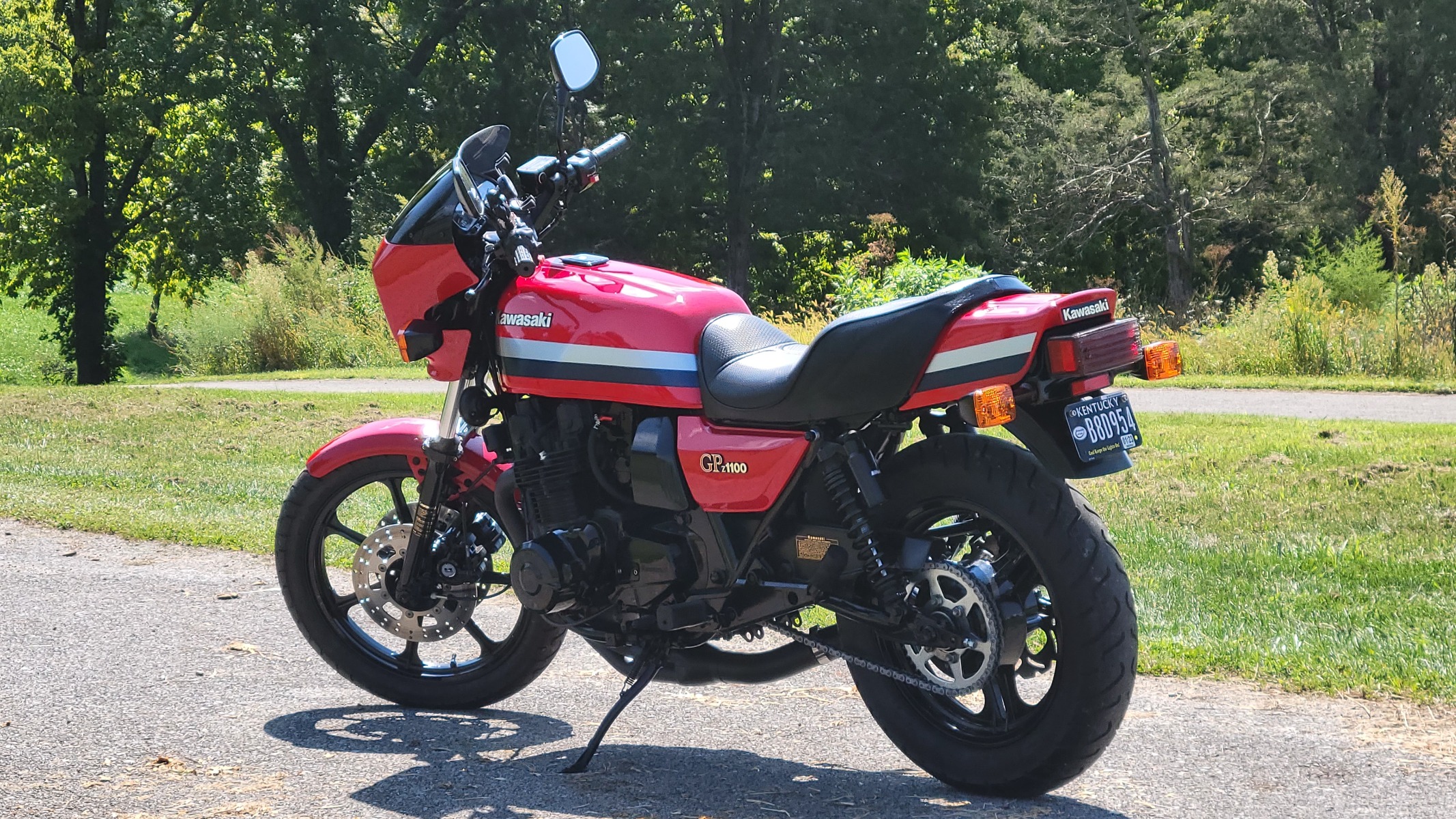

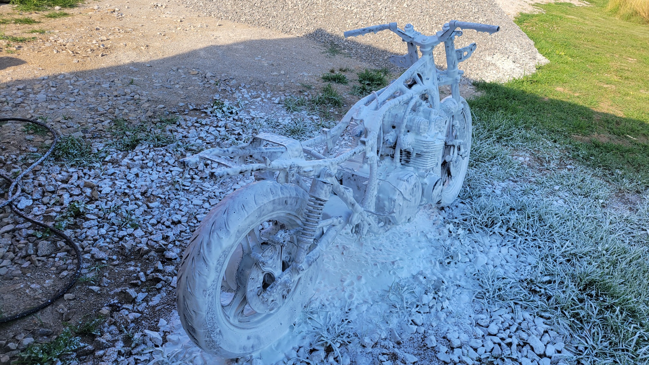

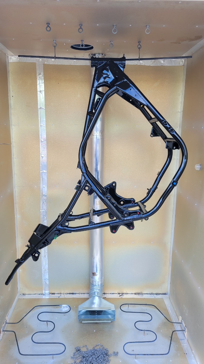

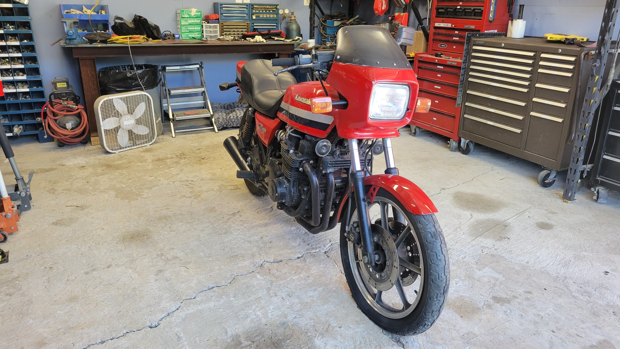

Hi,

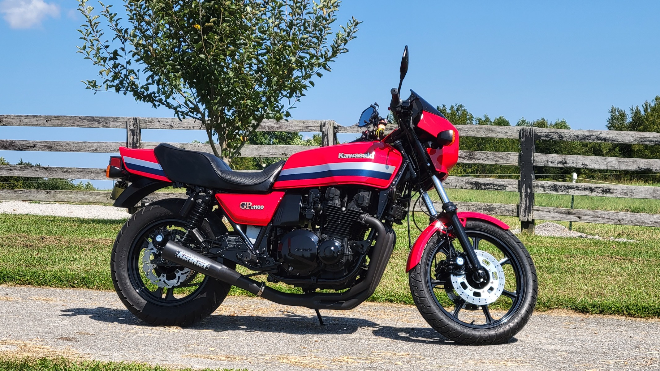

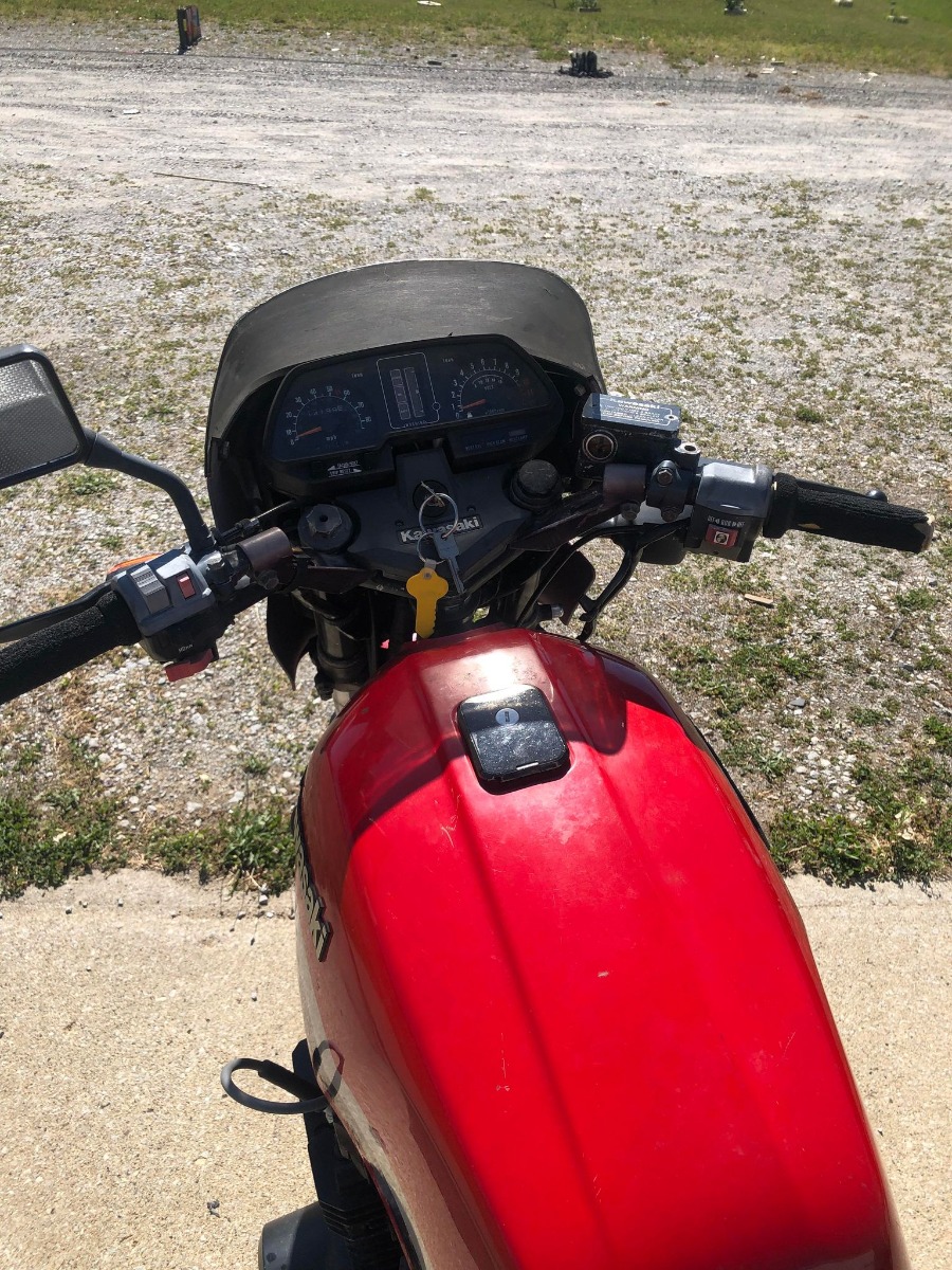

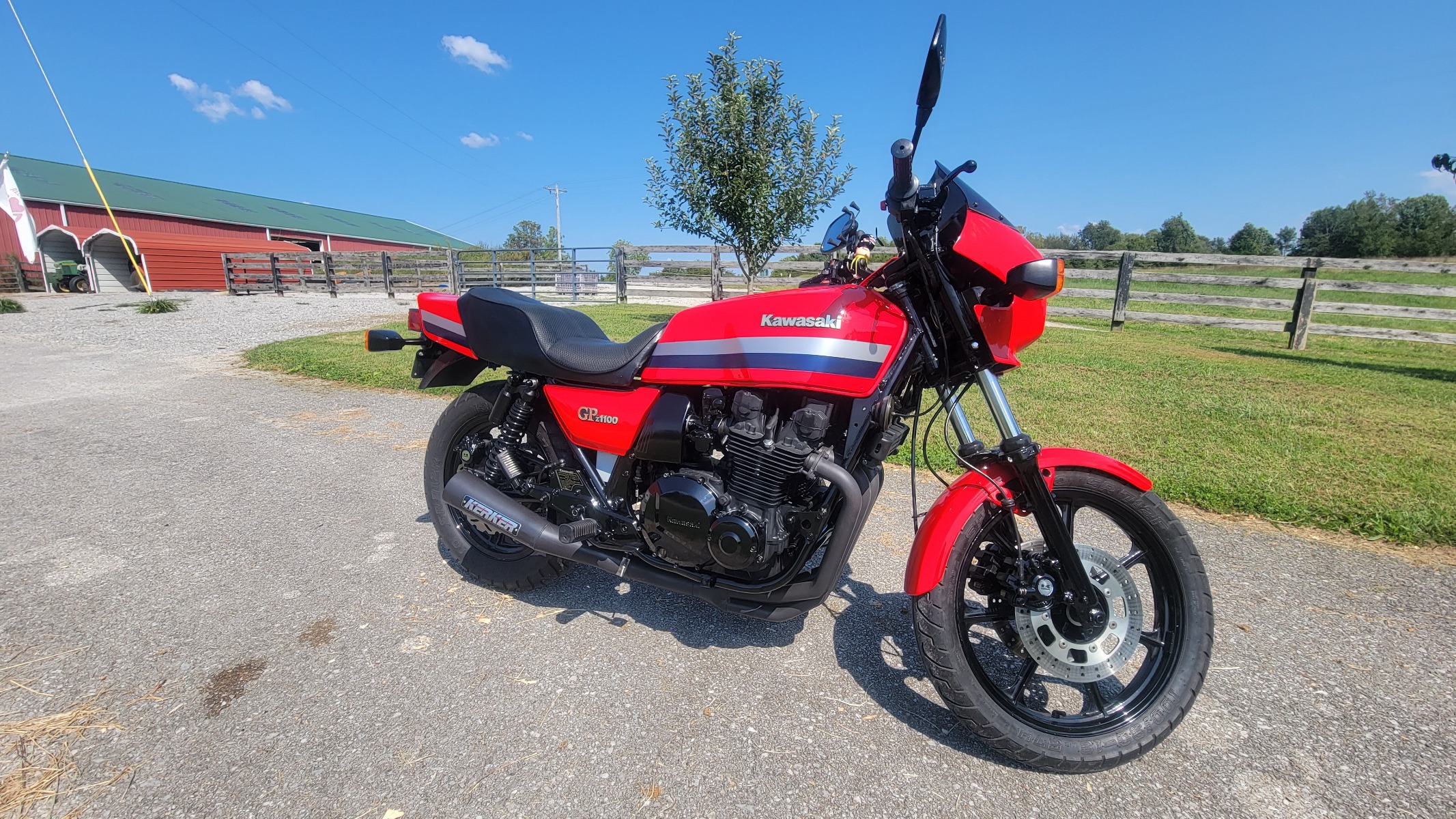

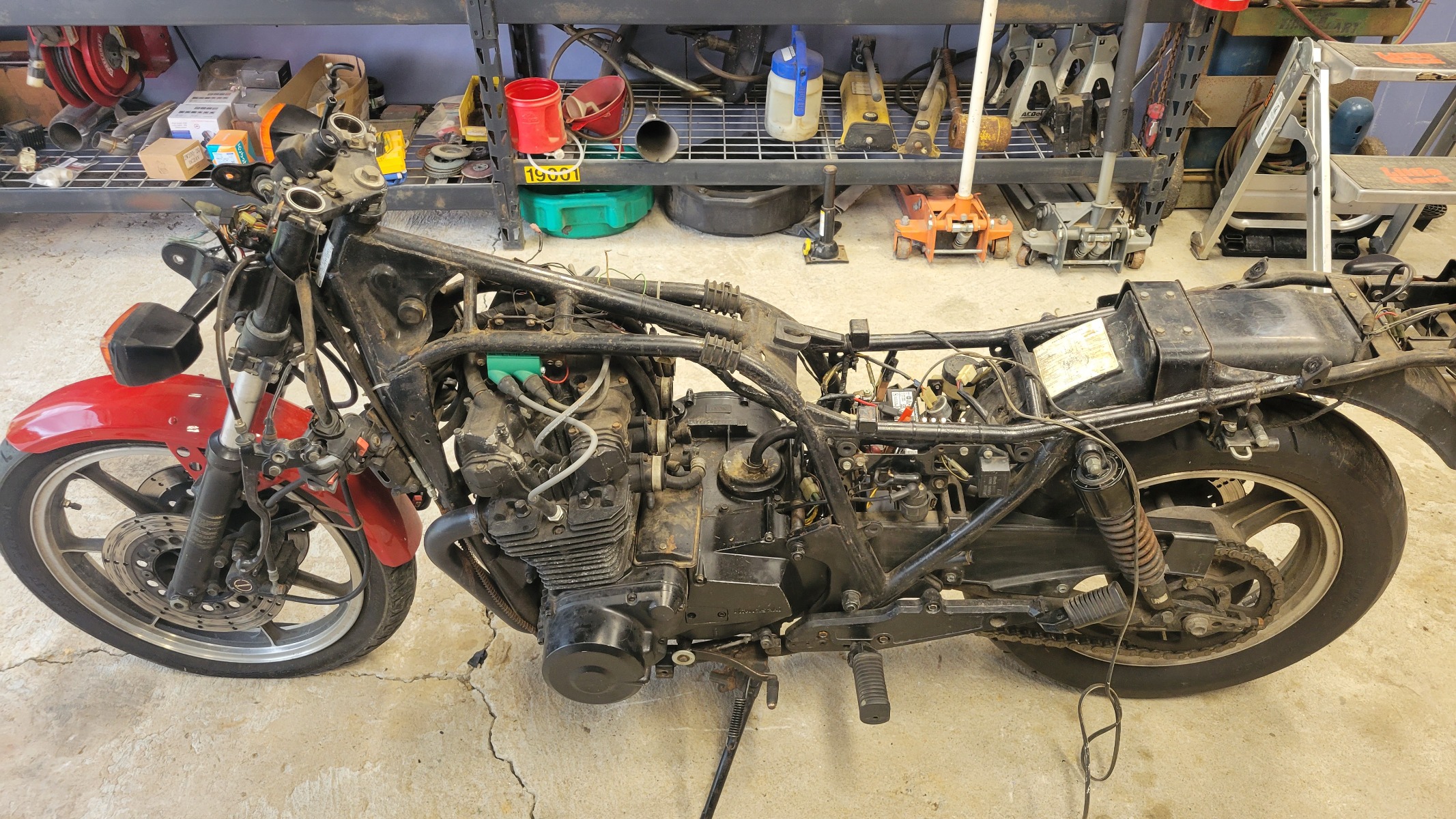

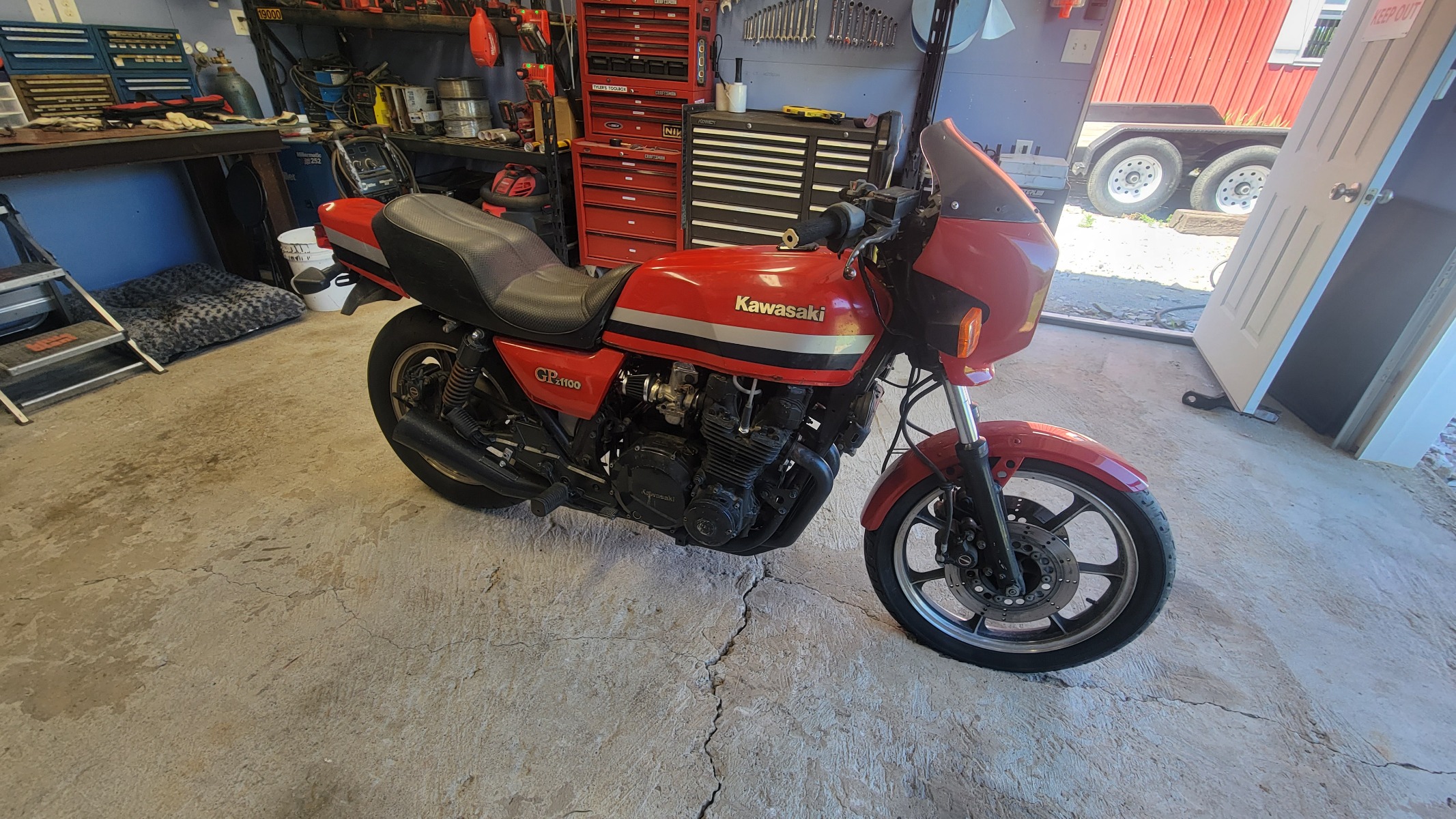

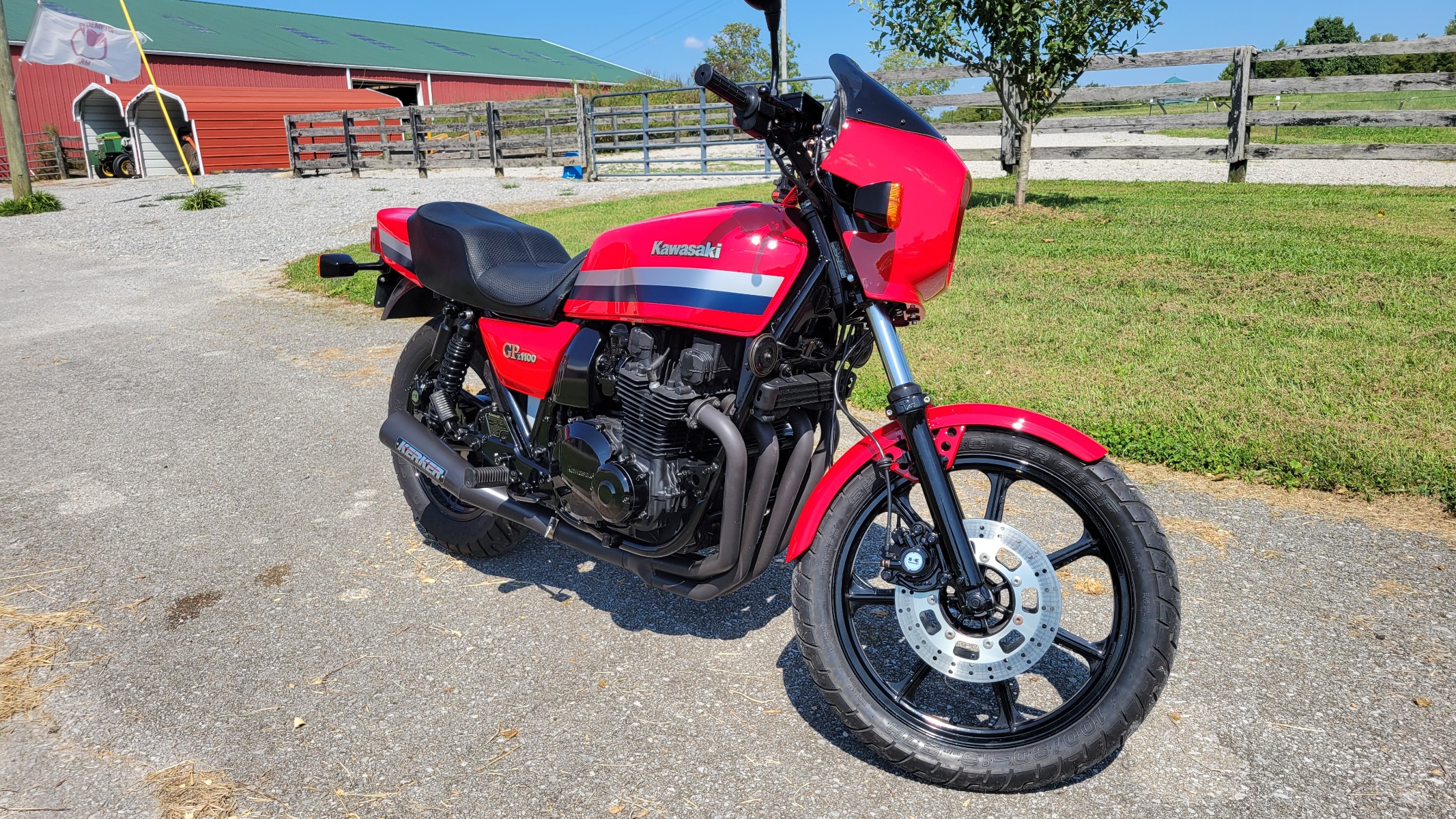

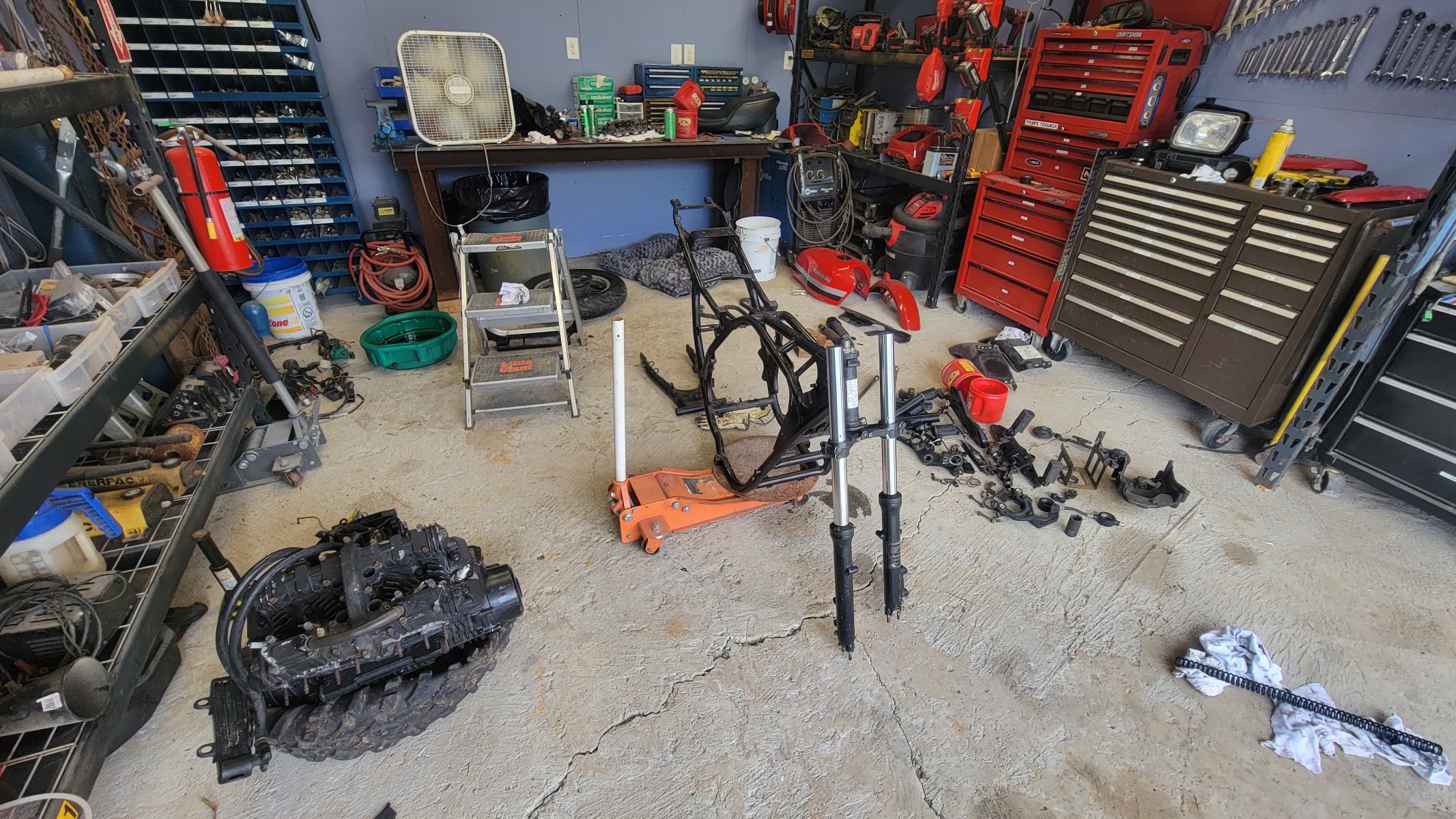

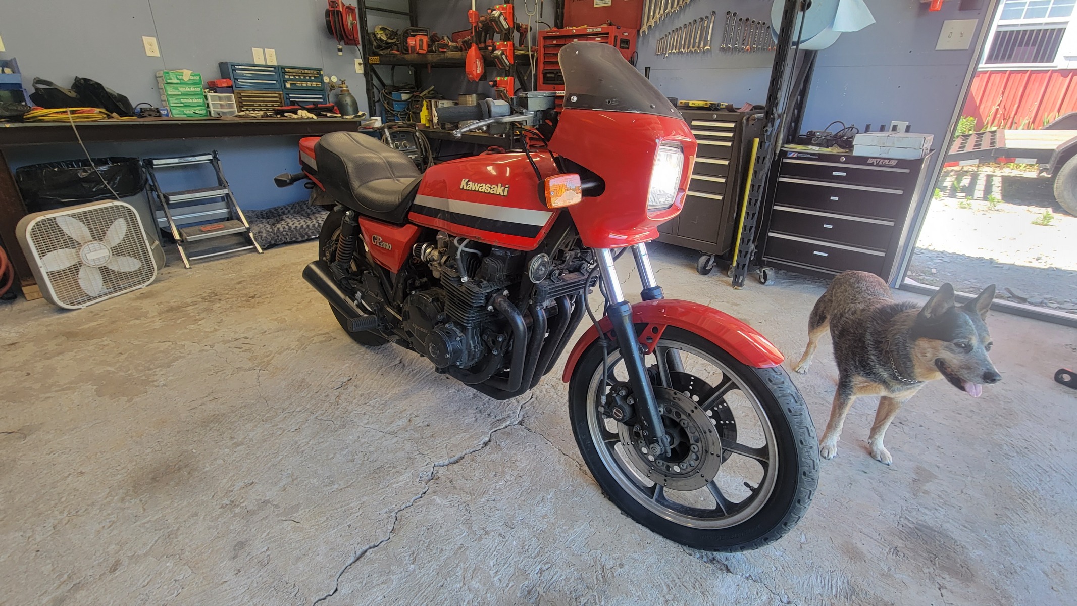

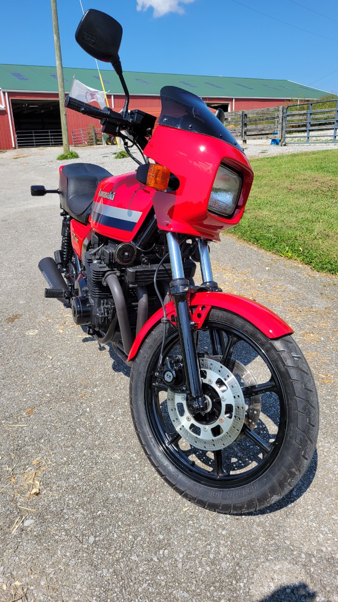

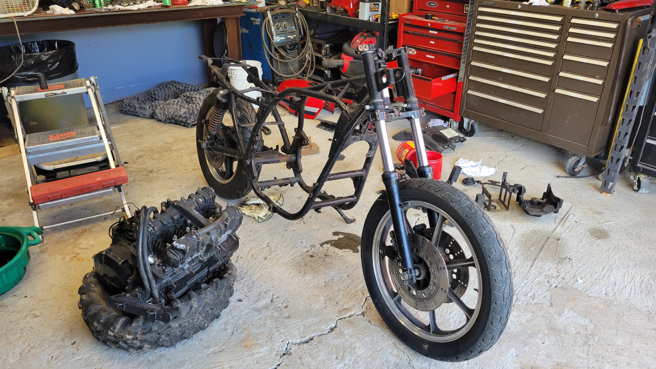

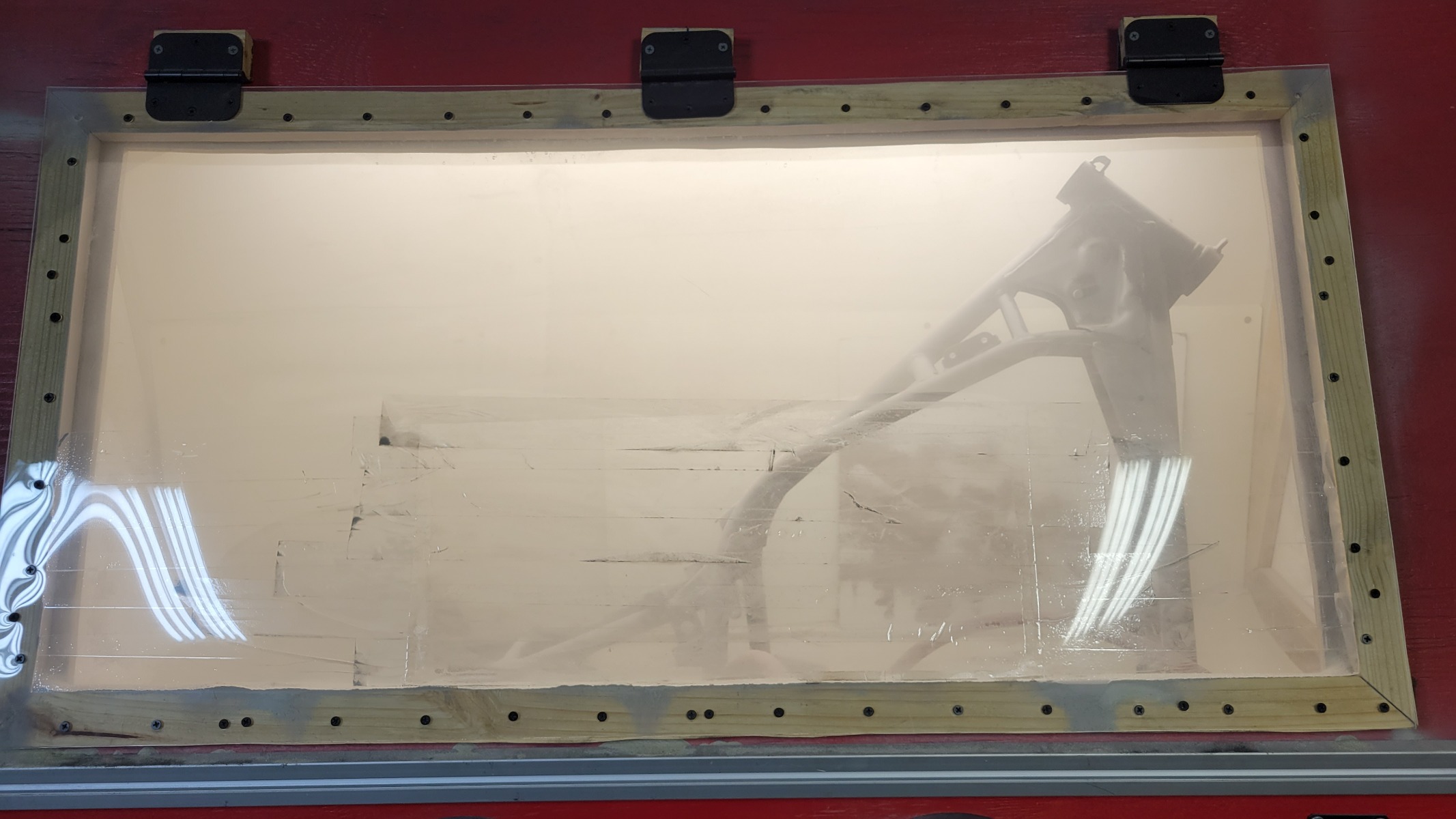

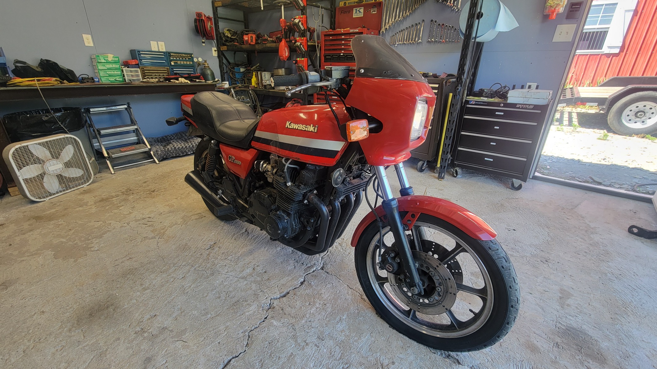

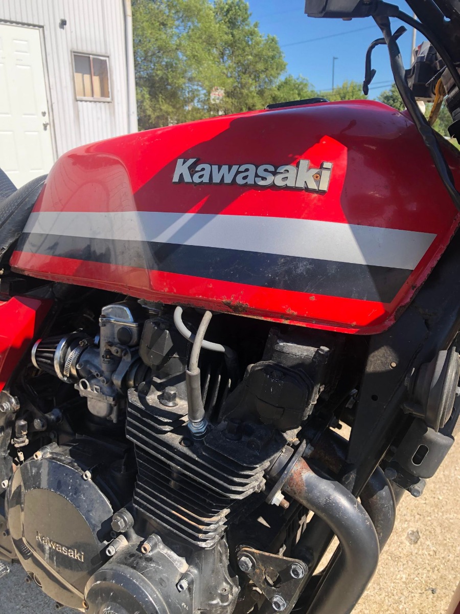

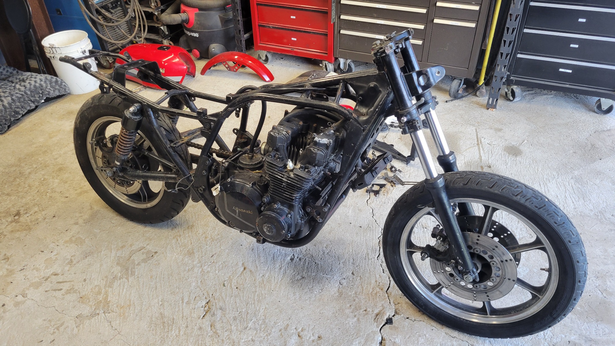

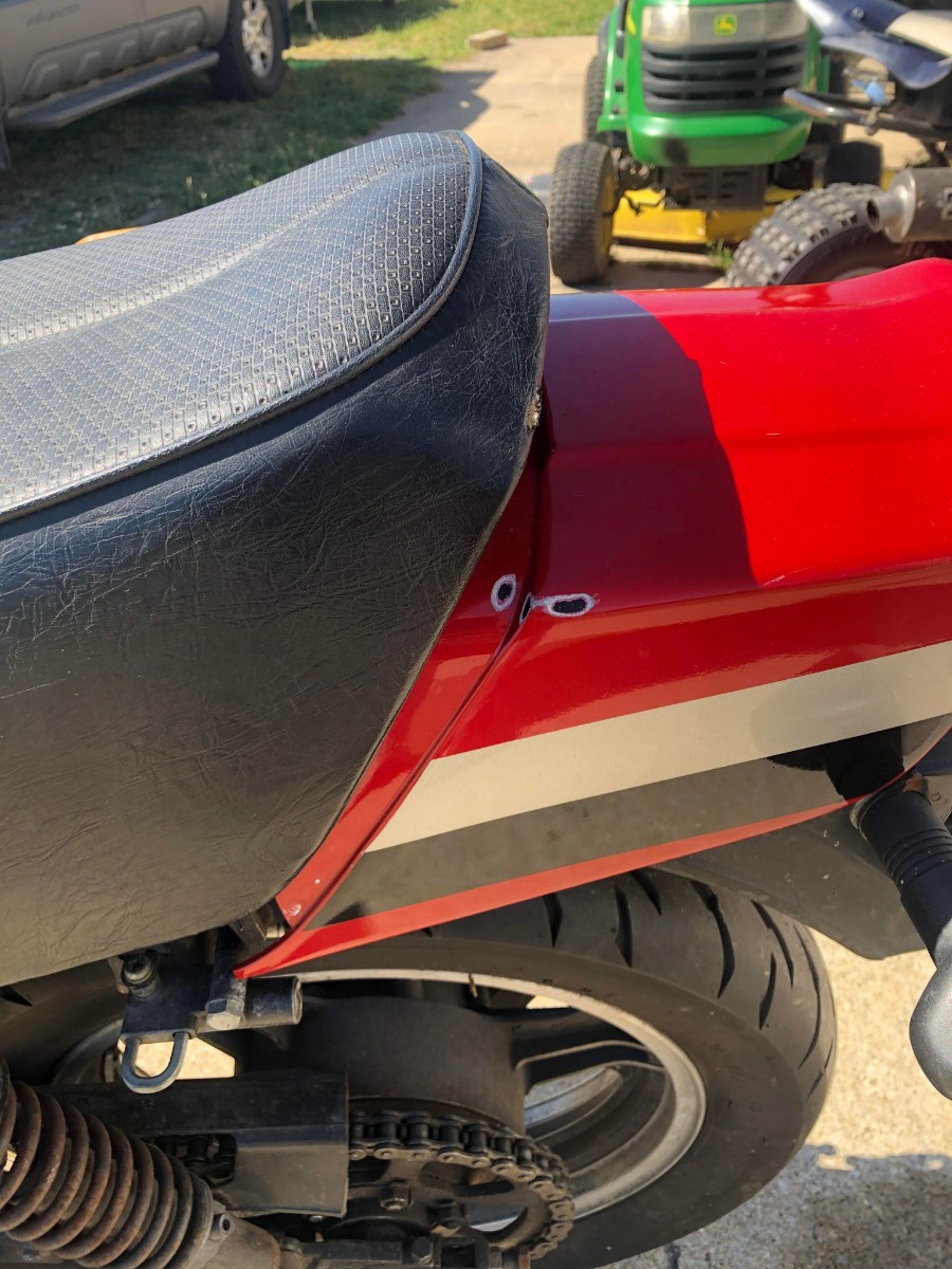

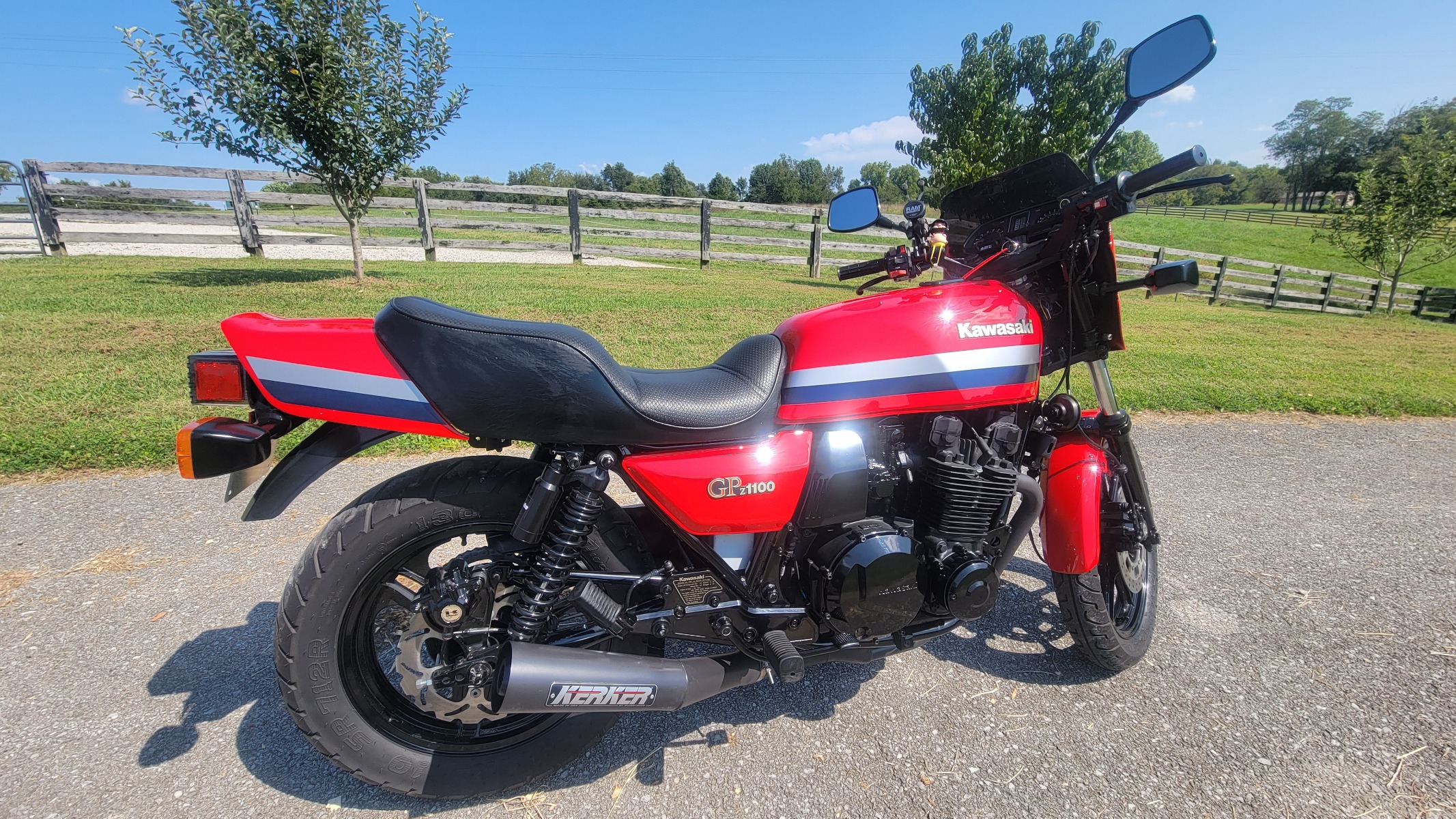

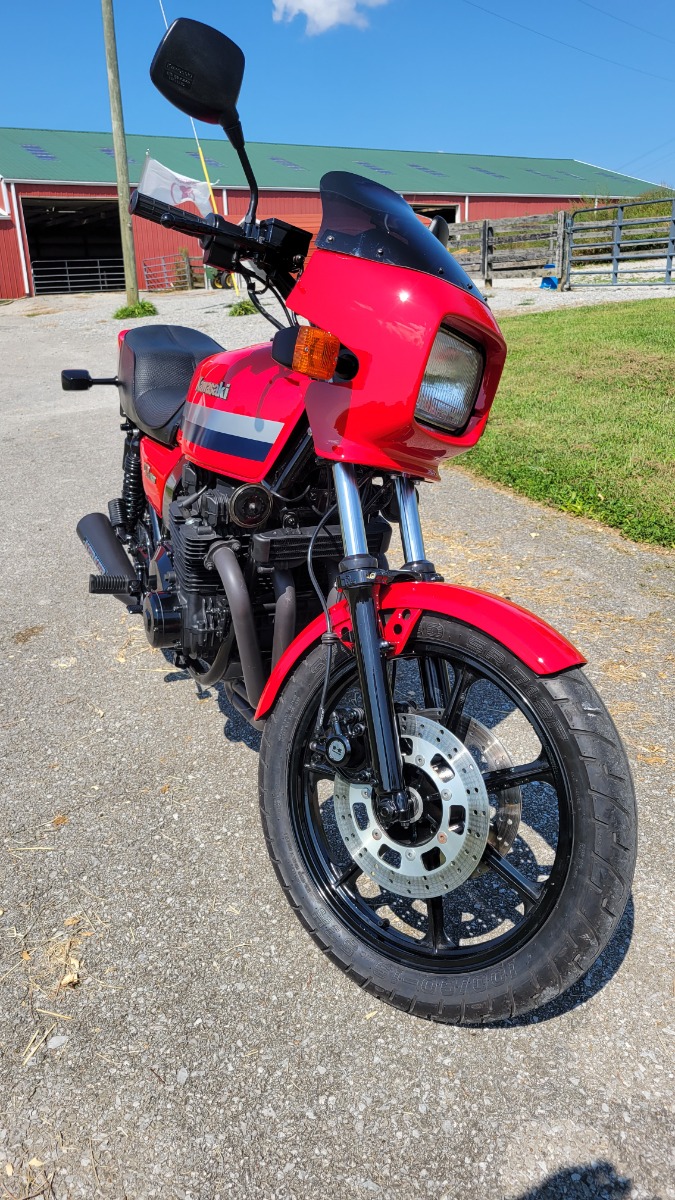

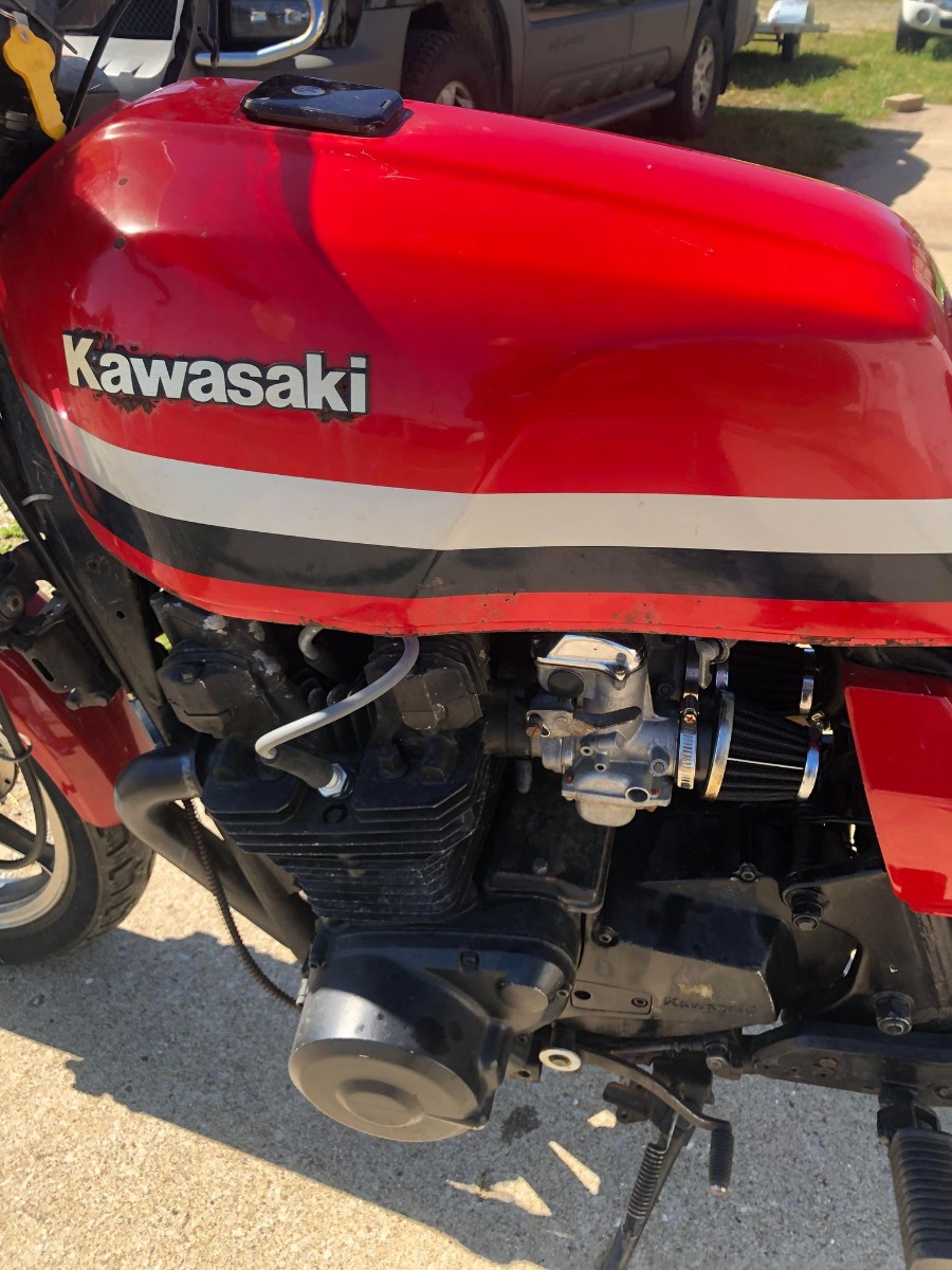

I just got done doing a full resto on an '82 GPz1100. Here's a couple before and after pics. Everything that could be blasted and powder coated was, including the frame.
I have a whole heap more pics of the whole process if there's interest.
~Tyler
~Tyler

By all means post more pics! Looks like you did a great job!

Nice Bike
Good Job.
BUT In the future please click the insert all tab to complete your picture install so they appear full size
I took care of it for you these last 2 times for you
Good Job.

Wow, Very nice!

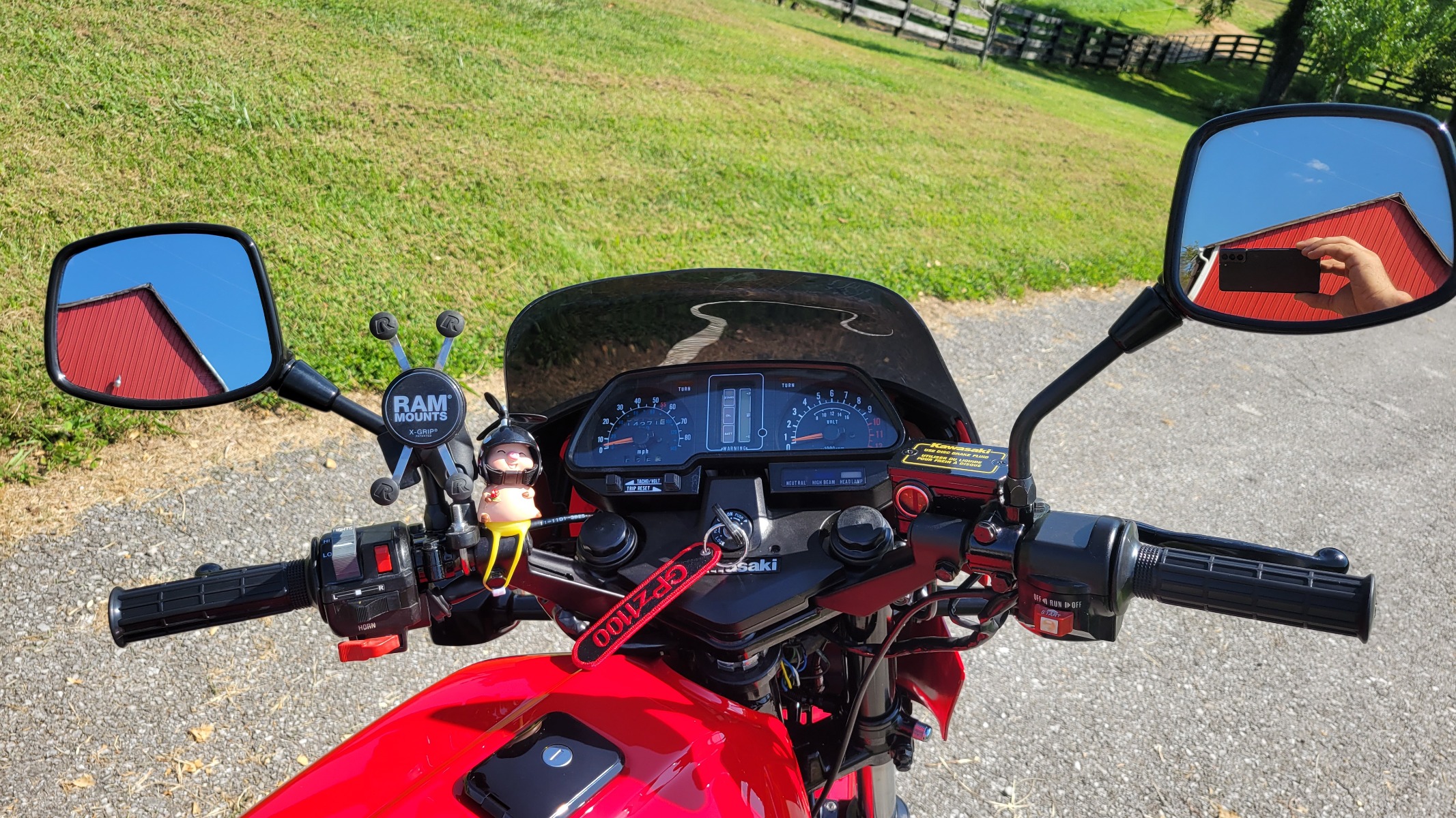

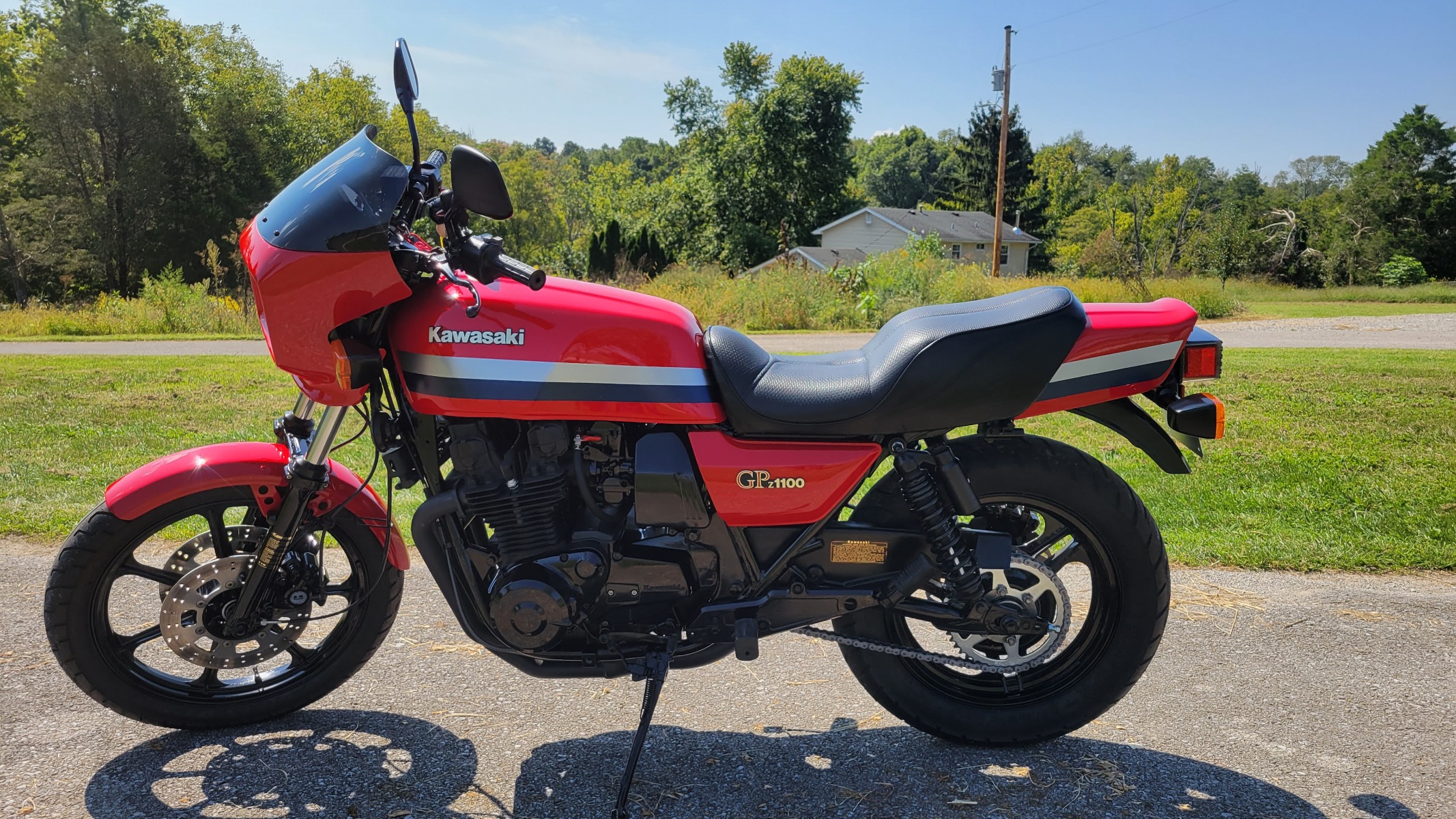

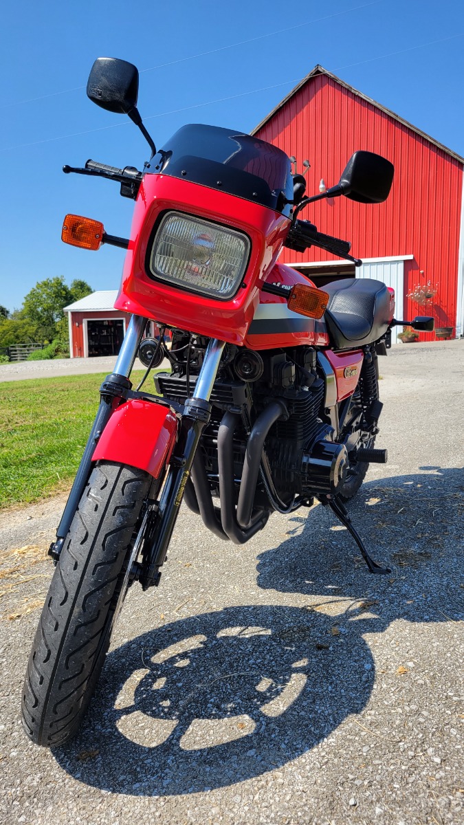

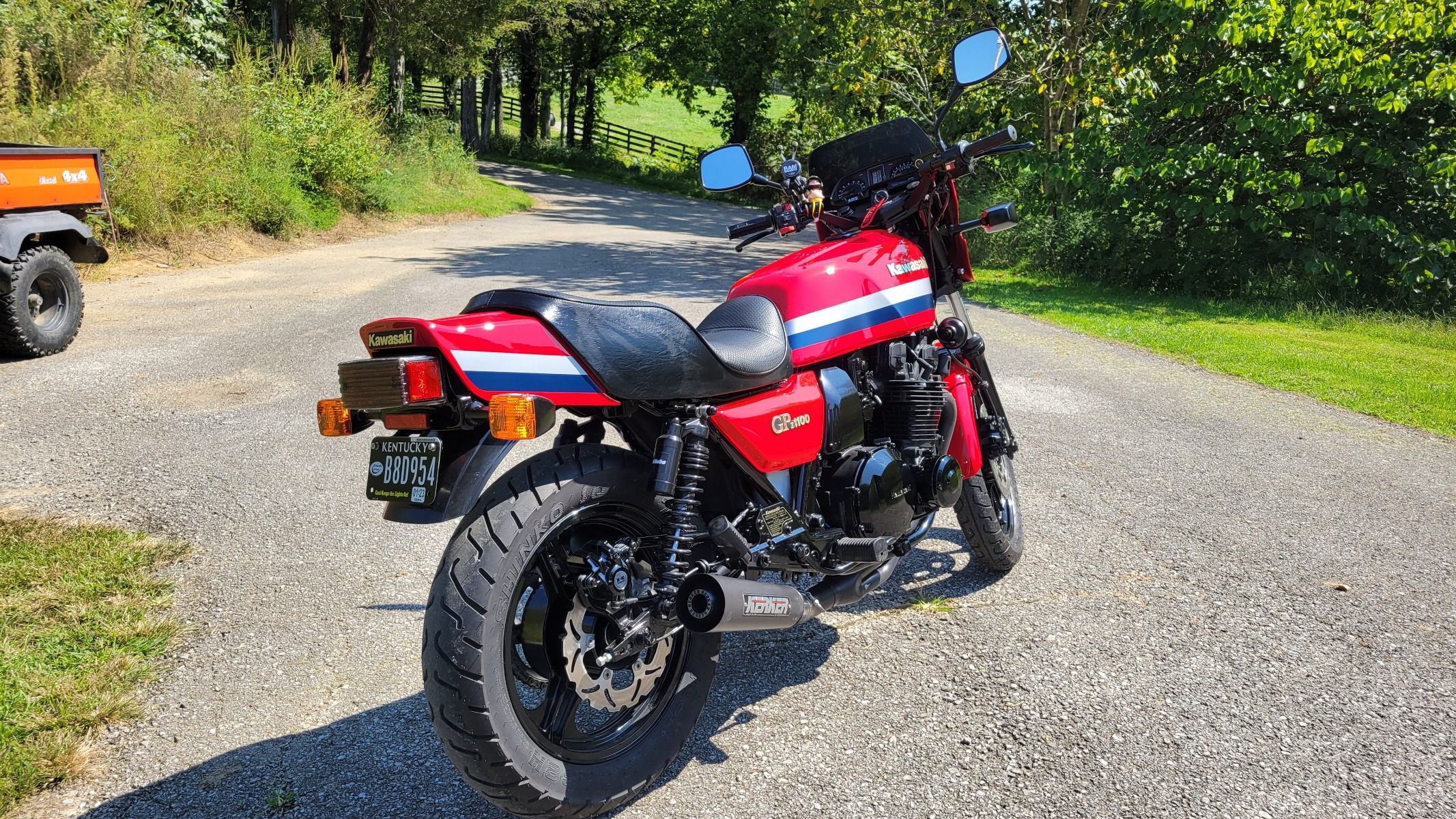

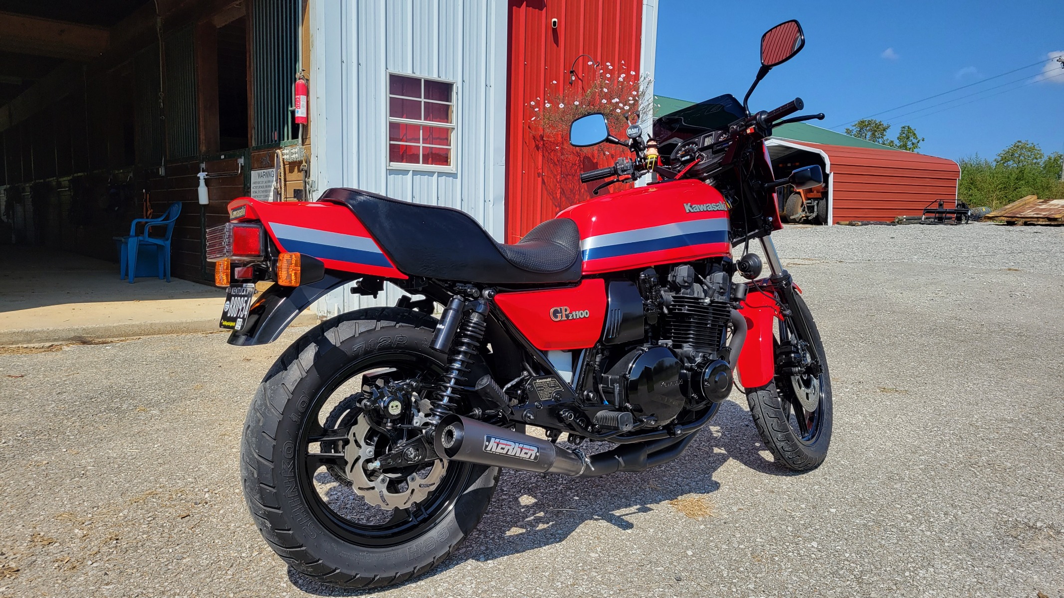

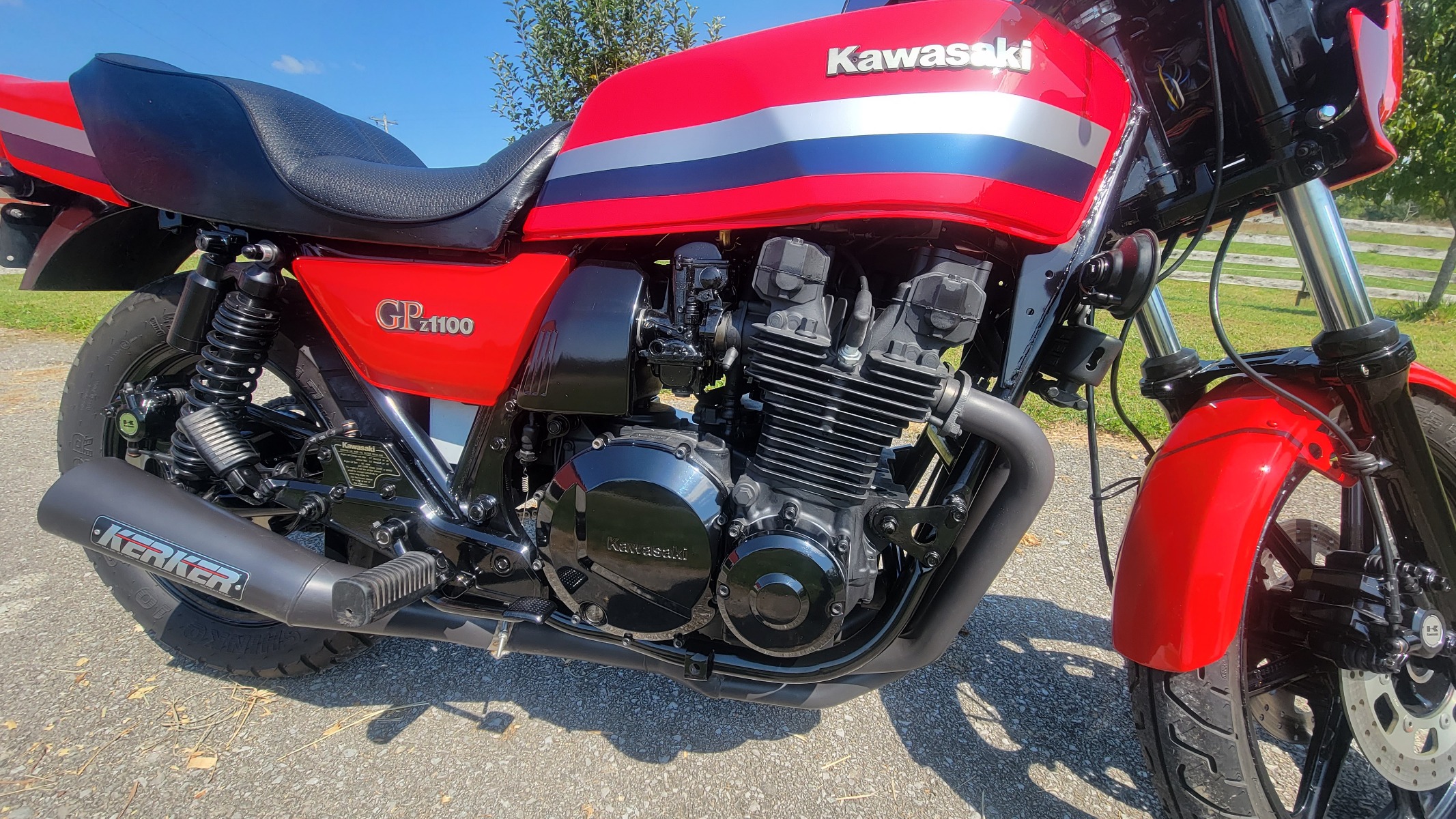

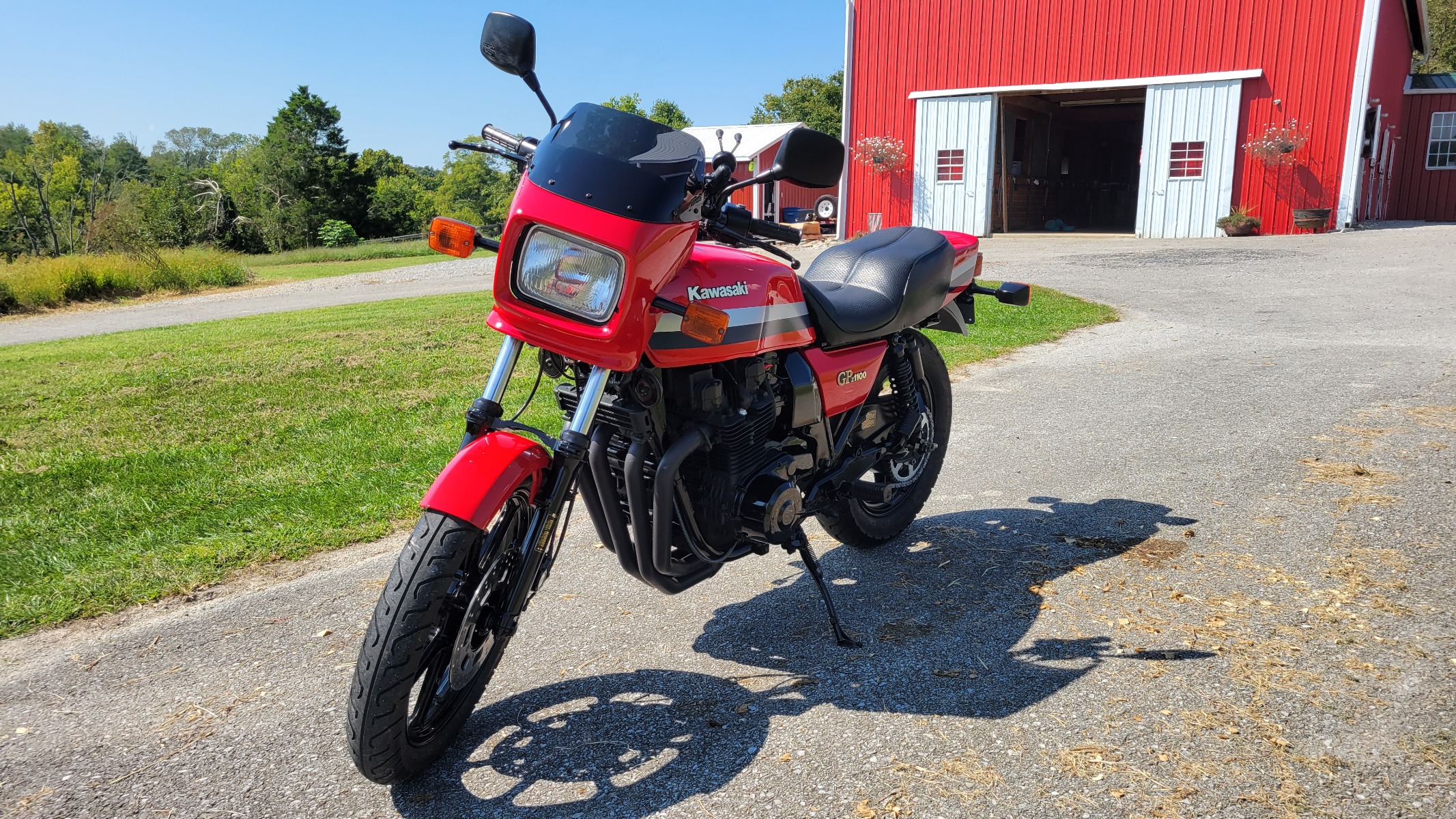

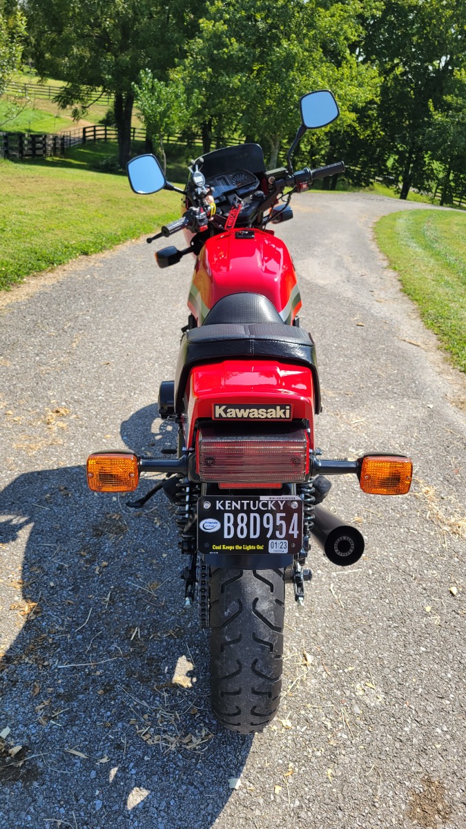

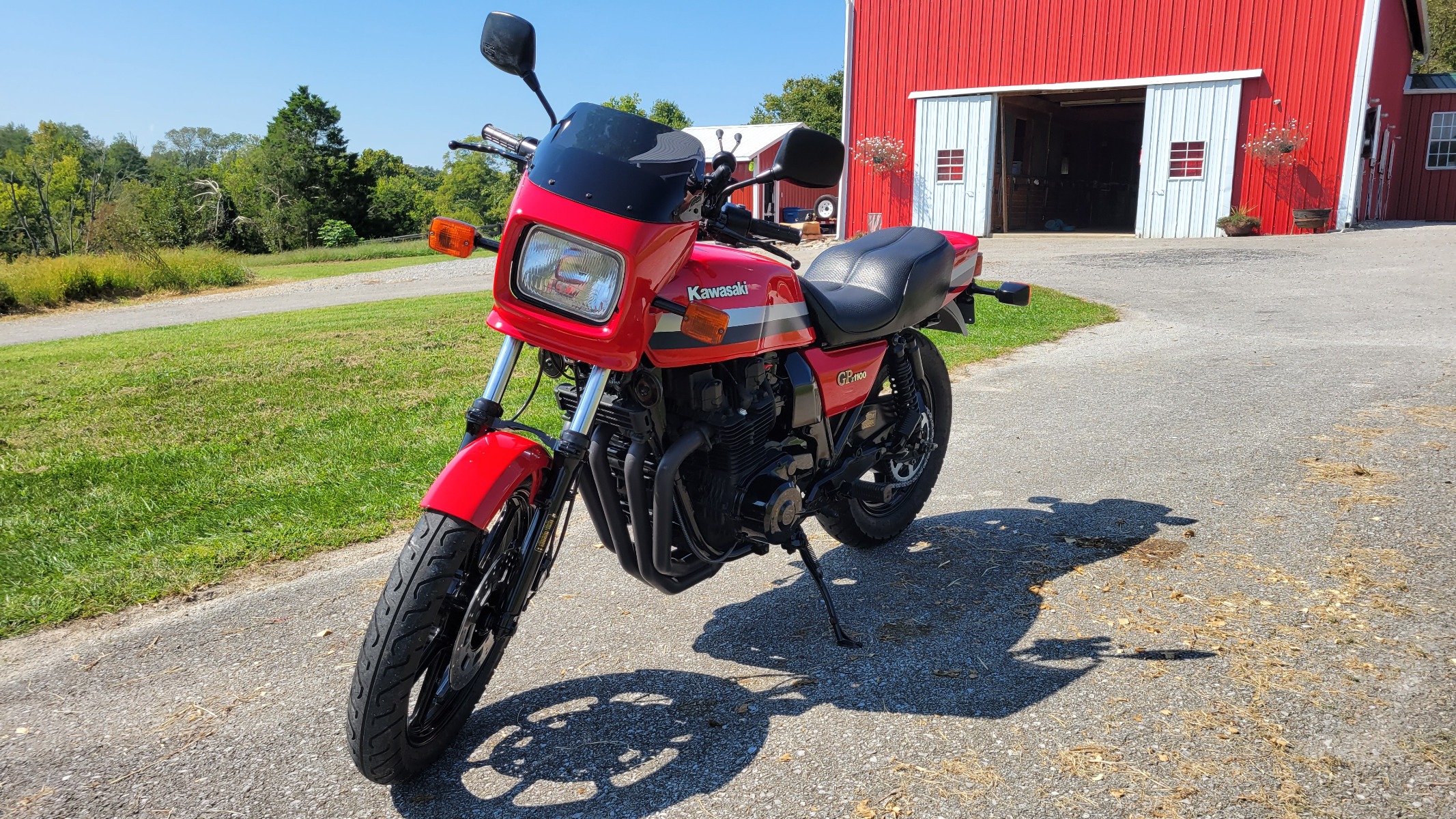

Everything that had any damage was replaced with OEM NOS if available or quality aftermarket if not. Ever bearing, every seal, every piece of rubber was replaced.
Engine is a fresh build with '83 cams, VM29 smoothbores, and the Kerker system. Ignition is Dyna 2000. Progressive springs in the forks, Bitubo rear shocks. 530 chain conversion. 280mm front EBC rotors. Carbs actually have pod filters. Entire rear of the airbox was cut open, I just wanted the side panel for looks. Have both the ELR seat and the original seat.
Still trying to locate a non-cut chain guard and a rear grab handle.

Super nice job on the bike, she is a beaut, well earned.

Great job! Is that a new Kerker exhaust or an older one?
