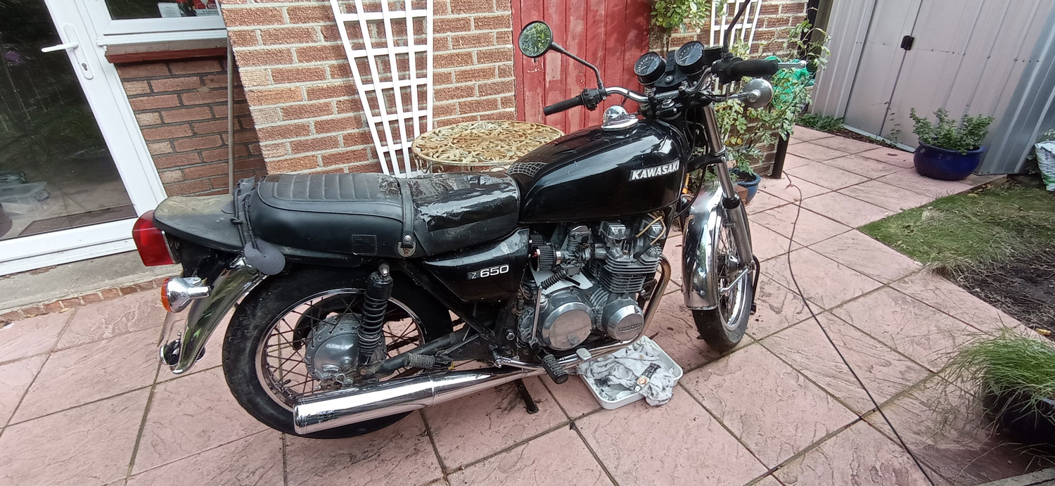

It's finally time to get the old beast back on the road. I've had the Z650B1 (UK spec) for well over 30 years, but it's spent the last few languishing and dead. Too much real life getting in the way.
've decided it's time to bring her out of retirement, so I charged the battery and gave her a kick to make sure there was enough life to make it a viable project. Amazingly, it fired up after just two "dry" kicks and four with the ignition & fuel on ! Then I looked down, saw the last tax disk and realised that "a couple of years" off the road had actually somehow turned into nine years. Ben Inamura makes good engines !
But this is one of those projects where a huge amount will need doing. I'm not looking to make a pretty restoration at this stage, just get to a point of being safely and reliably rideable. The reason she went away in the first place was carb problems, so that's where I'll be starting, and I've already got a couple of questions I'm hoping the experts here can help me out with.....

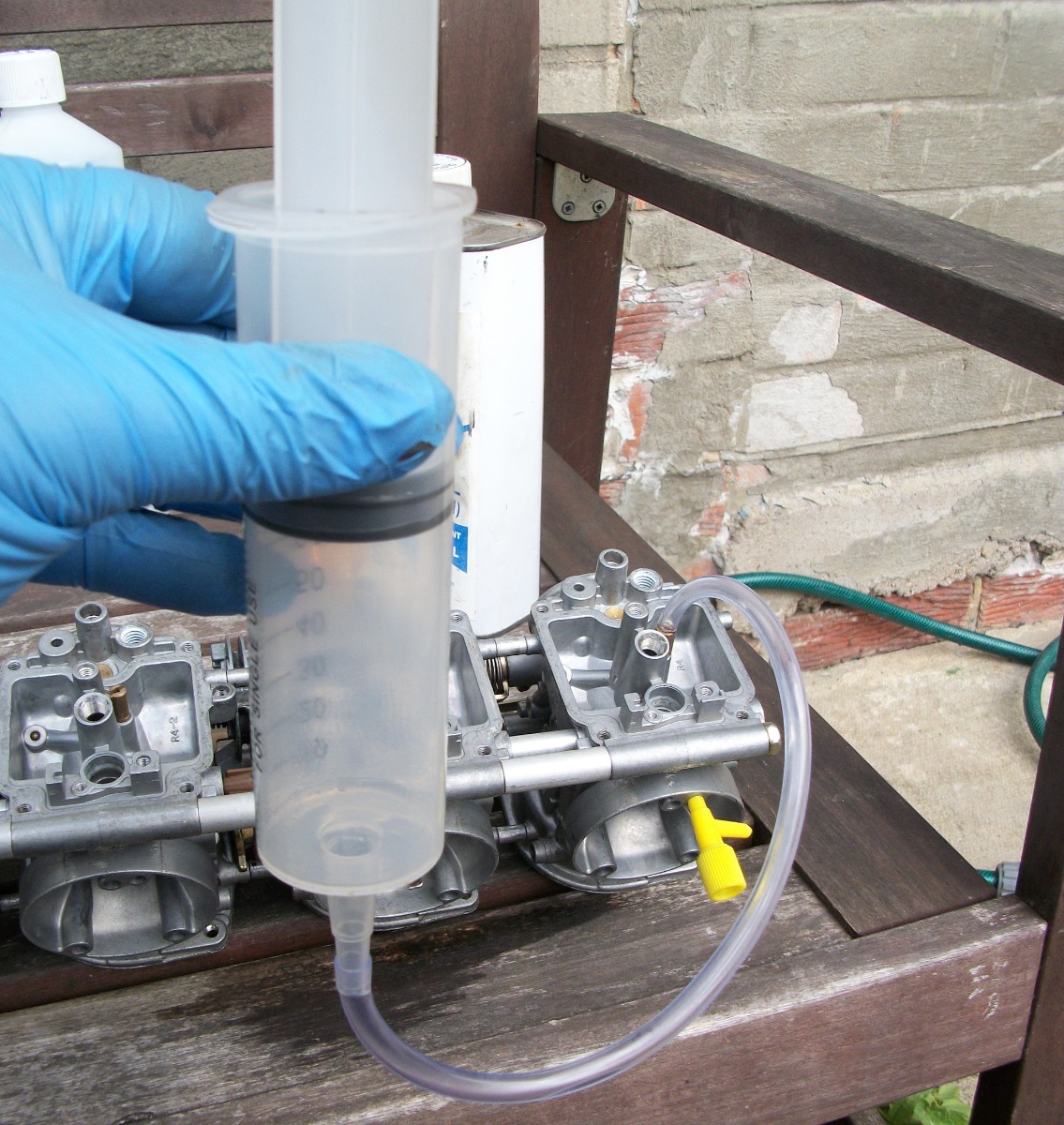

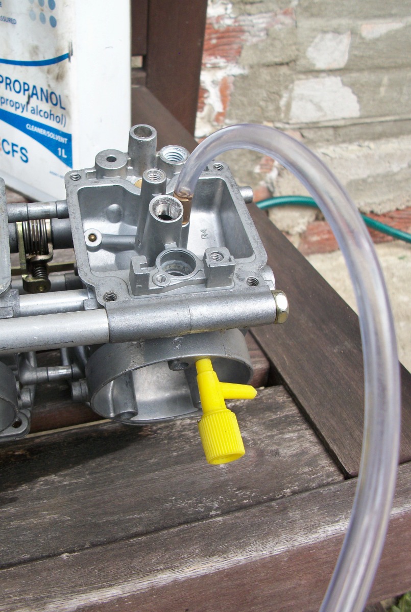

Just thought i would share my carb cleaning method. I do have a compressor but wanted to flush the internals with a IPA.
After removing the jets etc (placed in an egg box labelled 1-4) I got out my large syringe from the brake bleeding box and rigged up a high pressure jet wash with the aid of tubing and suitable plugs.
I blanked the inlet blasted it, then blocked the outlets and blow out again with IPA in the syringe. then as many of the internal bit i could before a blow out with the air line. I try to avoyd carb cleaner cans as they can affect the rubber seals.
the pics are from my Bandit cleanup but same works on the Z500

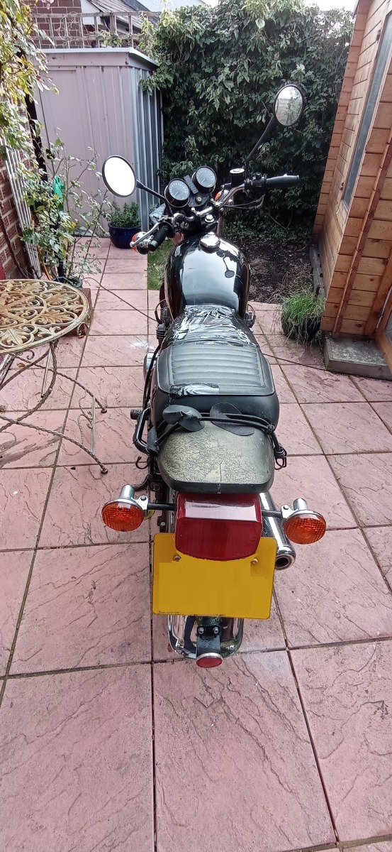

I've popped in a couple of photos, although they make the bike look far prettier than she currently is - it doesn't show the true awfulness of the chrome and paintwork. I've also added one "just because" from a few years ago starring Sooty the Cat when he was still a stray before we adopted him (sadly he's no longer with us.... he was FIV+ with all kinds of other health issues, but we gave him the best life he could possibly have).

Hi Sean! Hello from Virginia in the states...I too have a '78 KZ650B and love it! But I had to comment when I saw your method of cleaning the internals of the carbs with IPA...at first I thought you meant 'India Pale Ale' (!) but then of course I saw the can of alcohol...
But your method is Brilliant! And the carbs look Great! I too have a lot of IPA laying around, I use it to balance the carbs - much safer than gasoline; but I never thought of using a syringe to 'blast' the internals...good job!
