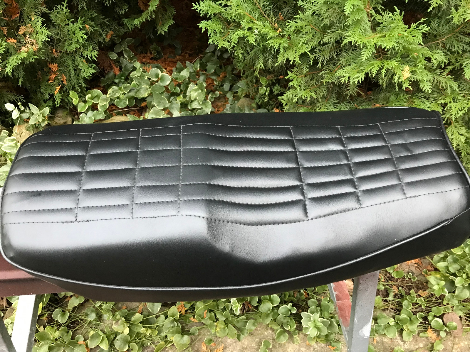

Okay, I got a pic of the seat. And my memory is crap: I was grumbling about the gold-ish Kawasaki lettering on the Pit Replica seat cover, and mine doesn't have any lettering at all. D'oh!
I believe the OEM seat was heat-embossed but this one is stitched, which is kind of nice.
Also the original seat foam was trimmed a bit by a PO.
