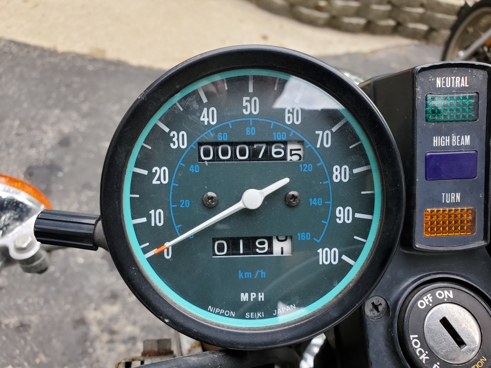

Just Horse-Traded for this beauty, !!!75 miles !!! on her.
But 'Rode Hard and put away Wet'
Quick tank(not orig), carb & plug clean and still running like crap.
We'll see what unfolds with digging through the Shed Queen Resurrection process.
