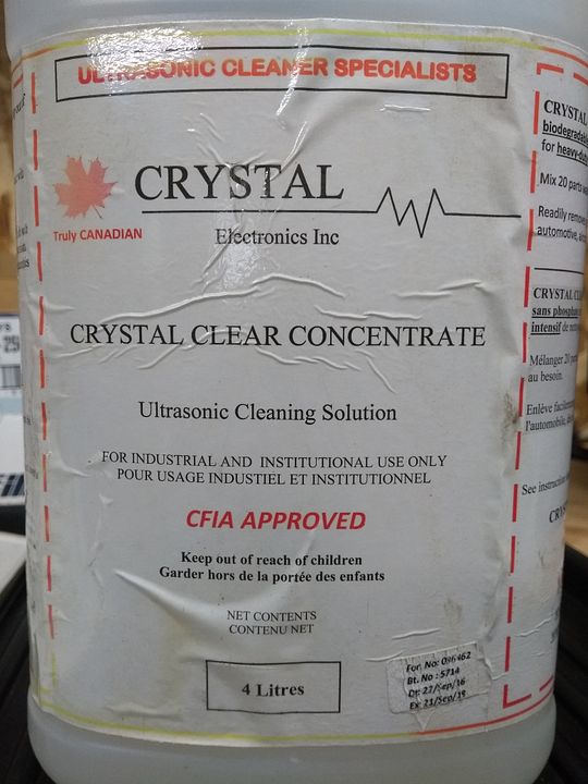

Welcome Jason.
You can use dish soap, Simply Green or other cleaners in an ultrasonic cleaner.
Heating up the solution with the machine if possible helps.
Some penetrating oil, and an impact driver for stubborn screws.
JIS screw drivers and bits recommended for the screws on these KZs.
Last set of carbs I cleaned I used some solution my buddy had.
Worked really well:

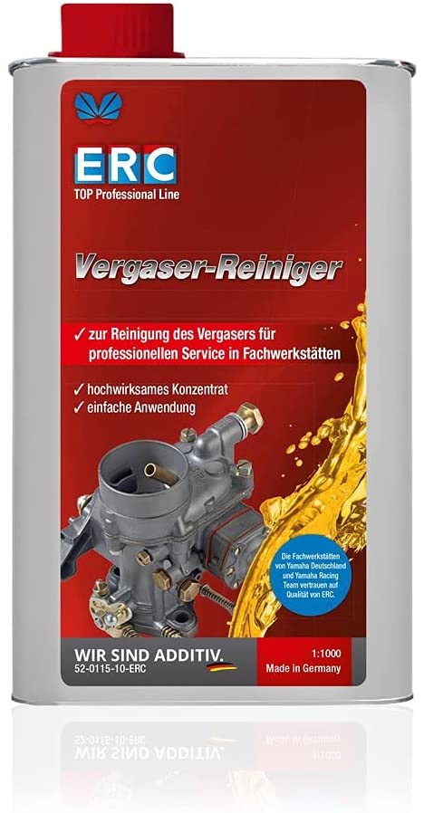

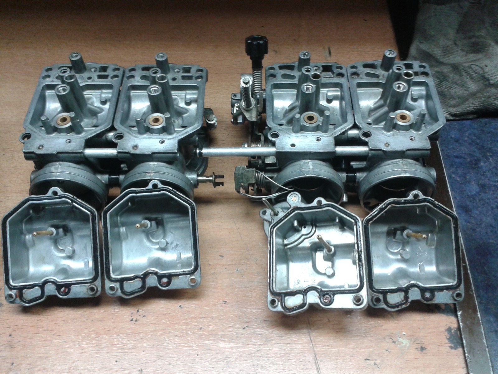

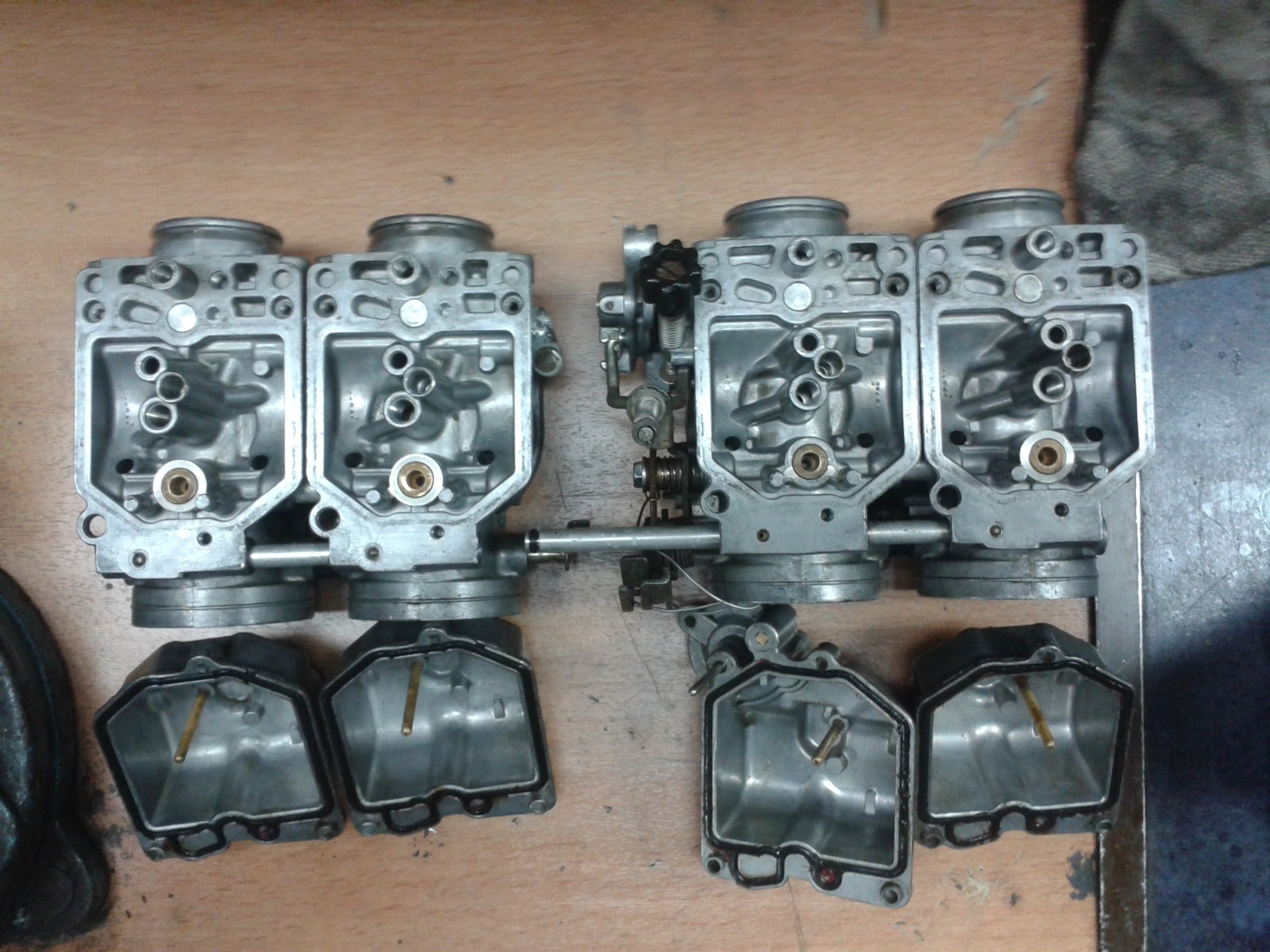

Hello and welcome. Yor pics didn´t show´n up here,(need Google account).
For the carb clean i used a automotive carb dip like ERC carb cleaner (50/50 fuel mix) and re-useable. Brass parts comes out of the bath like new.
Ultra sonic cleaning is not the ultimate weapon to clean carb parts, some chem tech is more powerful like the classic Yamaha carb dip...., just my 2 cents.
www.amazon.de/ERC-Anwendung-professionel...id=1619826907&sr=8-2
