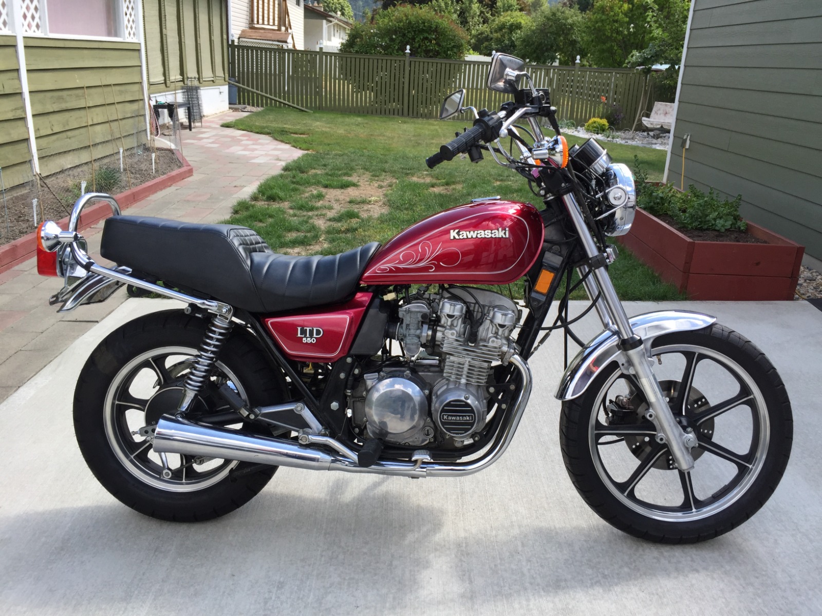

I really like the KZ550. The photo below is my wife's 1980 version. Mostly original except for the colour and a slightly modified seat.
The rear signals were moved to accommodate some small saddle bags. We picked it up a few years ago and rebuilt it over a winter. She has since purchased a DR 650 so this one doesn't get ridden very often. It's a bit too small for my 6 ft 3 in frame. I hope yours eventually returns to its former glory.
