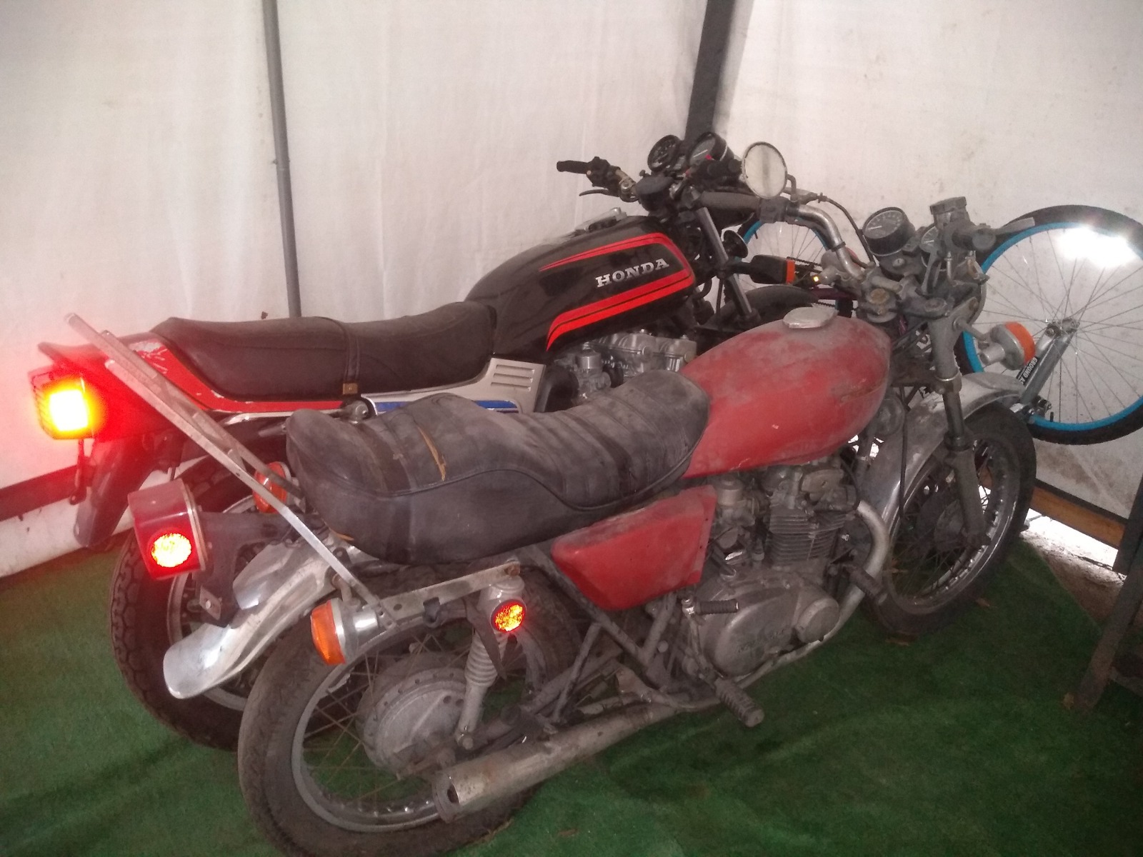

Hello Everyone,
Nice to meet you all. My son and I took a road trip from CT to PA to pick up some motor bikes. We landed a 1974 KZ400 for $70 and an 82 cb750F for $120. Both bikes are complete. The plan for the KZ will be similar to the "Brown Bomber" by Moto-Fied. It will be a dual sport stunt bike scrambler. It will get stripped down to trail essentials only. Not sure if It will get front blinkers but an LED hoop will light out back. Custom seat and motor cross handle bars and some adjustable rear shocks. Pods and lithium battery. LED front light, new grips, cables, brakes and fresh engine clean up. Frame will get POR15 from the spray gun.
This bike will eventually be for my son so the plan is to get him to build most of it.

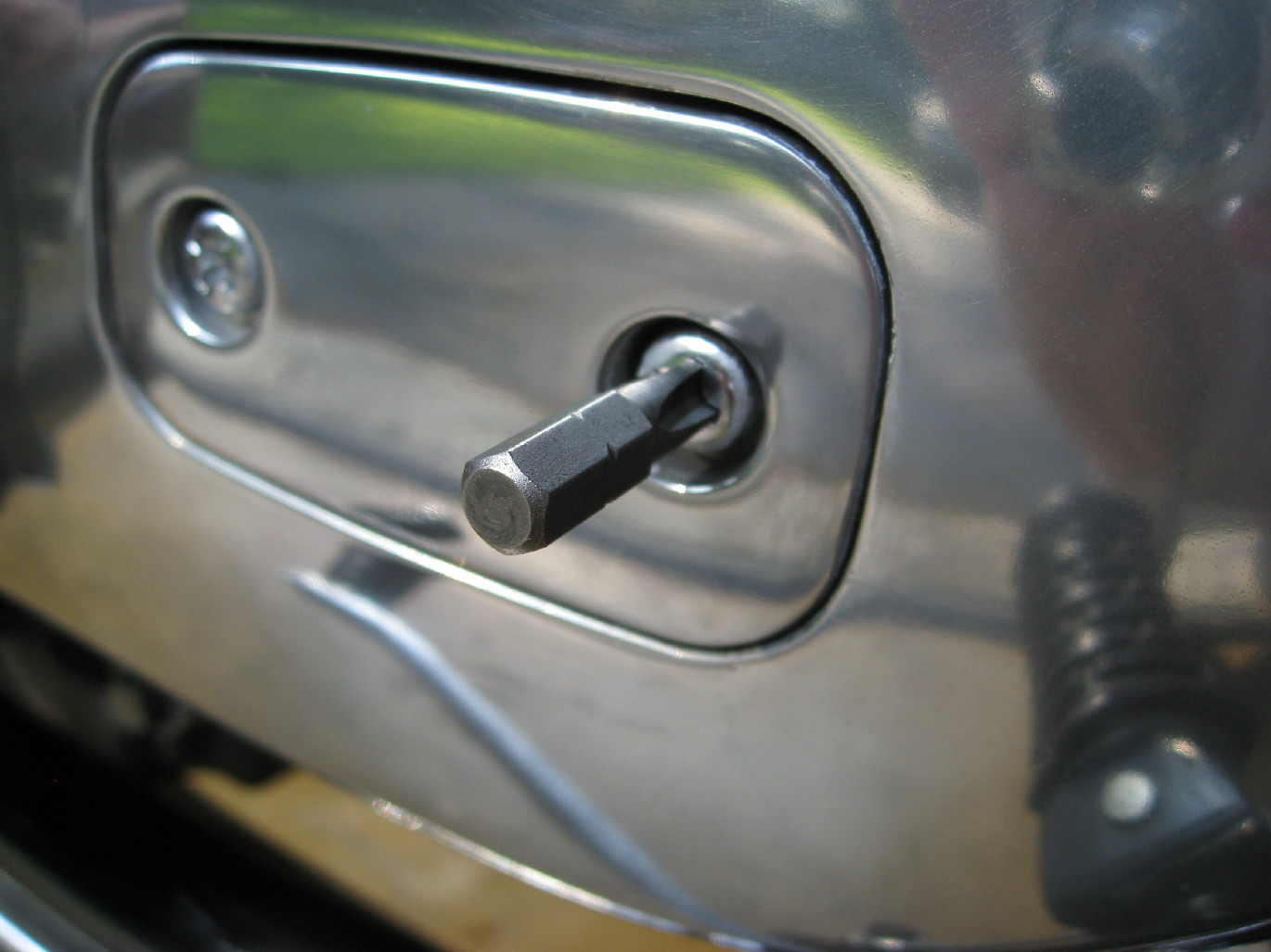

Welcome aboard! Just in case you're not aware; the screws on the Kawasaki that look like Phillips are not Phillips. They are Japanese Industrial Standard (JIS) and using a Phillips screwdriver on them will damage them. You can modify Phillips screwdriver tips so they work fine on JIS screws. If you need more info just ask. Ed

650ed wrote: Welcome aboard! Just in case you're not aware; the screws on the Kawasaki that look like Phillips are not Phillips. They are Japanese Industrial Standard (JIS) and using a Phillips screwdriver on them will damage them. You can modify Phillips screwdriver tips so they work fine on JIS screws. If you need more info just ask. Ed
Home Made JIS Tip
Thanks 650ed! I have a kit I picked up from the parts store that includes maybe 5 different cross head bits. Some have a more blunt tip that the others. Not sure about the angle between crosses but I'll keep your information handy!
I found that by simply filing off the end tip of the Phillips bit I could get the bit to properly fit the JIS screws. If you decide to do this just take your time and test the screwdriver bit often until it fits perfectly. I own some actual JIS bits I bought from Vessel Tools, but the ones I made actually fit the JIS screws a little better than the ones I bought. Ed
