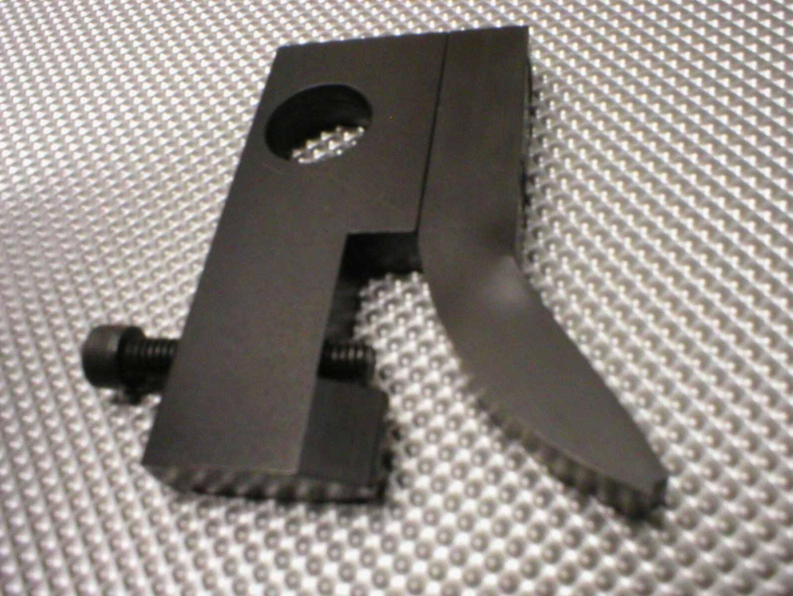

As for shims. You will have to check them, if they are out of spec then the only way to change lash is to find out what size sim is currently in that valve bucket and look at the chart in the manual. It will tell you what shim size to use to correct lash. Then you can hunt evilbay for the shim recommended from the chart. Only use OEM Kawasaki shims. Also check with your local Kawasaki dealer. If you get the right service guy they might be willing to swap shims with you.... Rick H turned me on to that lead. I got cozy with the parts guy and asked him, he said sure, they have draws full that no longer get used. But they don’t sell them but will trade you for the size you need. One for one.
When you pull the shim off the top of the bucket the shim size will be on the bottom, it’s that way so the size isn’t rubbed off by the cam lobe. DO NOT rotate the engine without a shim in place.
This is the tool used to replace the shim.
