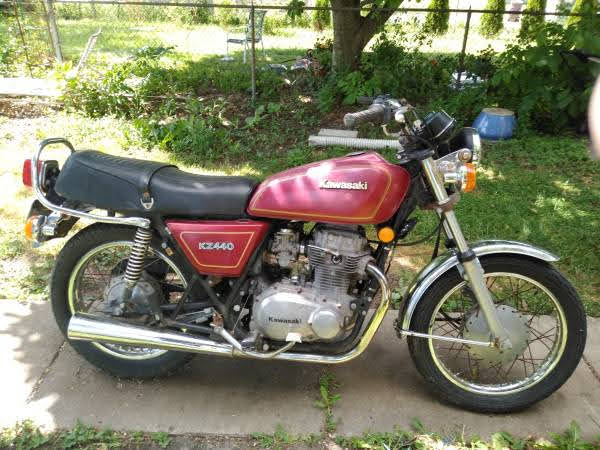

Hello All! New Member, Just Purchased this 1981 KZ440B(2?) for $400!! Couldn't pass up that deal. Super Excited to have a second bike to keep stock! First bike is a 1975 CB360T that I fully tore down and customized brat(ish) style. I'll post pics of that too if ya want.
So the KZ starts up and runs, but it backfires out the intake quite a bit. I checked the carbs for air leaks (they are good), checked the float lvl (good), inside of carbs are clean, valve clearance is within spec, spark plugs gaps are good. Checked the points and found out this model has electronic ignition, so not sure how to check if that is good. On the list I still plan to rebuild the petcock once the kit comes in, for now I just keep it on Prime just in case and it is flowing. And I'm going to fidget with the Primary Pilot screws. I'll try to upload or link a video of it running soon.
Any other suggestions are appreciated as I'm only familiar with my CB360.
Thanks in advance ya'll!
