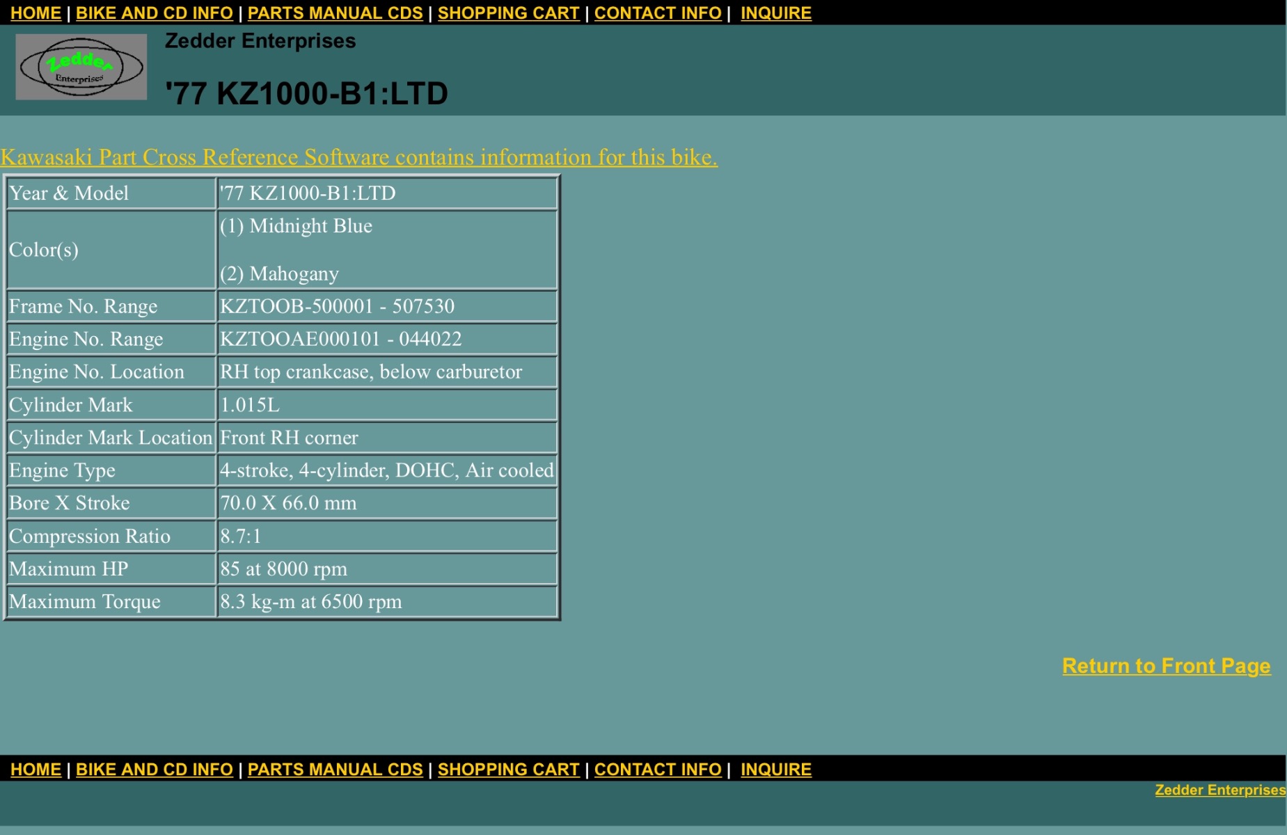

I was given a Kawasaki that belonged to her husband. He is dead now. Anyway, I have the VIN, but it is odd. It is KZ T00B-502861.
I have been plugging that number into a lot of different places but can't get anywhere. Also, I don't have the key(s) either.
Help
Bill

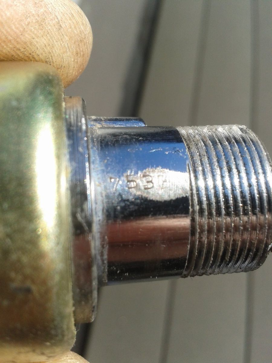

Look at the seat lock for a key number code...check under the lower triple tree for the steering head lock, should be the same number... you can search evilbay for a key

The ignition key is 194. The seat is761, I think. It is hard to see.

03 Jul 2020 13:49tssywfb wrote: The ignition key is 194. The seat is761, I think. It is hard to see.
Just a thought.
Could it be that 761 viewed upside down might just be 194?
