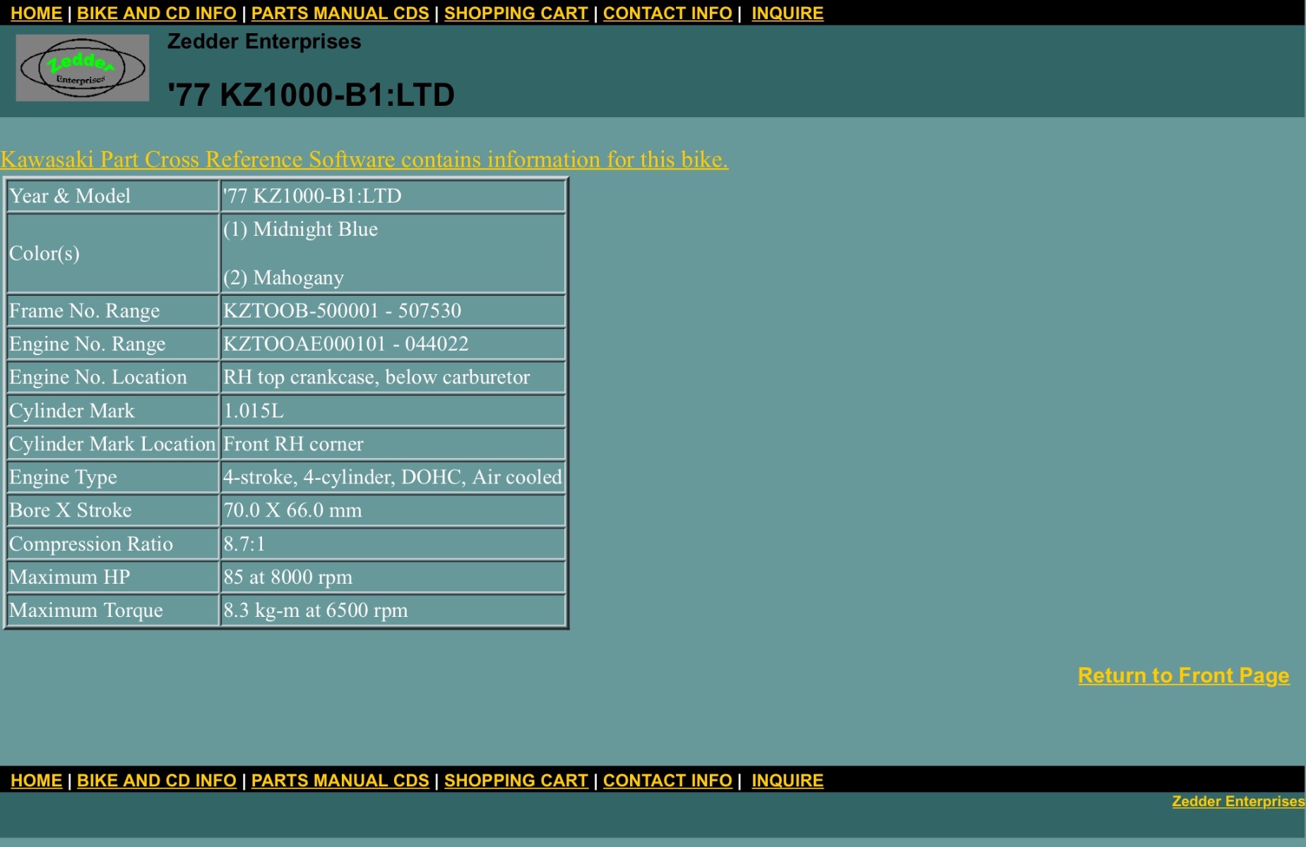

1977 Kz1000 LTD B1

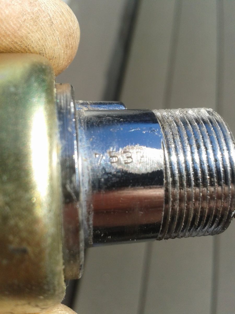

The ignition key is 194. The seat is761, I think. It is hard to see.

tssywfb wrote: The ignition key is 194. The seat is761, I think. It is hard to see.
Just a thought.
Could it be that 761 viewed upside down might just be 194?
