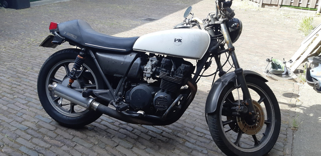

I bought the first kz for a few bucks(euro's actually), wasnt running, battery dead, leaking carbs and a rusty forks, i fixed the engine so its a runner now. So i searched for parts to get it back on the road and maybe turn it in to a brat or something like that. I'm a little experienced with builds, i have build a few caferacers, but all honda. I found an interesting bike, a project that was never finished and doensn't run. new paintjob marchal exhaust, monoshock, modern z650 wheels, a kz750 engine with a zephyr head and did i allready mention it? it doesn't run(OMG wat did i buy?). I have learned never to buy an old stranded project because you never know what problems you might encounter, and yet i was stupid enough to fall in love with the looks and ended up with 2 zx650's in my garage.
So, here is my first bike:
And here is the second bike, purists might want to look the other way to avoid an allergic reaction:
Now here are the problems, the rearsprocket does not line up with the frontsprocket, an offset sprocket might do the trick, but it will be close because of the 180 tyre in the rear, im affraid the chain will hit the frame. The previous owner never got it running, might be electrical, compression or timing issues. Maybe get the engine from the first bike as a donor, but first i'll be doing an attempt to fix it.

For the chain clearance, try a 160 tyre. If thats not enough, you might be able to shave a bit off the sprocket carrier. I picked up an offset front sprocket from Nico Bakker
( hes up north around Heerhugowaard). Also good for any other machining you might need. He straightened and braced my frame.

14 Jun 2020 02:23Thats great advise, thx. I know nico Baker I've had a nico Baker gsx before. I'll give him a call for that. The 160 tyre will give some clearance and might just be enough.davido wrote: For the chain clearance, try a 160 tyre. If thats not enough, you might be able to shave a bit off the sprocket carrier. I picked up an offset front sprocket from Nico Bakker
