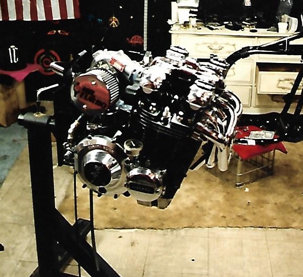

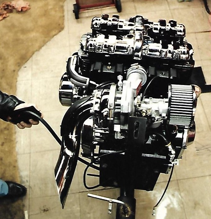

Oh , The Hell with the rules , and normally aspirated !!!!
Lets put a nice Turbo motor int that little racer .
