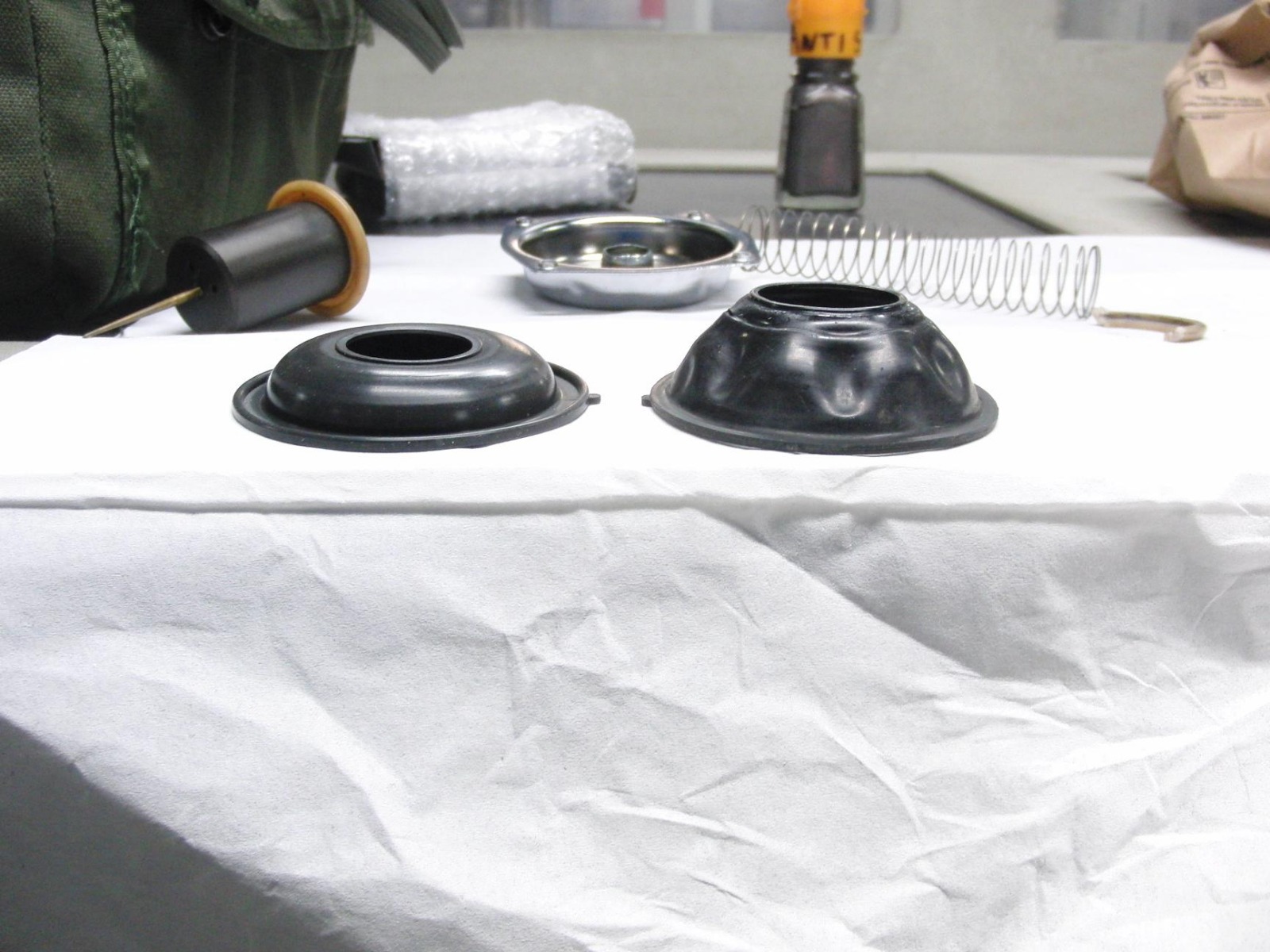

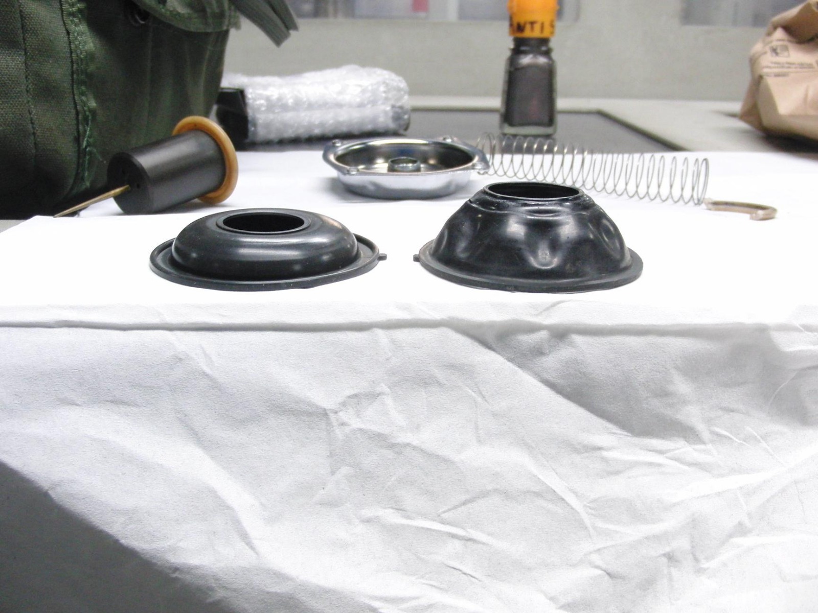

The 78 B1 uses the later 400 carbs. I forgot 78 was split year. (The 78 A2 still used the older carbs.)
JBM's 72mm diaphragms have the center too big. The early Kz400 diaphragms need a 23-ish center.
I tried some 72mm / 23mm boots from a Honda. They fit the carbs, but didn't allow enough motion. The "dish" was too shallow.
Honda on the left. Kz400 on the right.
Good luck with the install!
