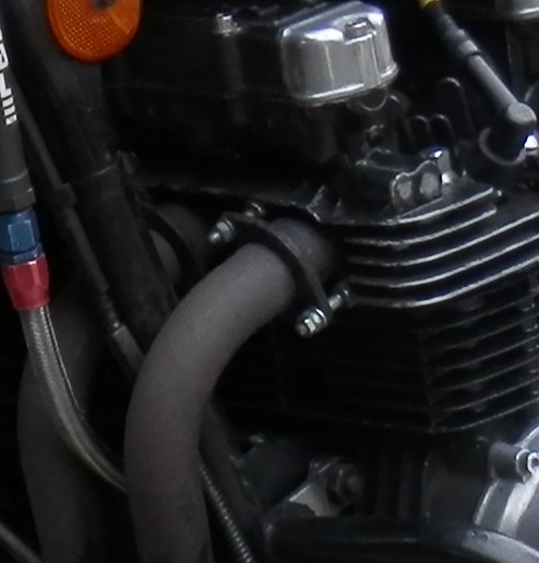

The Exhaust is a aftermarket 4 into one. The far right side (when sitting on the bike) has a pretty nasty leak and is making a decently loud slapping sound. The flanges are warped and the bolts/washers are pretty weak as well as the exhaust studs are bent a little, especially the one that has the leak. To address this I figured the following parts from Z1 might help:

"The Exhaust is a aftermarket 4 into one. The far right side (when sitting on the bike) has a pretty nasty leak and is making a decently loud slapping sound. The flanges are warped and the bolts/washers are pretty weak as well as the exhaust studs are bent a little, especially the one that has the leak. To address this I figured the following parts from Z1 might help:
Billet Exhaust Flanges
New Lock Washers
New Flange Nuts
New Copper Exhaust Gasketsß
New 6mm x 27 mm Exhaust Studs"
Regarding the exhaust please post a photo of the exhaust and problem flange.
Click Add Files and select your photo.
Place the cursor where you want the pic in your reply
Click the Insert Button directly below selected attachment.
The reason I ask is because the issue you describe is known with some MAC exhausts. I had one. On mine the flanges were relatively thin and soft and it took very little torque on the flange/stud nuts to bend the flange, distort the studs and cause an exhaust leak. I replaced the studs but found it impossible to straighten out the flanges as they are not removable from the header. Check my photo below before you spend money on flanges that may not fit if your system is a MAC.
