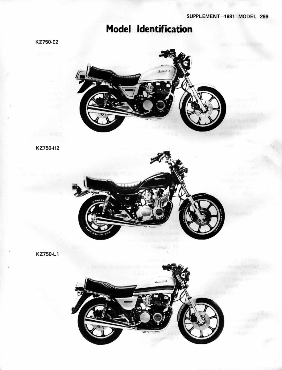

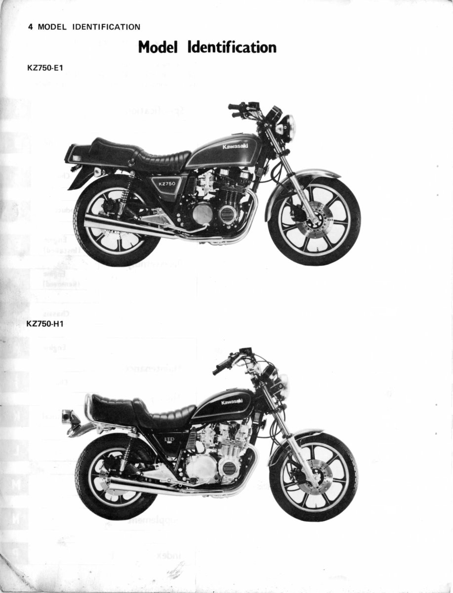

Re: 1981, KZ750 LTD in Cape Town, South Africa
09 Dec 2019 09:02
Hello and welcome SideArm66
as martin_csr suggested the Service Manual in the KZR database covers both 750-H1/H2 bikes.
kzrider.com/modules/ServiceManuals/GPz750.pdf
