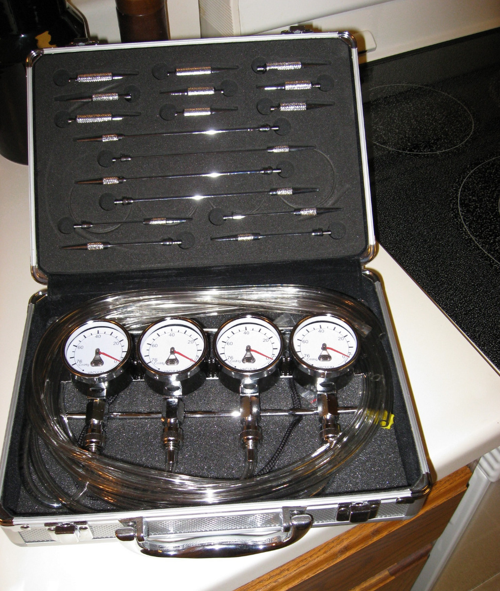

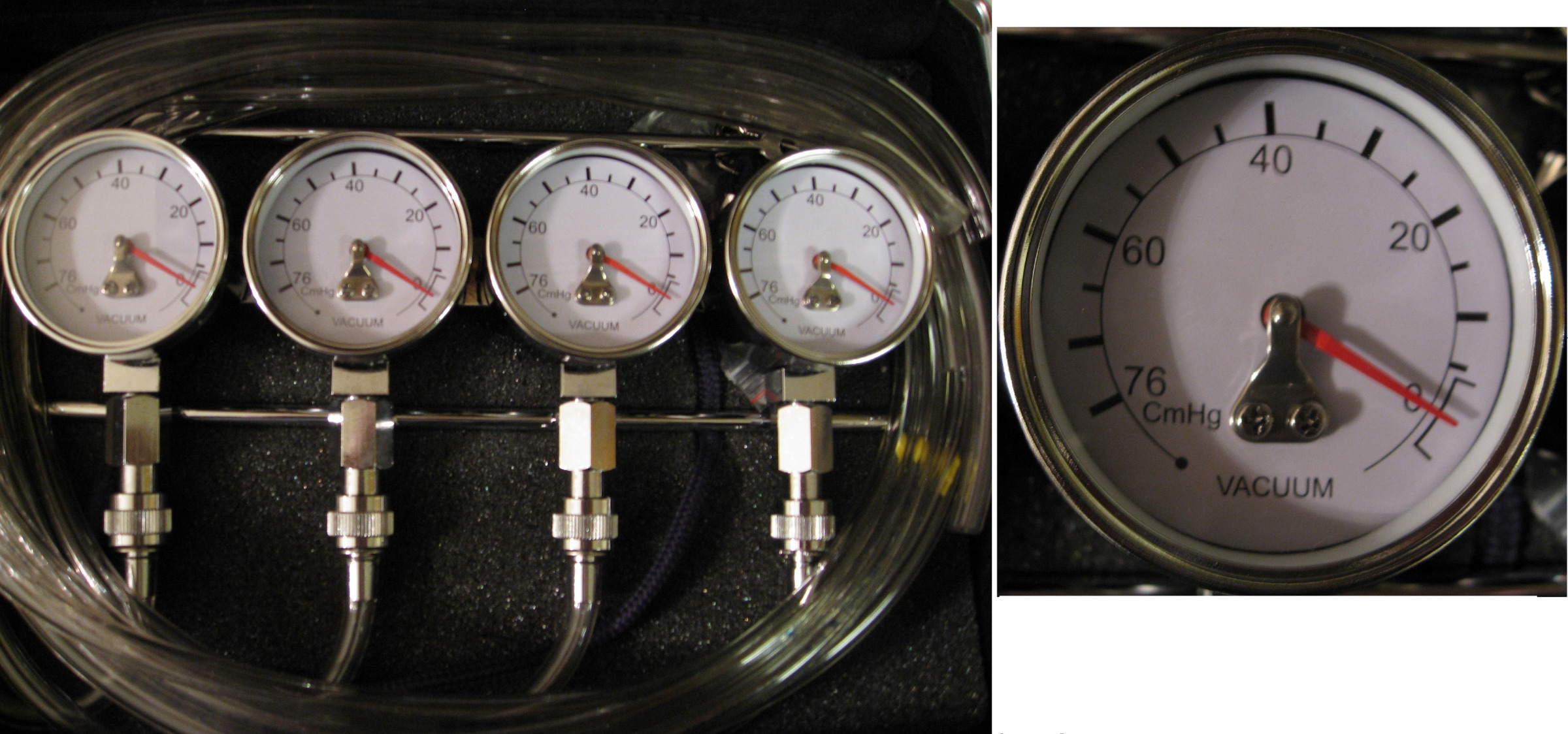

Here's what I use to sync my 1977 KZ650 carbs. These gauges work great. Earlier I had a slightly cheaper set of gauges, and one of them was crap,so I got rid of them. Ed

Dang 650ed, those gauges are nicer than my bike... Sure put my carbtune pro mercurys to same... where did you get them???
- Thanks: 2833
Re: New Owner of KZ650
04 Oct 2019 20:03 - 05 Oct 2019 06:26
A friend gave them to me when he sold his bike.
I think they are sold by K&L. Ed

I couldn't find them on the K&L website, but it looks like Z1E sells a similar set.
www.z1enterprises.com/vacuum-gauge-set.html
