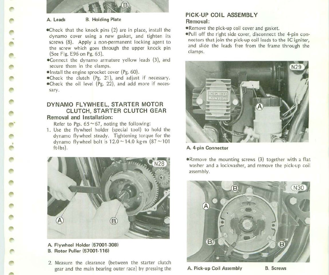

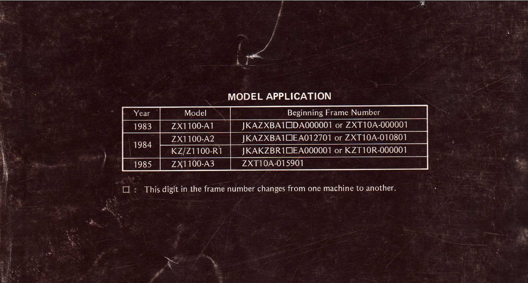

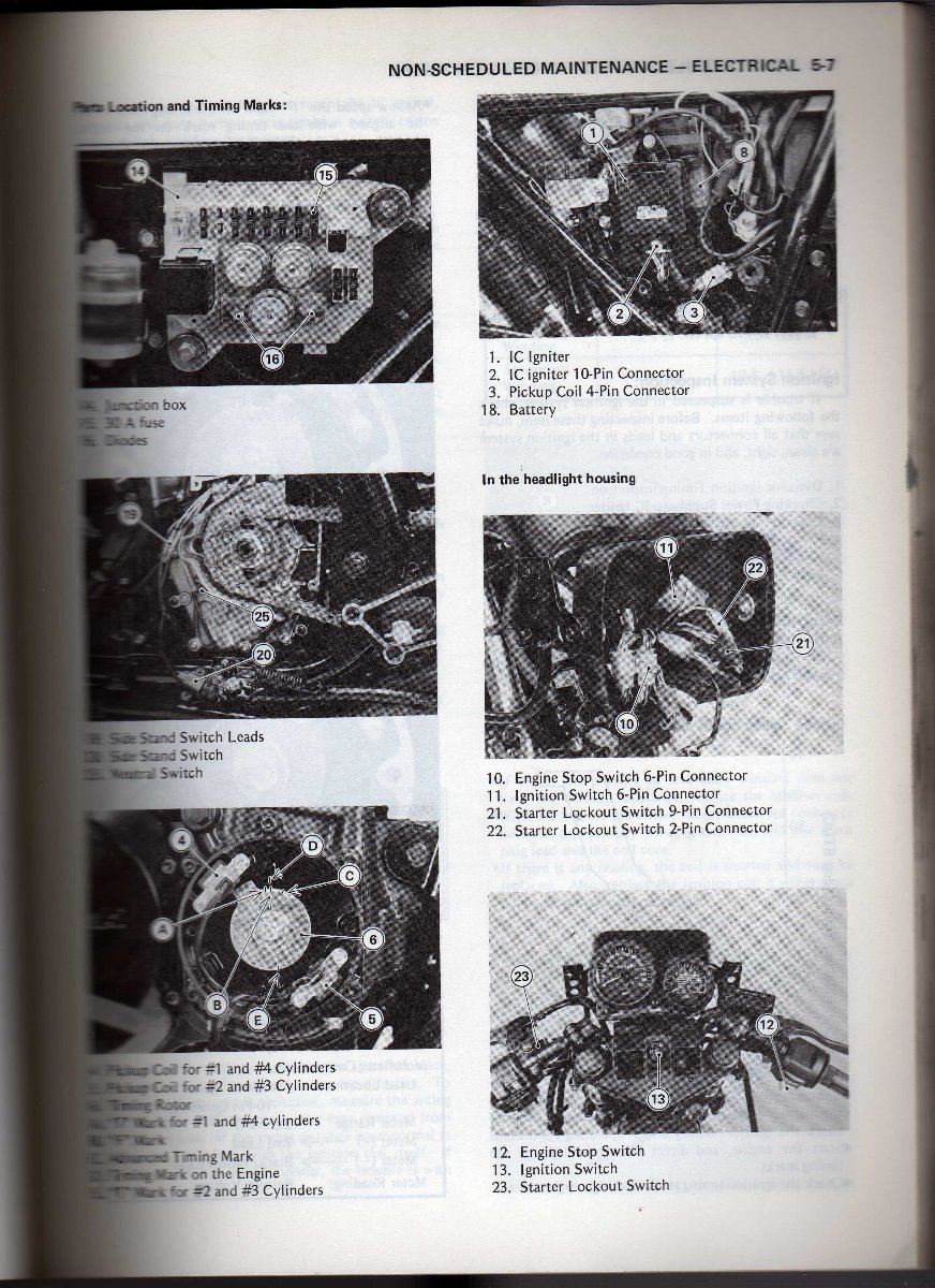

Your ZN1100B ignition is like the GPZ1100UT (ZX1100A) with two picup and no advancer = Special igniter box.
Earlier KZ1000 ignitions with two picups and advancer need a diffrent ignitor box.
ZN/GPZ1100
KZ1000 79/80

If you look at the pics i have uploaded the picup positions is diffrent . so you have an diffrent ignition Timing . But you must have a spark anyway. This is he question i can´t answer at the Moment. I can´t see a pic of the earlier ignitor you Need for your current picup.

The older style ignition uses pickups mounted to the timing plate as shown. The older ignitions all can use any of the first Gen igniters... The tall one or the square ones... They work the same.
Most, if not all, later style motors can be retrofitted back to the earlier style ignition with a simple bolt-on or slight mod.
