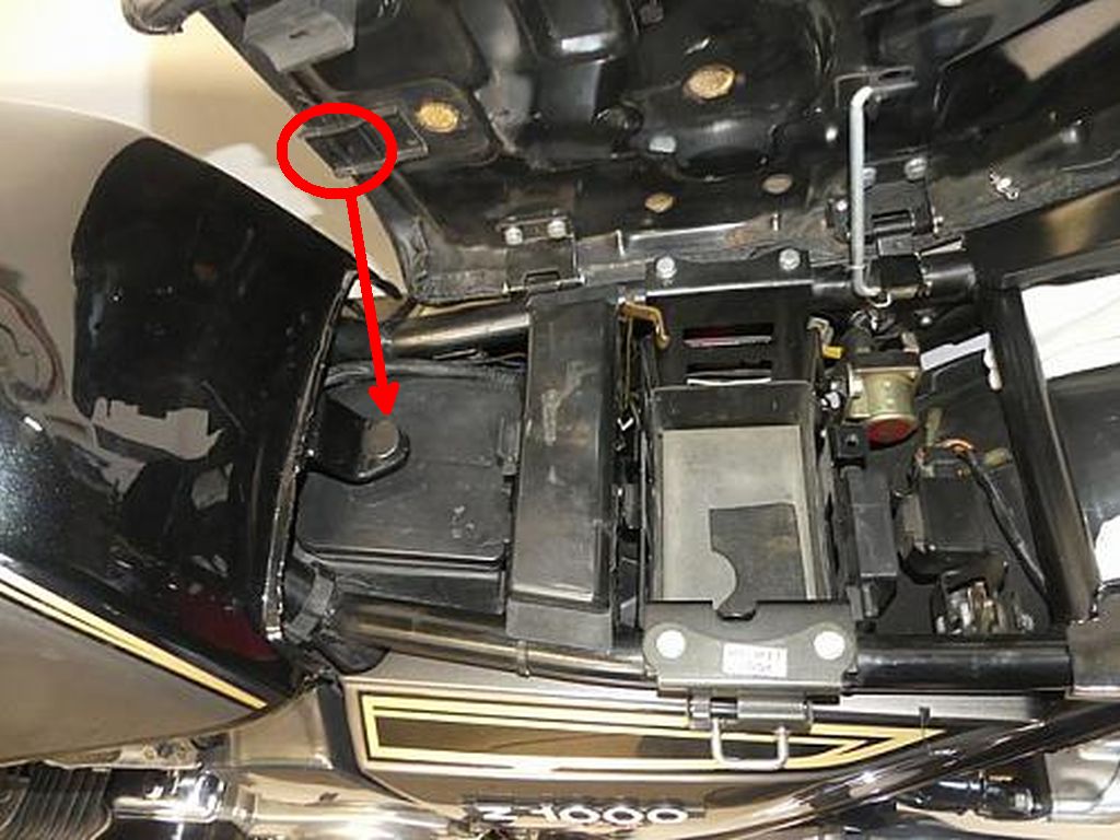

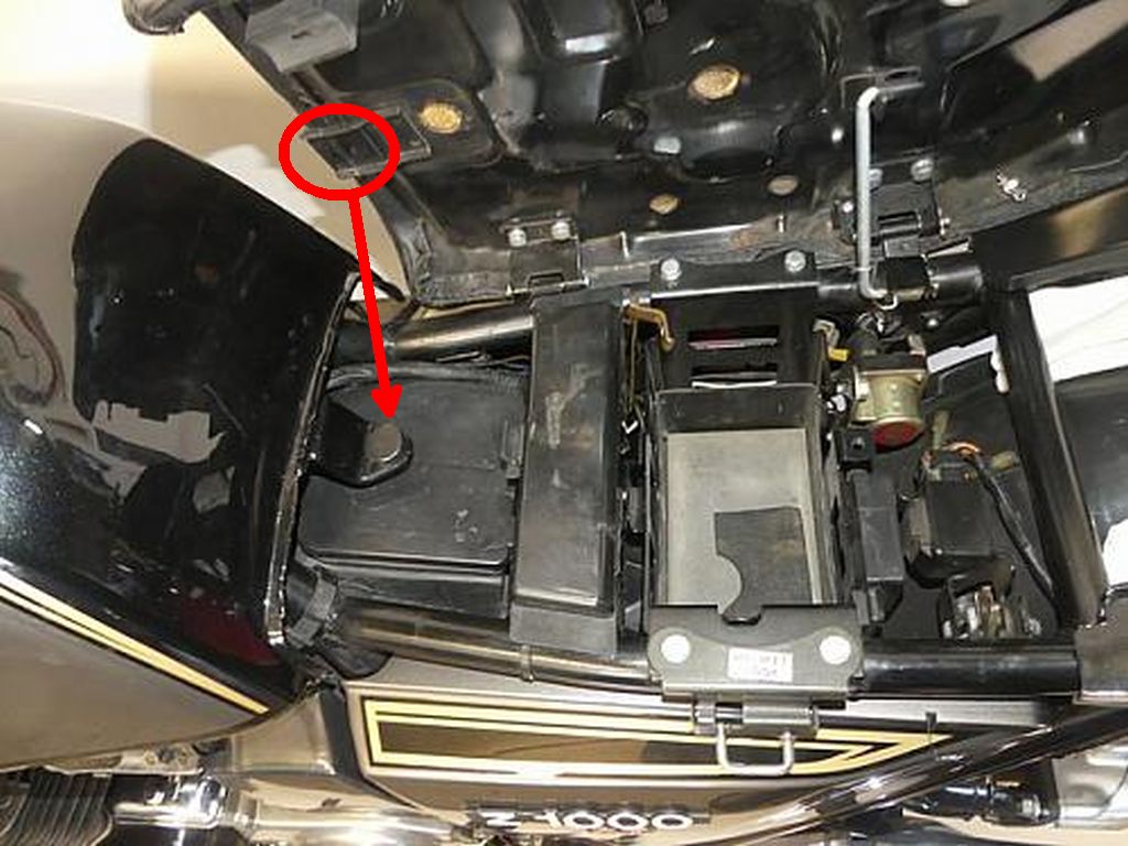

I'm not sure how the fuel tank is meant to be secured at the rear. Does it have a strap to secure it similar to the Z1 and if so where does this attach to?

If you close your seat the flap on it will press on the fuel tank tab and secure the tank.
www.forum.z-club-germany.de/viewtopic.php?f=133&t=5133
