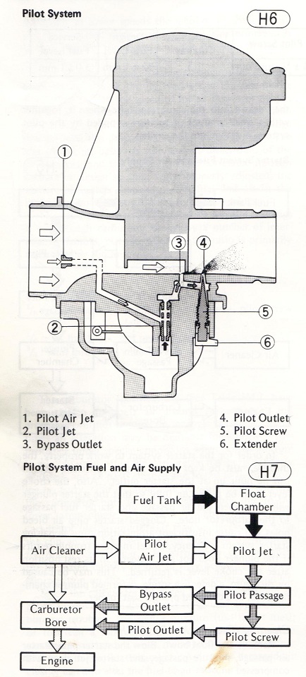

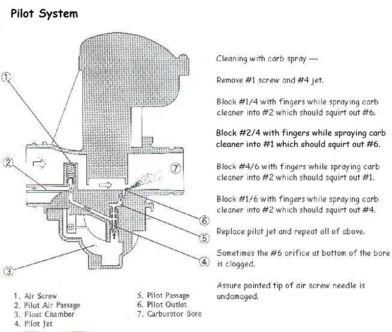

I suspect that the pilot circuits are not yet perfectly clean.
Wear eye protection while spraying carb clearer because the spray always backfires. ALWAYS .
Pay extra careful attention toward cleaning the orifice into bottom of the car bore (number 6 on the following diagram).

The carbs at hand may have the pilot mixture screw instead of the "pilot air screw "as shown in the earlier diagram.
Both style carbs have an orifice into the carb bore.
