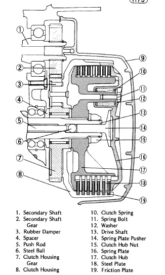

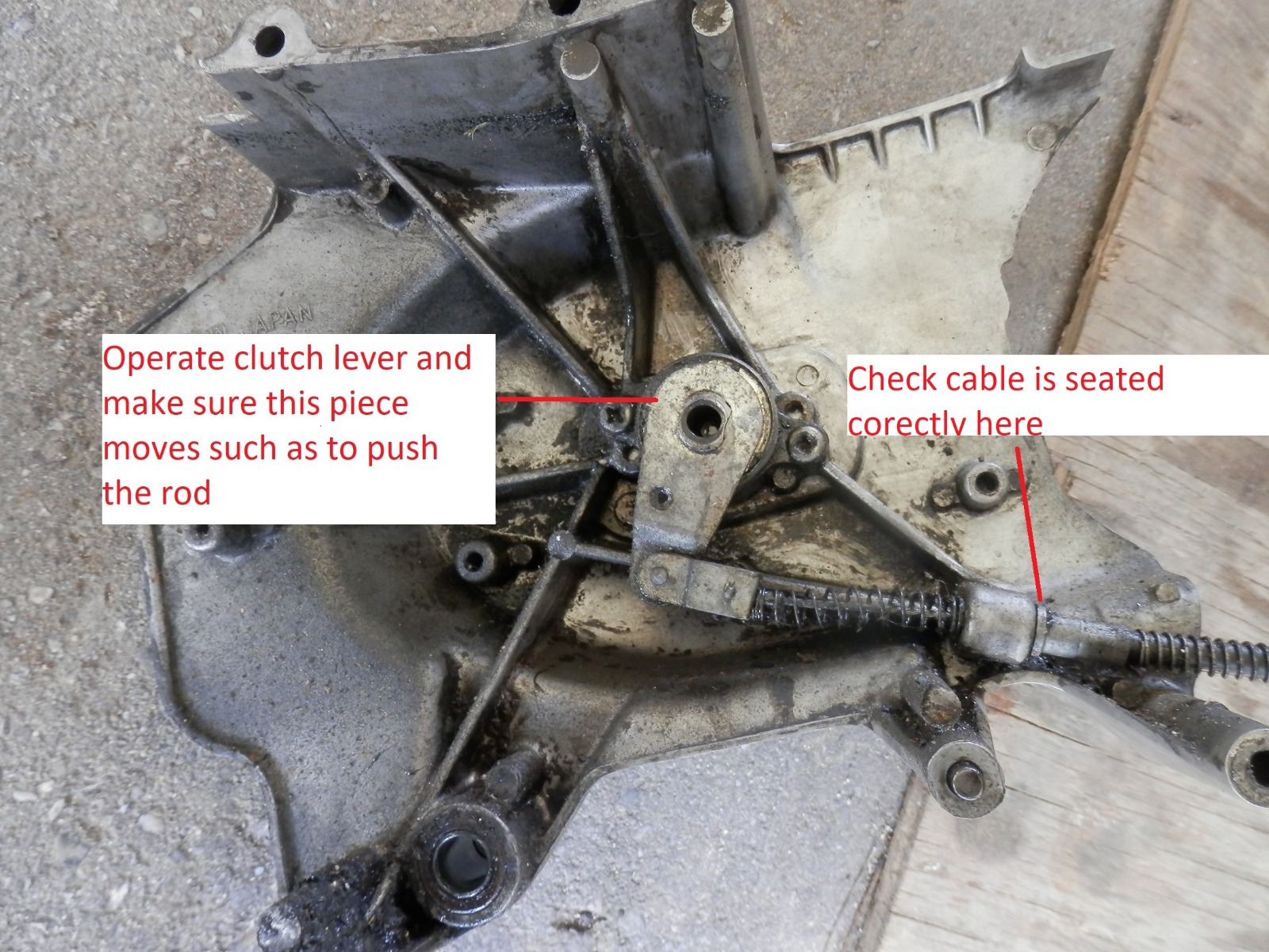

Your engine is pretty much the same as mine. The clutch problem is likely something simple.
Take off the left side engine cover and check is the cable is seated correctly and the mechanism working as it should. You may have to remove the mechanism, clean, grease it and put it back. It has a ramp type mechanism.
See first pic
While I have never opened the clutch side I dont believe the ball which the clutch pushrod pushes against can fall out on the rod side. Its to big
See second pic

Hey thanks for the pics! That little piece moves with the clutch push rod. Seems to be operating fine. I'll clean it and relube it as suggested. Cable is seated properly as well. I'd like to also state that I rode the bike around town prior to changing the clutch cable. It was engaging and disengaging fine.

Did anyone remove the clutch? There's a steel ball that can go missing.
Make sure the clutch release mechanism is cleaned, lubricated & operates normally. and is oriented correctly & properly installed w bolts securing it to the engine sprocket cover. make sure the clutch cable is properly routed & seated into the engine sprocket cover and release mechanism. one little goof & it won't work. Be sure to install a small cotter pin so that the cable end remains seated. When reinstalling the engine sprocket cover, I like to maintain tension on the clutch cable so that the cable end remains seated. Also, I place the engine sprocket cover on shipping boxes beside the motorcycle so that the clutch cable doesn't get kinked or anything. and so the cover doesn't get scratched.

To refresh, I rode the bike home from the previous owner's residence. The clutch lever was INCREDIBLY tough to pull. I found that the old cable was kinked. I have not tried touring the cable back to its original positioning. I didn't think it would have that much of an impact. I will also assure that the cotter pin is secured. Will update when the weekend comes around.
