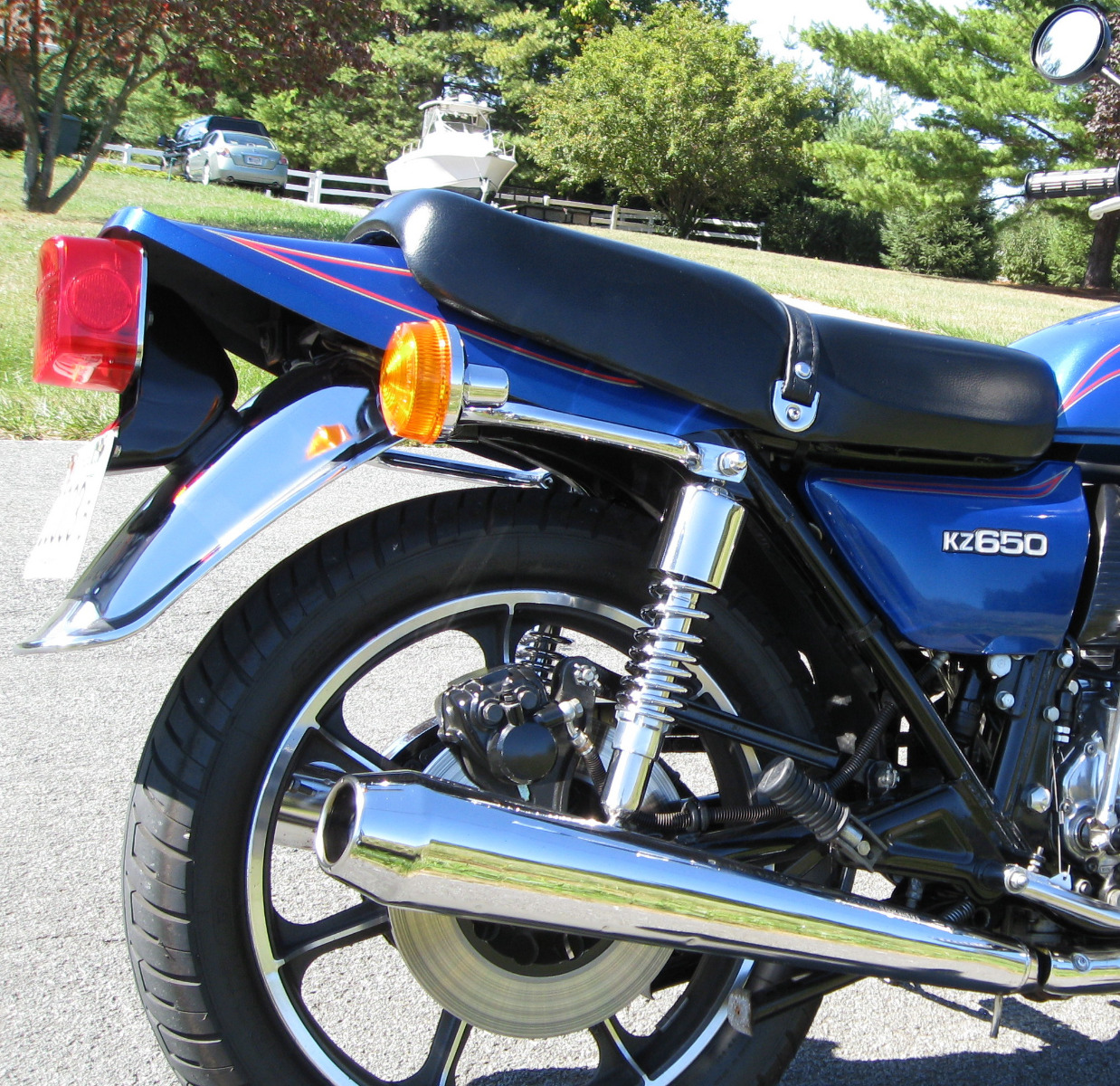

I've had Hagon shocks on my 1977 KZ650-C1 for 11 years (16,000+miles). They still work and look like new - I REALLY like them a lot! Ed

Thank you Martin and CSR. Your blue 650 looks beautiful!
