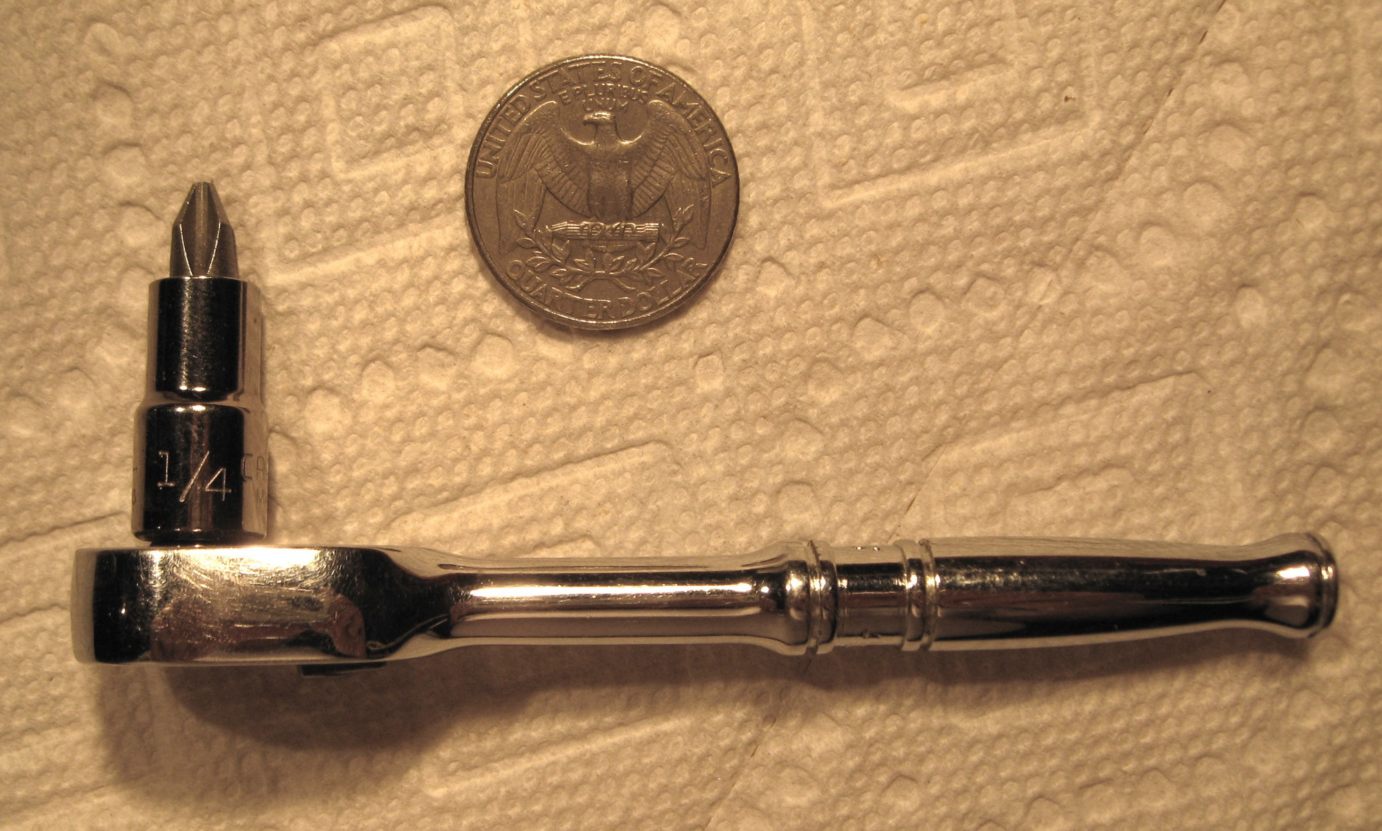

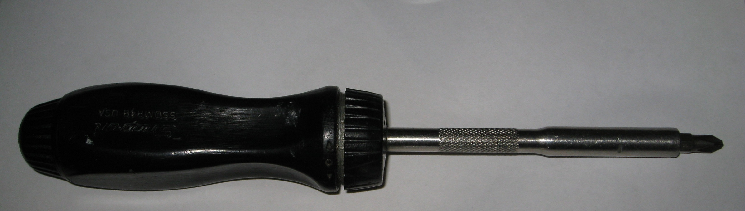

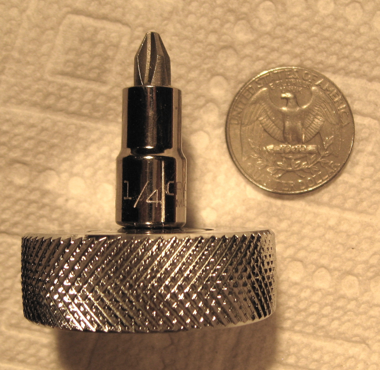

The JIS size I use the most is #3. It is used on the screws that fasten the engine cases to the engine. I also use the smaller size (#2 I think) to remove the screws that hold the carb bowls on the carbs. Rather than buying the JIS screwdrivers I bought the JIS screwdriver bits. I have a 1/4" Snap-on ratcheting screwdriver handle that I use the bits in when I want to use a handle (image below). One advantage of the bits over the screwdrivers is the fact that using a bit in a 1/4" socket (rather than a handle) I can easily remove the carb bowls with the carbs still mounted on the bike (images below). I bought my JIS bits years ago, so I can't remember where I got them, but the two links below show very similar bits. There may be other, better places to buy the bits. The ones I have are made by a company named "VESSEL. " Ed

Wow thanks for the links! I'll look into getting the bit type instead of the screwdrivers, I think they may be a bit more helpful. I appreciate all the info you've given me! $5 for three bits isn't a bad price, especially since I can't find any jis screwdrivers or bits locally.
