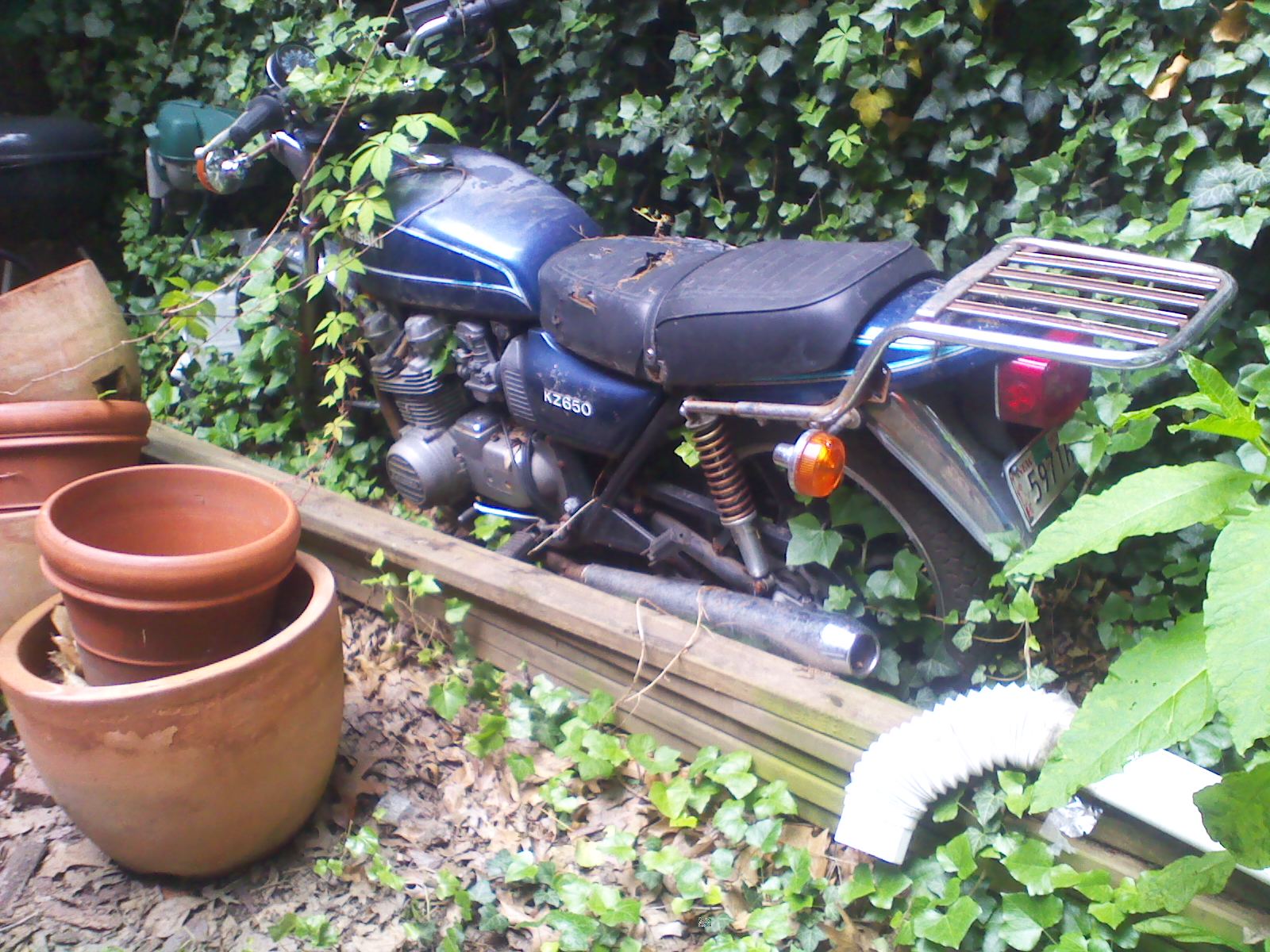

Found a way to save the pictures from the seller! This is the bike as advertised. I should be picking it up tomorrow.

WOW, that bike is pretty rough. It's going to be a ton of work, so it's good that you are rescuing it from the scrap heap. A freaking TITLE? That's rare, it's got to be a joke, or somebody filled it out, then never registered it. At least it's not as rough as this one.
This is a pic I took while doing a Job in St. Louis a few years ago. It had sat so long the wheels were almost up to the axles into the ground. I actually tried to buy this bike, planning on bringing it back to life.

The bike is certainly neglected. My short term goal is to get it running well enough to make the mile drive to work and back three days a week, and to of course take my motorcycle skills test.
I'm located in Las Vegas and I notice vehicles tend to not rust out here, so my hope is that the engine isn't seized from rust. Maybe my eyes are bad, but in the pictures I see very little if any rust. I was planning to pick it up today but seems ill have to wait until tomorrow.
Long term I want to restore the bike to a nice condition. I doubt I'll turn it into a show room condition bike, but it'll be nice to have it look pretty good.

The first thing I would do is hit (every) nut and bolt with some penetrating oil, including the spark plugs.
Before attempting to crank the engine the plugs should come out and I would squirt a bunch down each cylinder hole too.
Let the oil soak in a day before trying to turn anything, a second coat won't hurt either,
it also helps to give the bolts a few taps to help break the rust loose after spraying.

I would say to let the penetrant work for several days since it has been sitting outside. Reapply penetrant to each fastener once or twice a day. Tapping and heat will help stubborn ones. Some will need persuading with an impact driver.
Be mindful that all those cross head screws are NOT Phillps heads, they are JIS. A Phillips screwdriver comes to a much sharper point than a JIS, and can wreck the slots in a stubborn screw. Buy the proper tools, or modify Phillips drivers to fit snugly and you will have better results.
The most effective penetrants are -- a 1:1 mixture of acetone and ATF, Kano Kroil, and PB Blaster, in that order. Don't be afraid to use more than you think necessary of both penetrant and patience. Impatience often creates bigger problems.

This is a Las Vegas bike. I bought a car that sat in a yard for many years near Las Vegas. No rust, no problems starting up. He probably WILL NOT need all that penetrant stuff. Im sure he will be fine.
I definitely feel he should make sure the engine turns freely and add oil, etc, but all the "penetrant" overkill is a bit over the top.
