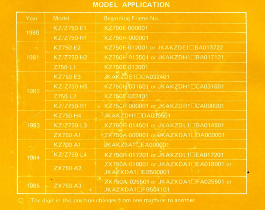

Through no fault of my own, I am in possession of a KZ750! I would like to determine the year of this bike. The label on the steering neck says: KZ750-002317 (photo attached). This number is also stamped into the neck. Am I looking in the correct place?

The photo didn't show up. Also I believe you left out part of the number that should be stamped on the steering neck. There should be a letter after "KZ750" such as the "E" in the example below. See if the number is in the following format:
KZ750E-000001

You are correct, of course!! I did omit the E in that number! It should read: KZ750E-002317.

Mine has a frame # KZ750E - 006XXX
You can find an pdf of the manual here www.kzrider.com/service-manuals
Select the 3rd one down. The GPz750. It covers your model

Thanks. Notice on the last page of Kawasaki Service Manual in the link below that the 1980 KZ750-E1 Frame numbers started with "KZ750E-000001" and the 1981 KZ750-E2 frame numbers started with KZ750E-012001. So it looks like your bike is a 1980 KZ750-E1 model. Ed
www.kzrider.com/modules/ServiceManuals/KZ750E1&H1.pdf
