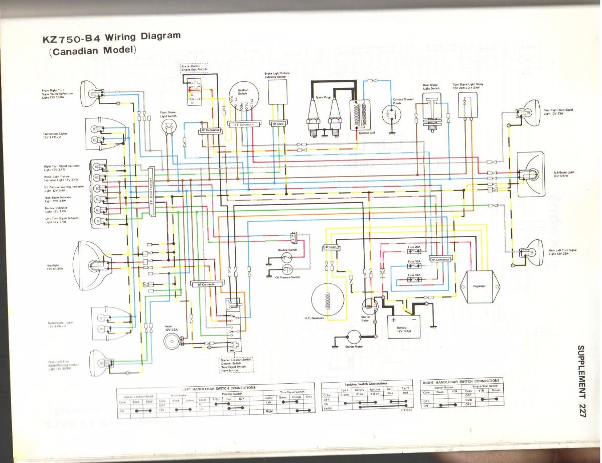

Welcome Leor13
Wire diagram
Aftermarket ignition switches may require rewire at plug to match the switch diagram at bottom of above sheet.
