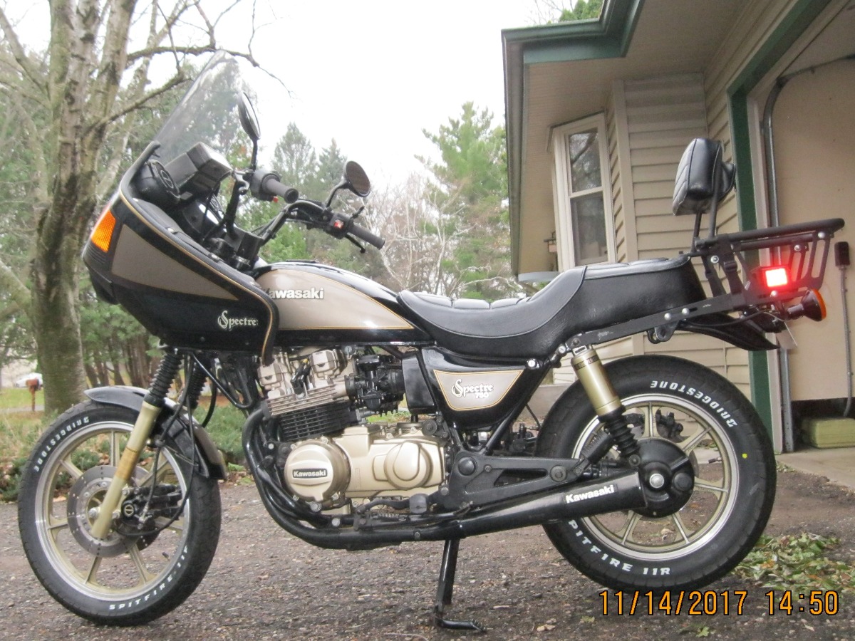

Hey look who's here, I see you found it, good luck getting it home.
Here's that Spectre I found last fall.
