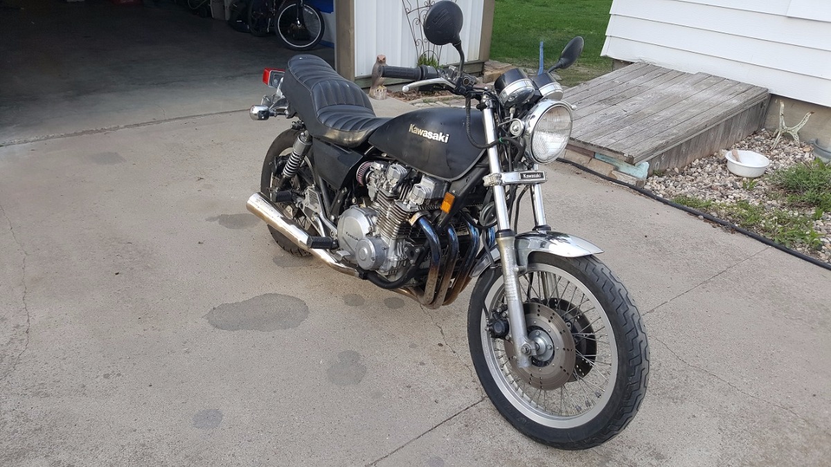

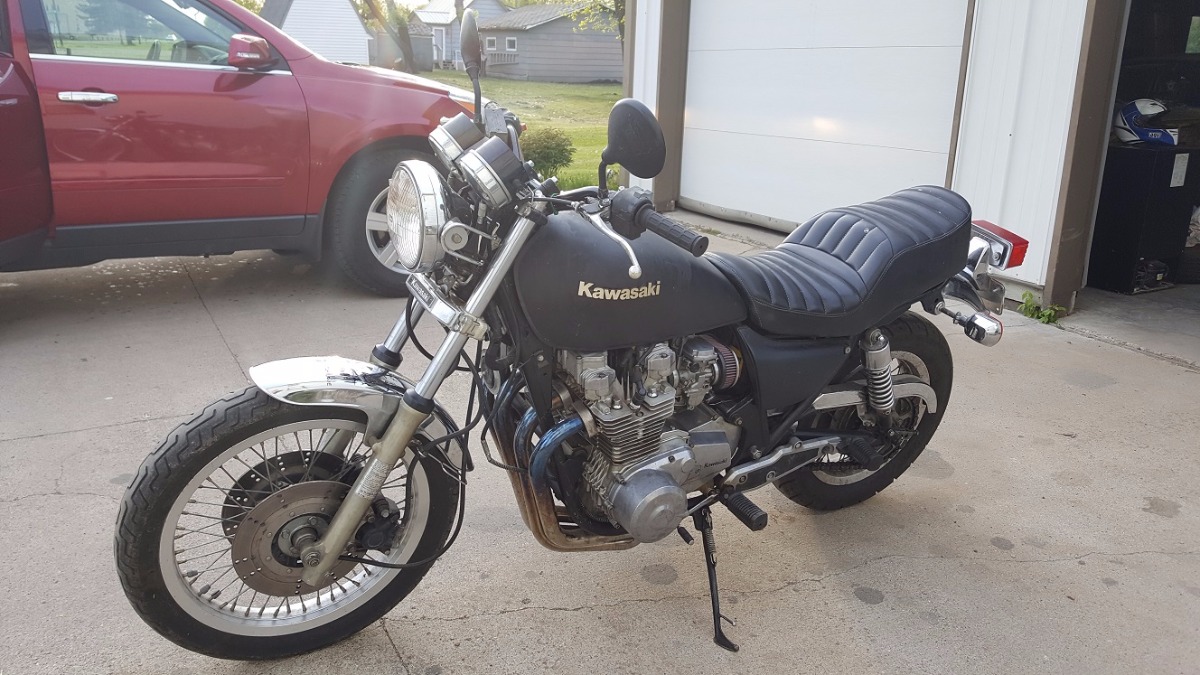

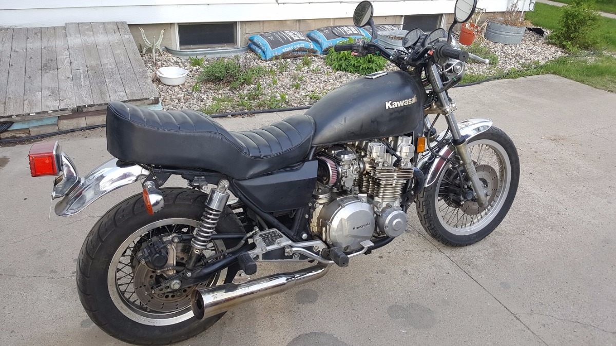

Hey all, just got the bike last weekend, thought I'd share some photos. It's in quite good condition (as far as I've looked at it), though it's not without its faults.
The Good: Pulls hard, no stumbling or bogging, no tears in seat, carbs supersonically cleaned, MAC 4 into 1, K&N 2 into 1 pods (not inherently good but easier to install on and access carbs obvs), frame is clean and straight, dials are in good condition, runs, drives, stops.
The Bad: I suspect it's running quite lean since it has the stock jets with an aftermarket muffler (that's very blued) and K&N pods (have not pulled and inspected spark plugs yet); there is a strange problem with the motor wanting to idle at 4k rpm, can get down to idle if I slow down and only pull the clutch as I get down to 1k rpm and stop, but a couple seconds later it revs up to 4k, have to modulate with clutch at a stop; knocking noise in starter clutch likely due to backed out screws; petcock doing nothing to stop the flow of gas (soaked petcock in gas for 24 hrs, bought new gaskets, will rebuild and document this weekend).
The Ugly: Thankfully, nothing yet!

Hey, not bad at all.
I've got an 81 CSR, but will be selling it soon - ish. Keeping the spokes for a future project (replaced w/ 81 LTD wheels before selling) as I like the way they look with the tank's shape. Rebuilding the engine before selling, as it always burned tons of oil since I've owned it. Took mine to the strip like that, and with 30,000 miles, a damp and cold day, a grabby clutch and shitty rear tire, ran best 12.67 @103 mph. Tied with a 2004 Yam. V-max up to the 1000' mark. Engine survived a few journeys to 10,500 RPM, crossing the line still in 3rd gear! Found it actually went quicker shifting at 8,500, though. Power drops off quick after that (mild stock cams). Not bad for a bike I paid $ 500.00 for!
BTW, I'd say the straight roads aren't as bad as the 5-6 months of bitterly cold winter...I'm about 2.5 hours north of you...
Need used parts? Try Sport Wheel in Minni...go and search the yard yourself is best . 6 acres! Bob's Cycle shack in GF - you have to ask him to see his off - site stash to actually find out what he has - he seems to be a little absent minded and overly optimistic when it comes to his actual inventory of parts bikes...
High Idle - replace the carb manifolds w/ new. Our extreme cold climate ruins them faster than most. Check the ign. advancer mech for free movement and rust and spray w/ rust protective oil
Good luck with your new to you KZ. I like my CSR - they are a fun bike. I'm selling it only because I just have too many, so sadly it must go...

BTW - I noticed someone has swapped out the engine side covers and ignition housing on yours - the originals were chrome plated...
