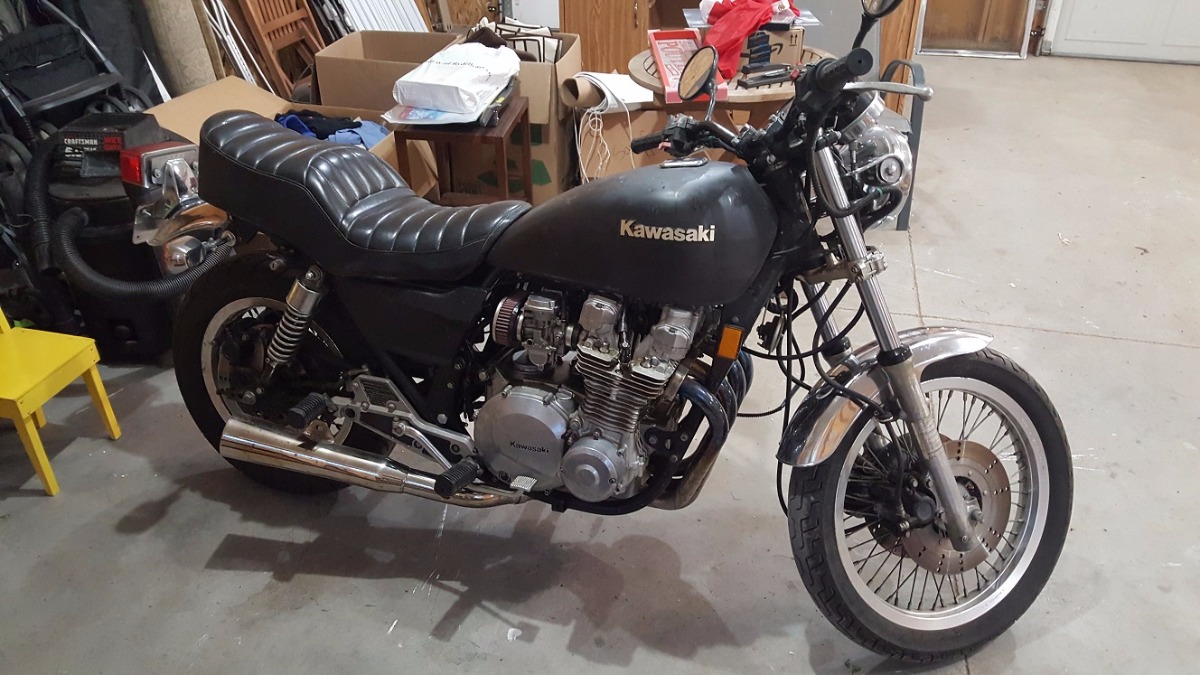

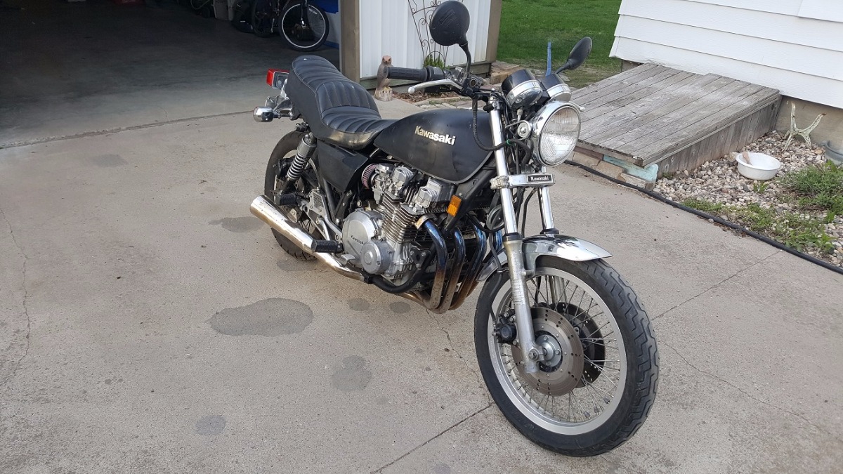

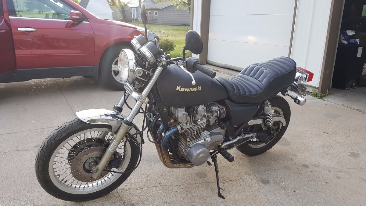

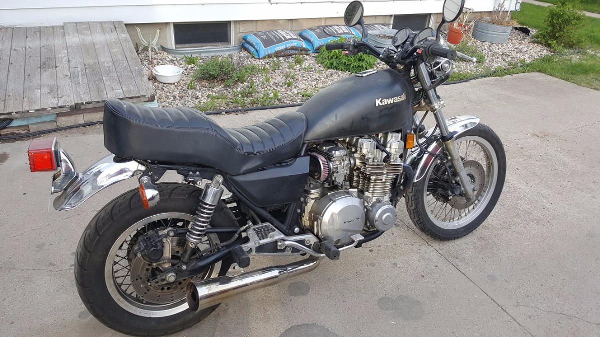

Hey all, just got the bike last weekend, thought I'd share some photos. It's in quite good condition (as far as I've looked at it), though it's not without its faults.
The Good: Pulls hard, no stumbling or bogging, no tears in seat, carbs supersonically cleaned, MAC 4 into 1, K&N 2 into 1 pods (not inherently good but easier to install on and access carbs obvs), frame is clean and straight, dials are in good condition, runs, drives, stops.
The Bad: I suspect it's running quite lean since it has the stock jets with an aftermarket muffler (that's very blued) and K&N pods (have not pulled and inspected spark plugs yet); there is a strange problem with the motor wanting to idle at 4k rpm, can get down to idle if I slow down and only pull the clutch as I get down to 1k rpm and stop, but a couple seconds later it revs up to 4k, have to modulate with clutch at a stop; knocking noise in starter clutch likely due to backed out screws; petcock doing nothing to stop the flow of gas (soaked petcock in gas for 24 hrs, bought new gaskets, will rebuild and document this weekend).
The Ugly: Thankfully, nothing yet!
Sent off the tank and side covers to get a nice shiny paint job, looking forward to how those turn out.

Hey, not bad at all.
I've got an 81 CSR, but will be selling it soon - ish. Keeping the spokes for a future project (replaced w/ 81 LTD wheels before selling) as I like the way they look with the tank's shape. Rebuilding the engine before selling, as it always burned tons of oil since I've owned it. Took mine to the strip like that, and with 30,000 miles, a damp and cold day, a grabby clutch and shitty rear tire, ran best 12.67 @103 mph. Tied with a 2004 Yam. V-max up to the 1000' mark. Engine survived a few journeys to 10,500 RPM, crossing the line still in 3rd gear! Found it actually went quicker shifting at 8,500, though. Power drops off quick after that (mild stock cams). Not bad for a bike I paid $ 500.00 for!
BTW, I'd say the straight roads aren't as bad as the 5-6 months of bitterly cold winter...I'm about 2.5 hours north of you...
Need used parts? Try Sport Wheel in Minni...go and search the yard yourself is best . 6 acres! Bob's Cycle shack in GF - you have to ask him to see his off - site stash to actually find out what he has - he seems to be a little absent minded and overly optimistic when it comes to his actual inventory of parts bikes...
High Idle - replace the carb manifolds w/ new. Our extreme cold climate ruins them faster than most. Check the ign. advancer mech for free movement and rust and spray w/ rust protective oil
Good luck with your new to you KZ. I like my CSR - they are a fun bike. I'm selling it only because I just have too many, so sadly it must go...

BTW - I noticed someone has swapped out the engine side covers and ignition housing on yours - the originals were chrome plated...

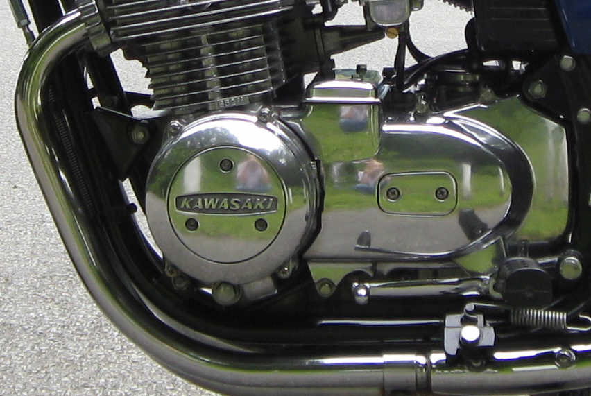

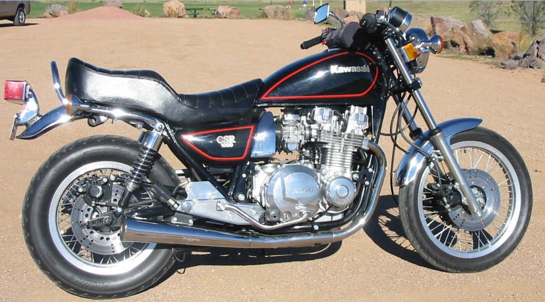

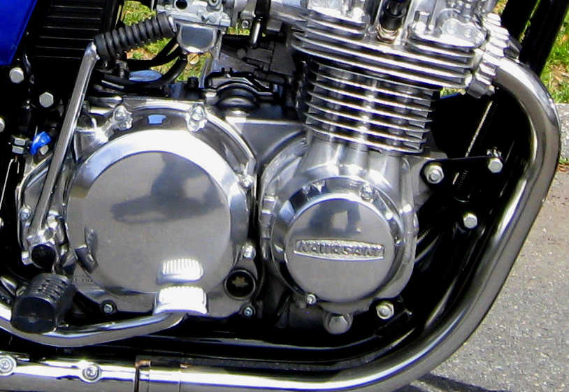

I don't think so. I believe you will find they were polished rather than plated. (Search eBay with "kz1000-csr" "engine" "side" "cover" for more examples). Polished covers can be pretty shiny. Ed

2.5 hours north, sooooo right smack dab in in Winnipeg. I take it back. YOU live in the worst place to own a motorcycle. Your riding season is the same length as mine, but you've got Winnipeg roads to contend with AND Manitoba insurance rates to pay. I'm from Winnipeg originally, and I've got some cousins up there who have Vstrom 650s. Manitoba motorcycle insurance rates are borderline criminal.
I just discovered the Cycle Shack and Bob's Cycle in town, have not gone there yet. As for Sport Wheel, I grew up 20 min north of there, used to go there occasionally with my dad to find stuff for his old Honda CBs. I'll go there when eBay, Amazon, and Z1enterprises shut down and I win the lottery...maybe. They have lots of stuff if you're willing to pay the price.
I'll be ordering new carb holders as soon as i have a few extra bucks to toss at the bike, along with a Dynojet stage 3 carb kit. Didn't think of the ign adv so thanks for that tip.
As for your $500 purchase, always nice to get a sweet deal for a sweet ride. I got mine for $300!

Ed - my original 1981 KZ1000M covers are chrome, and I had an article from a 1982 Cycle magazine showing they were chrome, also. The service manual pictures look like chrome. Just on the 1000CSR, but definitely chrome...not polished. I have removed and stored those covers, and am keeping them for use on my new beater's mongrel engine. Two years ago a pair of parts only 1000's were sold by a guy up here, an LTD and a CSR. The CSR were chrome, the LTD were polished...I have two parts LTD's as well as the CSR.
The ignition housing and cover, alternator, and clutch covers. All are chrome, and definitely factory (haven't chipped, peeled, or show nickel shadowing).

Here, this is the issue of Cycle...
www.dadsvintageads.com/catalog.php/dadsv..._Magazine_Back_Issue
At the start of a road trip in fall 1983, I bought my copy in...Grand Forks!

Thanks for the information. I didn't know Ma Kaw chromed any engine pieces other than the starter cover. Ed
