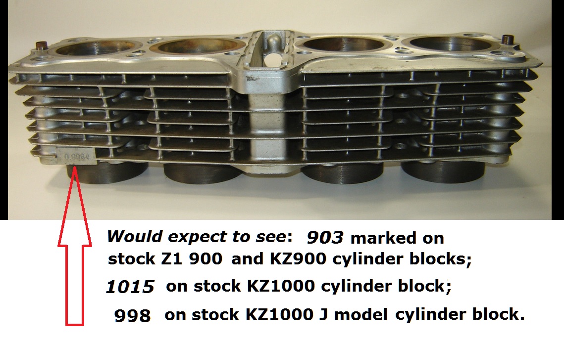

22 Jul 2016 09:15swest wrote: Can't see the numbers. On the bottom front of the barrels it should say 903 cc.
Hey Steve, I have my carbs off the engine to some, they really needed it!!! But for the life of me can't find cc stamp by the intakes. Do you happen to have an example? Thank you sir!
77 kz1000 with a Z1-KZ900 motor
Re: Quick introduction
22 Jul 2016 10:02
No on the front under the # 4 exhaust next to the case.

22 Jul 2016 10:34 - 22 Jul 2016 10:36A J model cylinder block is pictured, which is visually similar to Z1 and KZ900 and KZ1000 cylinder blocks.

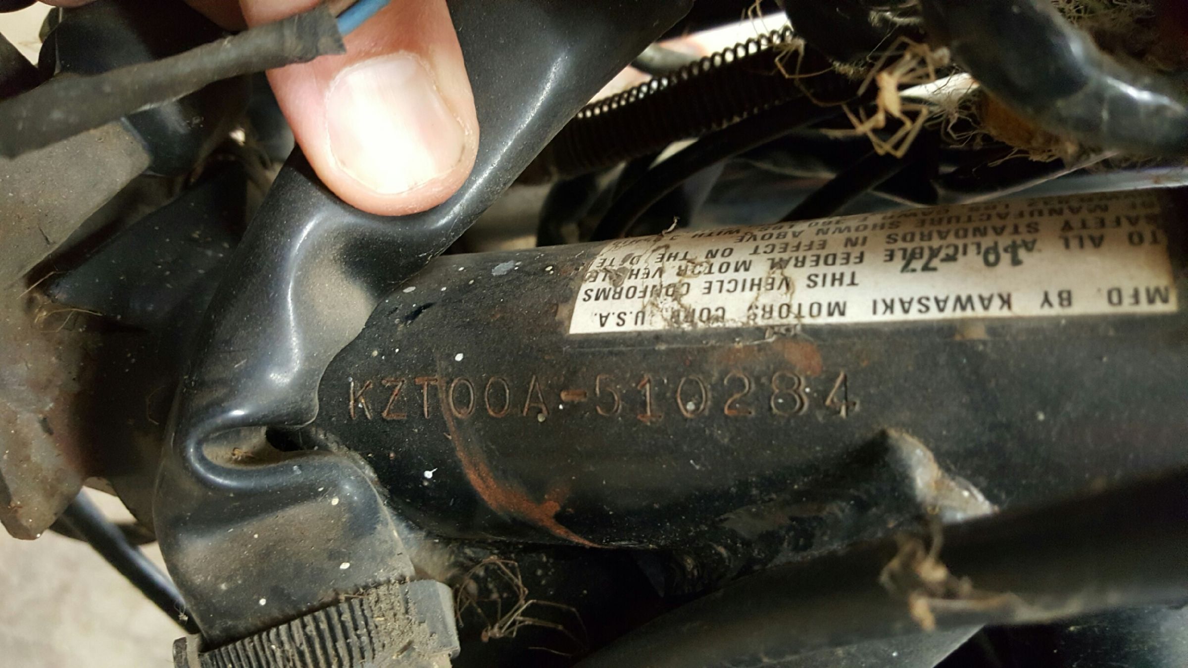

22 Jul 2016 10:52 - 22 Jul 2016 11:18CoxUSMC wrote: Another question: I was told it is an 1980 Ltd, but from the wiring and the frame I'm pretty sure it is a '77. How can I know 100% since it doesn't have a "full" VIN?
KZT00A-510284 probably is the "full" VIN.
Per www.zedder.com :
Year & Model '78 KZ1000-A2
(USA MFR)
KZTOOA507027 - 515034
Engine No. Range KZTOOAE042501 - 058140
Engine No. Location RH top crankcase, below carburetor
Cylinder Mark 1.015L
Cylinder Mark Location Front RH corner
KZT00A-510284 falls within the USA manufactured '78 KZ1000-A2 models which have VIN's ranging from KZTOOA507027 - 515034

For comparison, here's the 1980 LTD info from zedder:
Year & Model '80 KZ1000-B4:LTD
Frame No. Range KZTOOB-523544 - 535555
Engine No. Range KZTOOAE092601 - 092900 AND KZTOOAE093001 - 110764

22 Jul 2016 11:17 - 22 Jul 2016 11:31CoxUSMC wrote: The man who parked it told me he put a 900 bored over put in and the 1st 3 on the engine are Z1E
Would seem to be a '78 KZ1000-A2 chassis with an engine from some other model (Z1-KZ900) to be more precisely determined by the complete ENGINE serial number.
But, regardless of the ENGINE serial number, it's also possible that a KZ1000 cylinder block from a later model was installed onto whatever the 903cc engine started out as.
For example -- Z1 engine with KZ1000 cylinder block in a 1978 KZ1000 chassis.

It does indeed have a 903 on it, thank yall for helping me confirm that!

22 Jul 2016 11:41 - 23 Jul 2016 09:40CoxUSMC wrote: It does indeed have a 903 on it, thank yall for helping me confirm that!
That narrows it down to a '78 KZ1000-A2 chassis with an engine from some other model (Z1-KZ900) to be more precisely determined by the complete ENGINE serial number.
