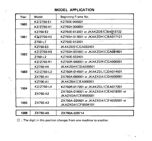

Welcome Bobcat
You can identify which model you have from the frame number using the following table taken from the back cover of the Kawasaki shop manual.
If you buy a manual on ebay make sure your model is covered.
You can find a pretty decent pdf copy here
www.750turbo.com/manuals/
Scroll down and select GPz750 Base Manual
Good Luck
