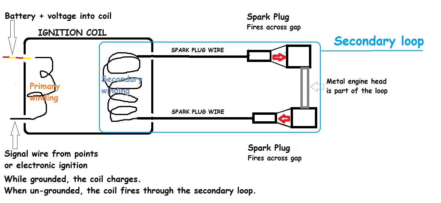

Would first check -- with ignition switched ON, is full battery voltage being received at the ignition coil primary terminal (where likely a red or red/yellow wire feeds into the coil)?
