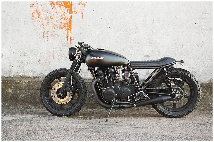

Hi, I've always liked the cafe racer style myself. I'm wondering about going that route with my kz650, something like in the picture but probably cheaper as it looks beyond my budget.
I'd agree with 650ed, unless you plan to race on a track why spoil the classic look?
Keep us posted on how you get on please.

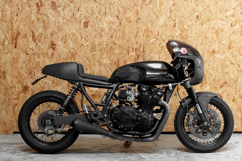

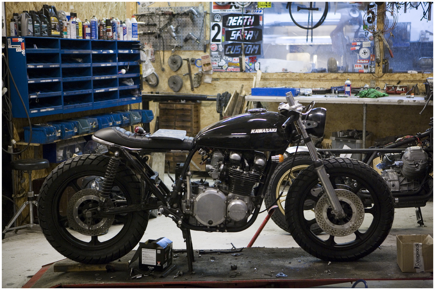

The bikes in all three pictures look great.
I really like the tires on the first one. What kind are they and what size?
The wheels and swing arm look great on the 3rd picture. Did you take it from a Z1R?
Thank you for the help!

i believe this is the finished version,
www.wrenchmonkees.com/motorcycles/monkee-626.html
of this bike
in which case they list the tires as,
Pirelli tires - rear 140/80 x 18 and front 120/80 x 18.
hth,
of this bike
hth,

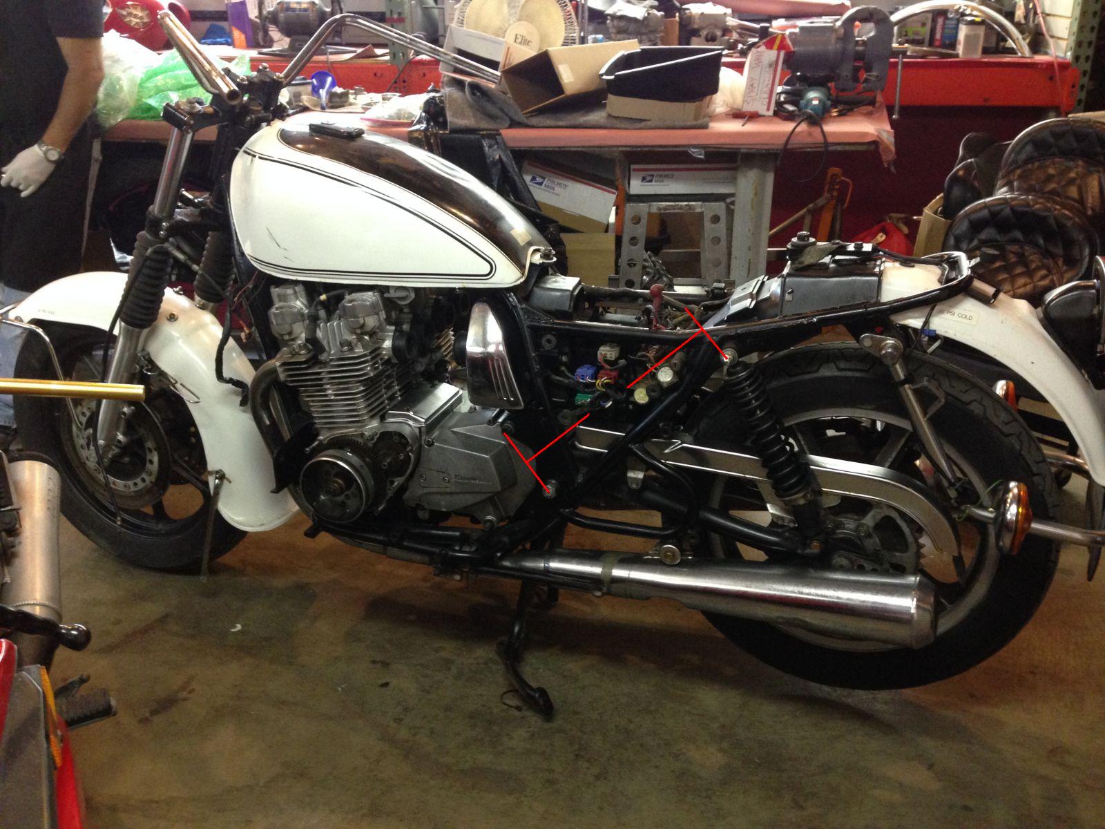

My two bikes; the original and the parts bike I'll turn into my Vintage Bike
Last edit: 03 Oct 2013 00:52 by Brasilcat.
- Posts: 7442
Re: Building my first Vintage bike385
03 Oct 2013 10:13
the original bike looks very nice
the other bike looks like THE PERFECT platform for your "vintage bike" :evil: .
is there any way i could get you to measure from the swingarm pivot bolt to the top shock stud center to center?
