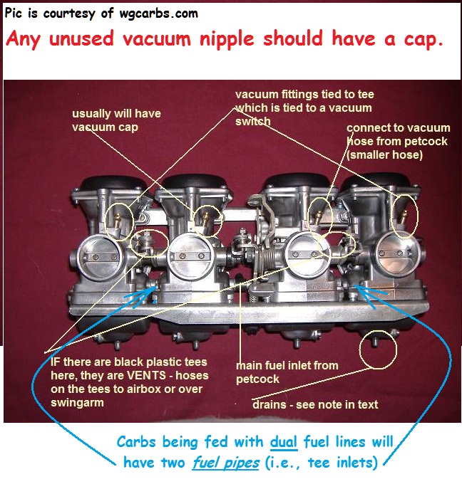

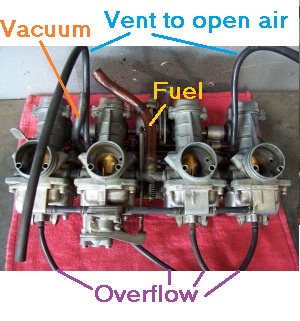

01 Apr 2013 13:39 - 02 Apr 2013 02:35Some carbs have a dedicated vacuum nipple for the tube supplying vacuum to a vacuum operated petcock.bleedgreen1990 wrote: the title says kz1000j... the carbs that are on it dont have any vacuum lines. other than the plugged off ports you would use to synch them with.. i would have to go out and look at the brand they are i think it starts with an "s". i believe the motor was put in in 2012 thats why i am unsure which it is.
On models equipped with a vacuum operated petcock and carbs without such dedicated vacuum nipple, one of the carb holder nipples is generally used for the tube supplying vacuum to the vacuum operated petcock.
Examples of carbs with dedicated vacuum nipple for vacuum operated petcock, manual slide and CV carbs:

sooo what year of bike are my carbs off of being that they are the "cv" carbs... and the vaccuum ports are plugged im 99.9 percent sure
