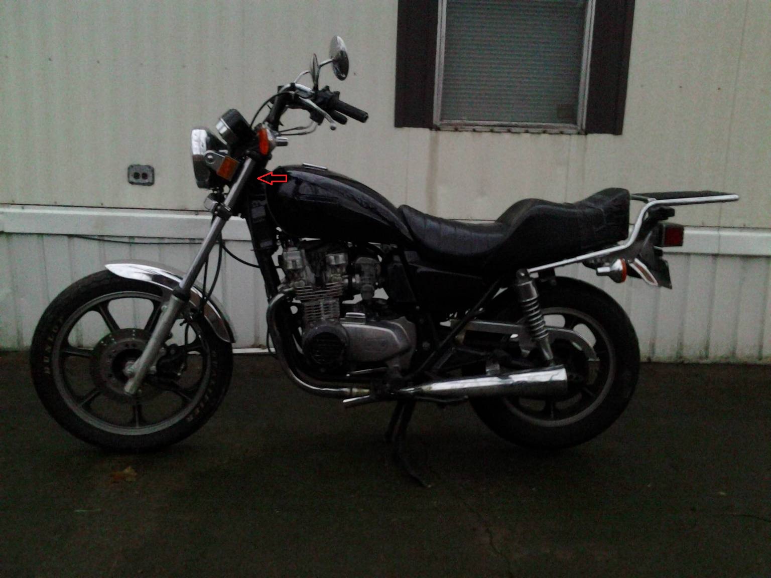

Hello, new member here.
1982 KZ550 20,000 miles, purchased 12/8/2012.
The seller said it's an LTD and I believe it to be one as well but cyclechaos says the KZ550 LTD was 1980-1981.
It is extremely hard to start and won't idle under 1500 RPM. Above that it runs fantastic. The trans shifts great, clutch is very easy to engage, and neutral is very easy to find.
I need a seat, exhaust system, front brakes and a front tire. A carb sync would do a lot of good as well.
Look foreword to being part of the community.

A fresh set of sparkplugs, properly gapped will make starting easier. If the ignition coils, sparkplug wires & sparkplug caps are original to the bike the bike, you should think about replacing them. Even when new, the ignition coils were marginal.

Definitely a C model LTD. Check my signature for carb info. If you are missing choke flaps, that would explain the hard starting. You can check for choke flaps without removing the carbs. They come out through the top caps, but then when you put them back in, you have to make sure to line them all up which is takes a little fiddling.
Also, there are several manuals in my signature which you should save to your computer.
